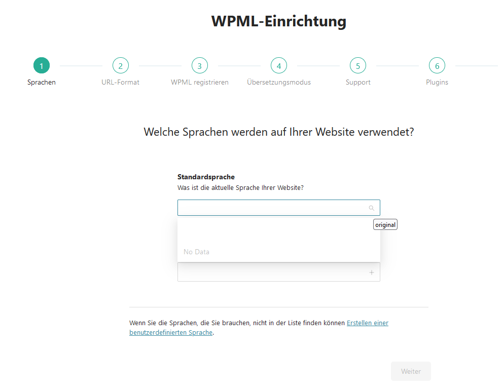

guentherU
I just have installed WPML and try to first set up WPML but on the first page where I should set up the default language and translations languages I have no language in the lists.
I tried to reset as suggested but always the same.
I installed WPML so many times but never had this problem.
Thank you for your help!
Günther

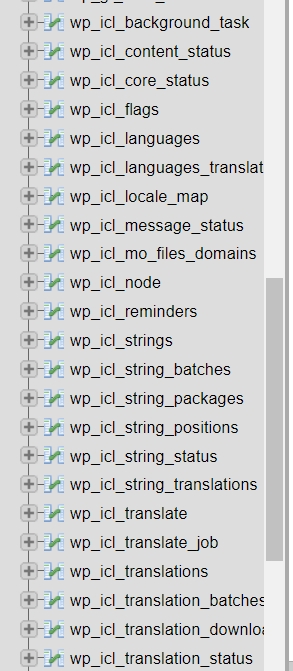

After you reset WPML (so like this https://wpml.org/documentation/getting-started-guide/language-setup/deleting-languages-and-plugin-data-by-doing-a-wpml-reset-on-your-site/#step-3-do-the-wpml-reset), do you still see these tables in your database?
Because if these are still there, it may indicate that your database user has no privileges to drop them or even to insert data.
Bruno Kos

thank you for your reply. If I reset WPML with the above funktion the tables are dropped.
And if I reinstall WPML they are agian there but it looks like they are all empty..

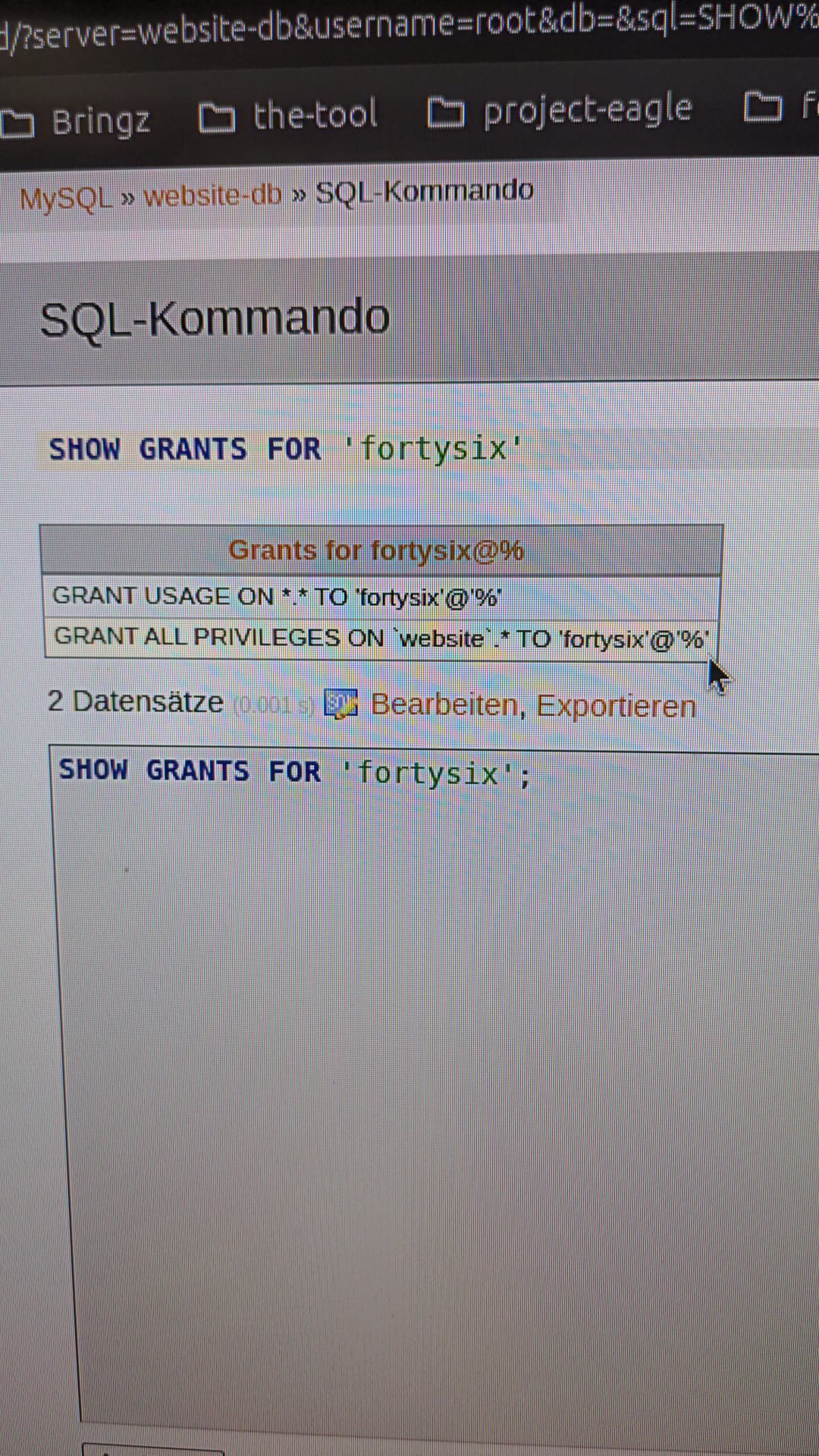

See also the db-user grants attached.
Thanks for any help
Günther
