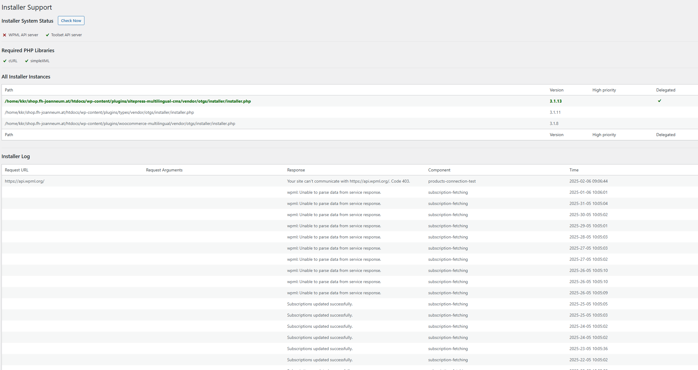

Sie können Ihre Shop-Seite nicht aktualisieren oder registrieren, da Ihre Website nicht mit https://api.wpml.org/ kommunizieren kann und ein 403-Fehlercode angezeigt wird.
Folgen Sie diesen Schritten, um das Problem zu beheben:

Juni 2, 2025 um 9:35 #17097231

Juni 3, 2025 um 10:42 #17101818
Noman
It looks like the blockage has been cleared on your site. Please follow the steps below and see if the issue is resolved:
1. Please login to your WPML.org account >> Go to the Sites page: https://wpml.org/account/sites/
2. Delete the existing site key.
3. Please login to your site and go to the Dashboard >> Plugins >> Add new > Commercial tab and click the Unregister WPML from this site link if that link exists.
4. Then please click the Register WPML link.
5. Click the Get a key for this site link.
6. It will generate the Key for your site.
7. Copy the key, and paste it back into the input box, and press the Register button.
If the issue persists, Could you please contact the hosting service provider and ask them to whitelist the URLs below:
- wpml.org
- cdn.wpml.org
- api.wpml.org
- api.toolset.com
- cloudfront.net
And after that try to register WPML on your site and see if this resolves the problem.
Here is a doc for more details:
https://wpml.org/faq/wpml-plugin-cannot-connect-to-wpml-org/
Thank you

Juni 4, 2025 um 6:55 #17104597
einkaufZ
Hey Noman!
Thank you, it works again now.
