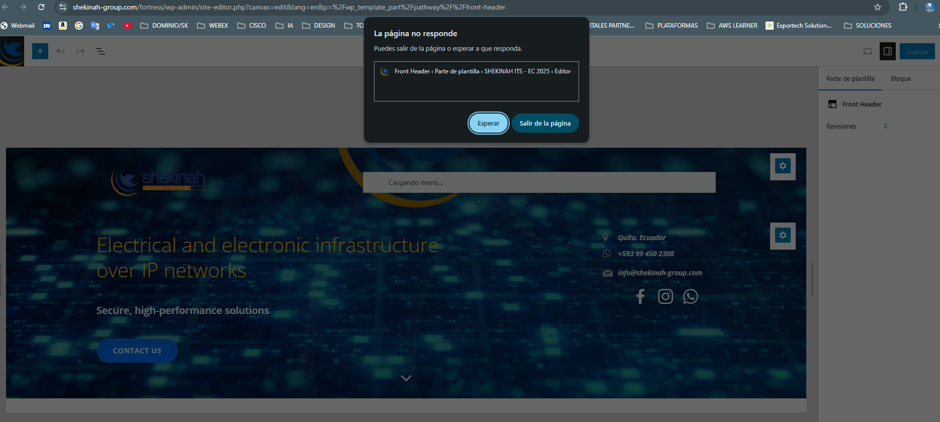

Síntomas:
En el caso del Header, la pagina se congela y no me permite hacer cambios, y para el Footer, puedo hacer cambios pero no me permite guardar estos cambios y solo me aparece el mensaje: Ha fallado la actualización. Las respuesta no es una respuesta JSON válida.

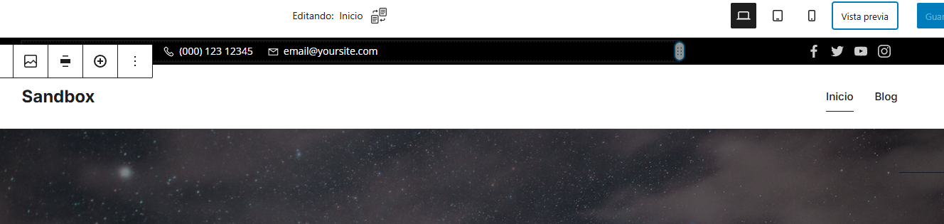

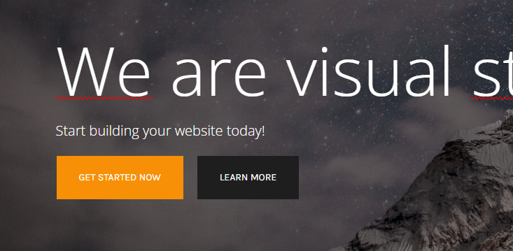

agosto 25, 2025 a las 6:02 pm #17346102
rodrigoN-4
Ok, I accessed enlace oculto
I installed Kubio, the Pathway theme, and in the image I'm sharing, the "Get Started Now" button includes the link to go from the Home page to the Blog page, which already works.
I wanted to automatically translate it to simulate the rest, but it notifies me that it needs credits.
Please help me generate that part so I can continue with the simulation.
The idea would be that if the page is in English, the internal link in the button doesn't go to the Spanish page; it should go to the English version, not back to Spanish.

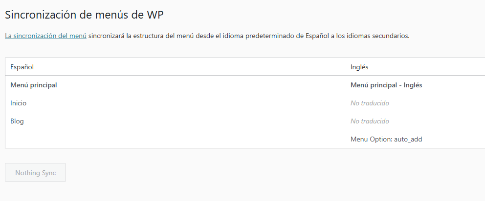

agosto 25, 2025 a las 6:48 pm #17346191
rodrigoN-4
It doesn't allow me to synchronize the menus

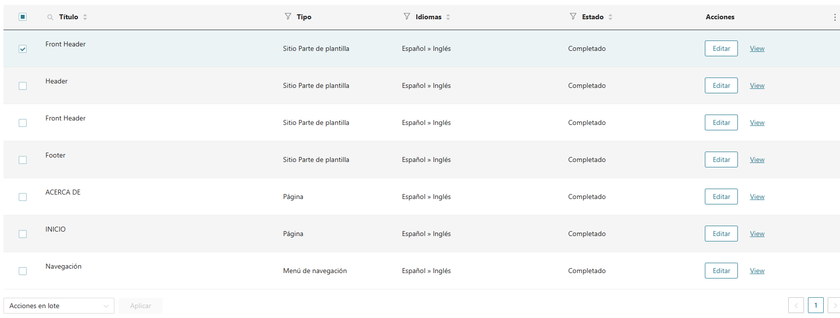

agosto 25, 2025 a las 7:51 pm #17346268
rodrigoN-4
Perfect, thanks for the instructions.
When I checked our shekinah-group.com/fortress portal, I found that I have a duplicate front-end header in the translations.
Could that be the cause, or one of the causes, of the problem?
I followed the steps in the video, and it shows that the translations are complete, so it should work. However, when I check my website, the button to keep the page in English still doesn't work.

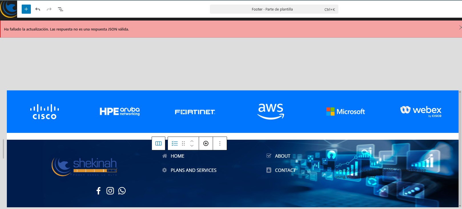

Now, we just need to fix the footer issue, which doesn't allow editing.
When you go to edit in the Footer template section, the button named "Inicio" has the automatic translation "Beginning," and we want to correct this and change it to "Home."
The page does allow editing, but when I save it, I get the notification: Update failed. The response is not a valid JSON response. (I've attached a screenshot.) With this problem, the changes aren't saved.
We need to fix this so we can save changes for this occasion and as many times as we need.
