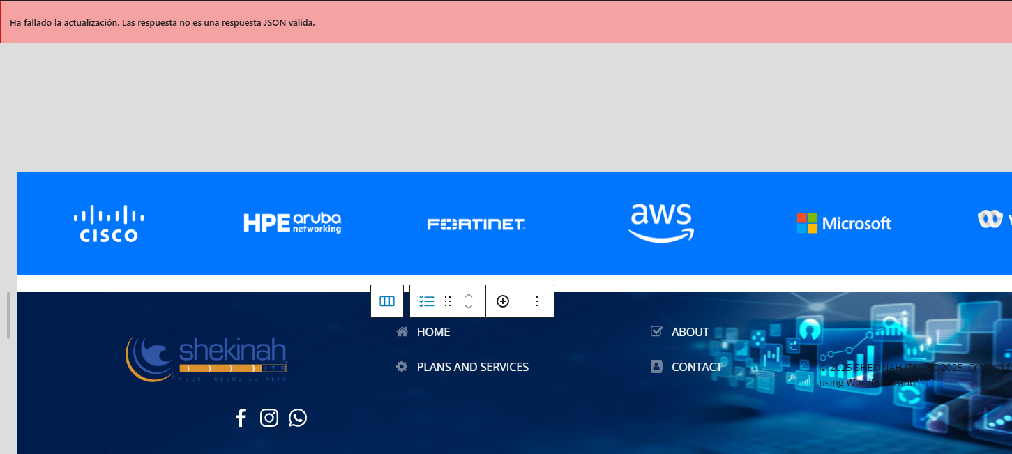

When you go to edit in the Footer template section, the button named "Inicio" has the automatic translation "Beginning," and we want to correct this and change it to "Home."
The page does allow editing, but when I save it, I get the notification: Update failed. The response is not a valid JSON response. (I've attached a screenshot.) With this problem, the changes aren't saved.
We need to fix this so we can save changes for this occasion and as many times as we need.
