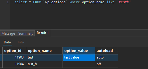

I am trying to manage multilingual options on my website, which has English (EN) as the default language and French (FR) as the secondary language. I created an option using update_option('test', 'test value') and made it multilingual with do_action('wpml_multilingual_options', 'test'). When I update the option with a different value for FR, it works as expected. However, if I update the option with the same value as EN, the FR option becomes empty due to line 126 in class-wpml-multilingual-options.php.
Symptômes:
When updating the option with the same value as the original language, the FR option in the database becomes empty: option_name = test_fr, option_value = ''.

In my case the option is not deleted. Here's is a simple script :
update_option('test', 'test value'); // EN
do_action( 'wpml_switch_language', 'fr' ); // Switch to FR
do_action( 'wpml_multilingual_options', 'test' ); // Enable FR
update_option('test', 'test value'); // Save FR
I end up with an FR empty line in DB. Then when I try get_option('test'), I get an empty value back.

I'm already using #2 as you can see from the code. Only it doesn't behave the way Ilyes describe, instead of avoiding the duplication in the database it does create another empty line, which will return an empty value on query of course.
I made another WPML_Multilingual_Options class which handles things the way they should. I'm confused about why I'm the only one having this problem, definitely not related to other plugins (I tested on a fresh install without plugins other than WPML), but it works now.
