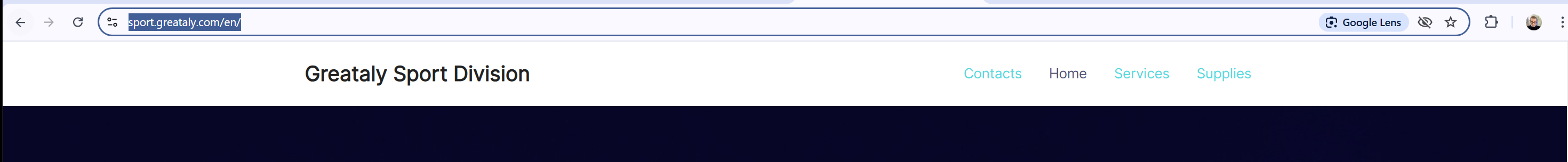

Novembre 6, 2024 alle 14:38 #16372585
riccardoL-8
Contesto del problema:
Sto cercando di far comparire due header diversi nelle versioni inglese e italiano del sito link nascosto.
Sintomi:
Il header non compare correttamente nella versione inglese.
Domande:
Potete fornirmi supporto su come far comparire correttamente i due header nelle due versioni?

Hello There!
To reduce the waiting time, I took this ticket and responded in English. Please let me know if you're okay with it or if you want to continue the conversation in Italian language. I will check and forward this ticket to one of our Italian-speaking supporters to assist you in the Italian language.
I understand the issue you’re experiencing. Upon reviewing, I found that the header has been created using the "Elementor Header & Footer Builder." Since you want to display a different header in another language, you'll need to manually translate the header template and properly adjust the display conditions for that template.
To understand the process of translating a header template created with the Elementor Header & Footer Builder plugin, please refer to this guide: link nascosto
Instead of using the Advanced Translation Editor for this template, you’ll need to follow the manual translation approach outlined in this guide: https://wpml.org/documentation/translating-your-contents/using-different-translation-editors-for-different-pages/
Once the template is translated, make sure that the display condition is adjusted correctly for the template.
Please try and let me know how it goes. I'll be happy to help if you need further aassistance in this matter.
Prosenjit
Novembre 7, 2024 alle 15:43 #16378878
riccardoL-8
Thank you very much! I have used the manual WP editor for the header and footer and everything works fine.
