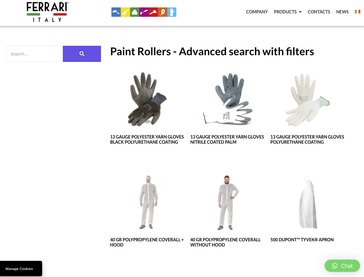

Nel sito che sto traducendo con wpml, ho utilizzato ACF pro per implementare dei campi personalizzati nei prodotti woocommerce. I valori dei campi personalizzati sono già stati tradotti da noi, e i prodotti risultano correttamente tradotti.
Ma quando visualizzo i set di filtri con Filter Everything PRO nella shop page che utilizza questi campi personalizzati per filtrare, i valori non risultato tradotti.
Il problema si verifica in questa pagina:
link nascosto

I followed the guide he suggested, but I didn't solve it.
When I select that filter sets entry and make it translatable, the filters in the English version of the site disappear:
link nascosto

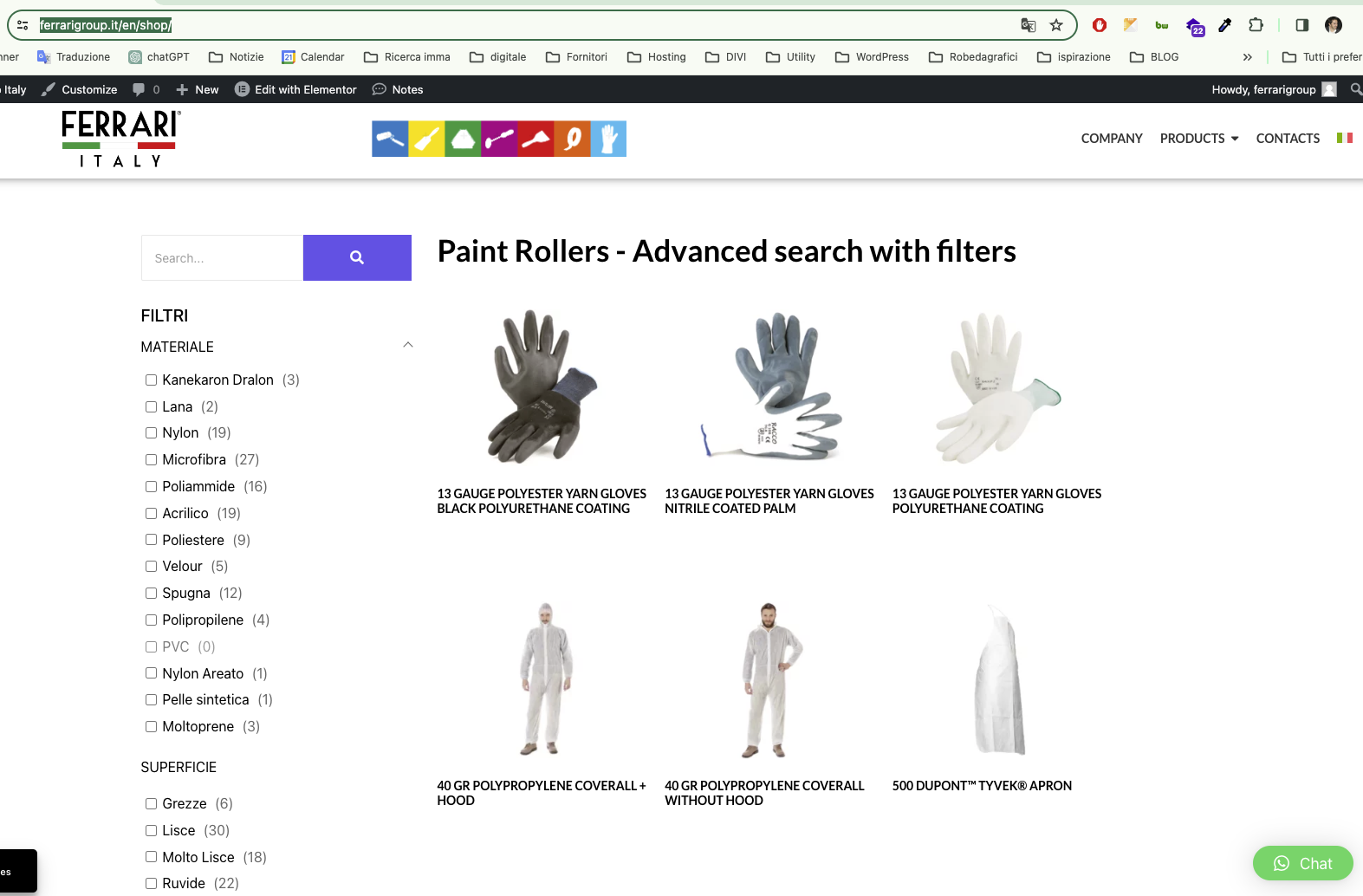

I followed the guide you provided, translated the filters, but I don't know why they still don't appear.
The values assigned to custom fields created with ACF pro do not appear.

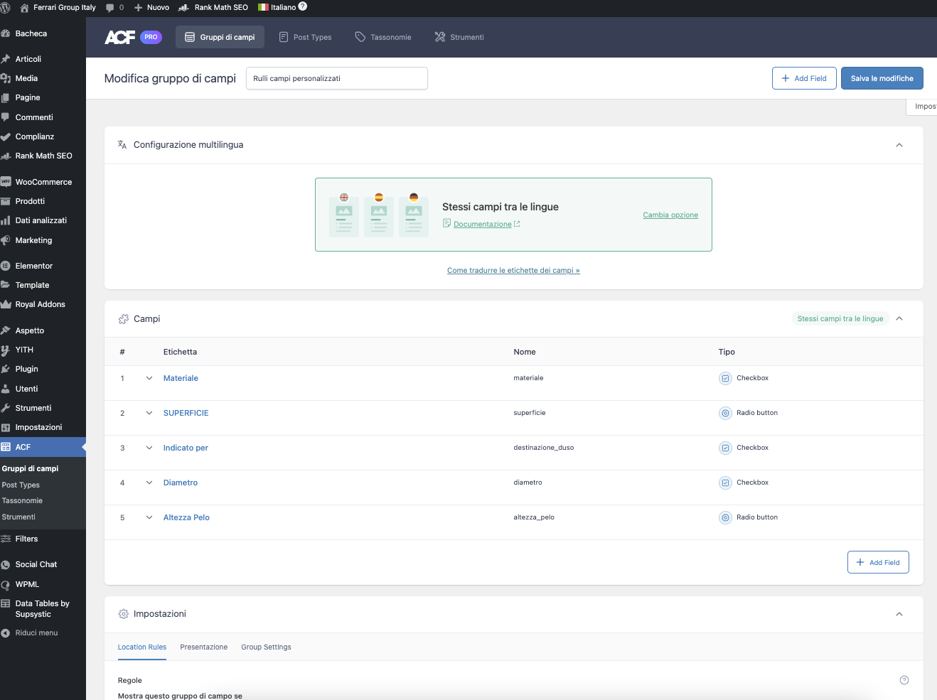

I checked in ACF Pro to see if the custom fields in Italian also exist in English, the word "multilingual configuration" appears but I don't see any fields. I chose "Same fields between languages", but I don't understand if I have to recreate all the fields again, which I have already done in Italian or if the string translation of the values inserted in the various fields that I have already done previously is enough.
I translated the filters following the guide (see screenshot) perhaps the problem is correctly assigning the ACF custom fields to the English version? What should I do?

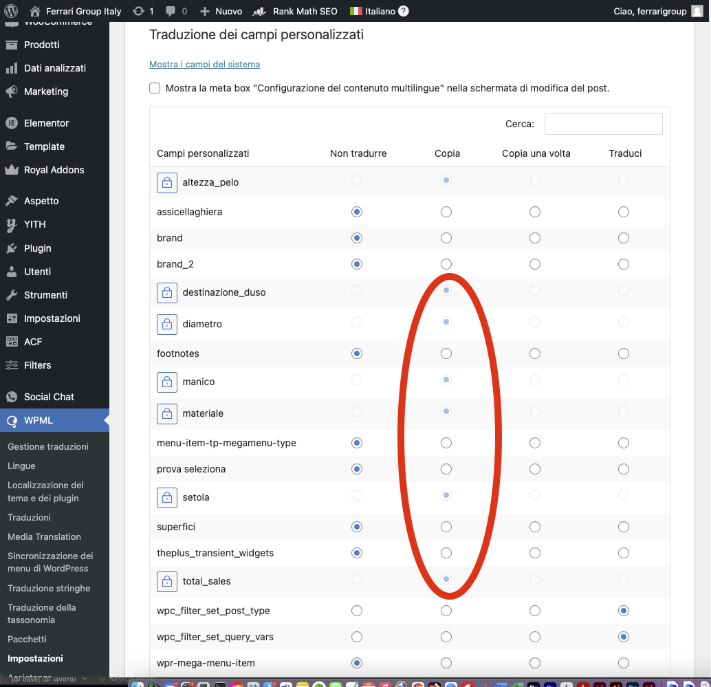

I understand that the values inserted within the custom fields aren't showing in the English version. As far as I know, we have only adjusted the Translation preference for the "Field-sets" post type within the "Filter Everything PRO" plugin. This modification should not impact the custom fields in any way.
Please go to "WPML > Settings", scroll down to the "Custom Field Translation" section, and make sure that the translation preference for the fields where you're having the issue is set to "Translate". From the WPML Debug Information, I can see that the translation preference for most of the fields is set to either "Copy" or "Not Translatable". I hope after adjusting the translation preference, the issue will be resolved.
For more information on changing translation preference, please check this guide: https://wpml.org/documentation/getting-started-guide/translating-custom-fields/
After adjusting the translation preference for the fields, you will need to resend the products for translation. Just make a small change in the title of the product and save the changes. It will trigger an update and by clicking on the Translation update icon, please complete the translation update.

I don't have permission to change the value of those fields, I see that it is set to copy, but I can't change it to translate
I am attaching debug information again, I would not like to have touched other settings useful for this purpose.

If they are ACF fields, you can directly modify the Translation preference within the ACF Field Group itself. However, it's necessary to first switch the Translation mode of the field group to "Expert." Once this is done, you'll be able to update the translation preference. Follow these steps:
1. Go to "ACF → Field Groups" and select the Field Group that contains the field you wish to modify.
2. Look for an option at the top to change the Translation mode and click the "Change Option" link.
3. From the choices presented, select "Expert" mode.
4. With "Expert" mode activated, navigate to the specific field whose translation setting you want to adjust to "Translate."
5. Update the translation Preference for this field and ensure to save the changes you've made.

Good morning, I followed your instructions, now the "Handle" custom field has been translated and appears in English,
however, the custom "Dial" field in English no longer appears (it exists in Italian).
Another problem, the English text field previously inserted in the short description of the product (a link to a table) is no longer shown, the Italian text still appears.
