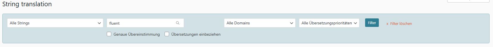

jensS-38
BTW: I guess the search box is missing here.

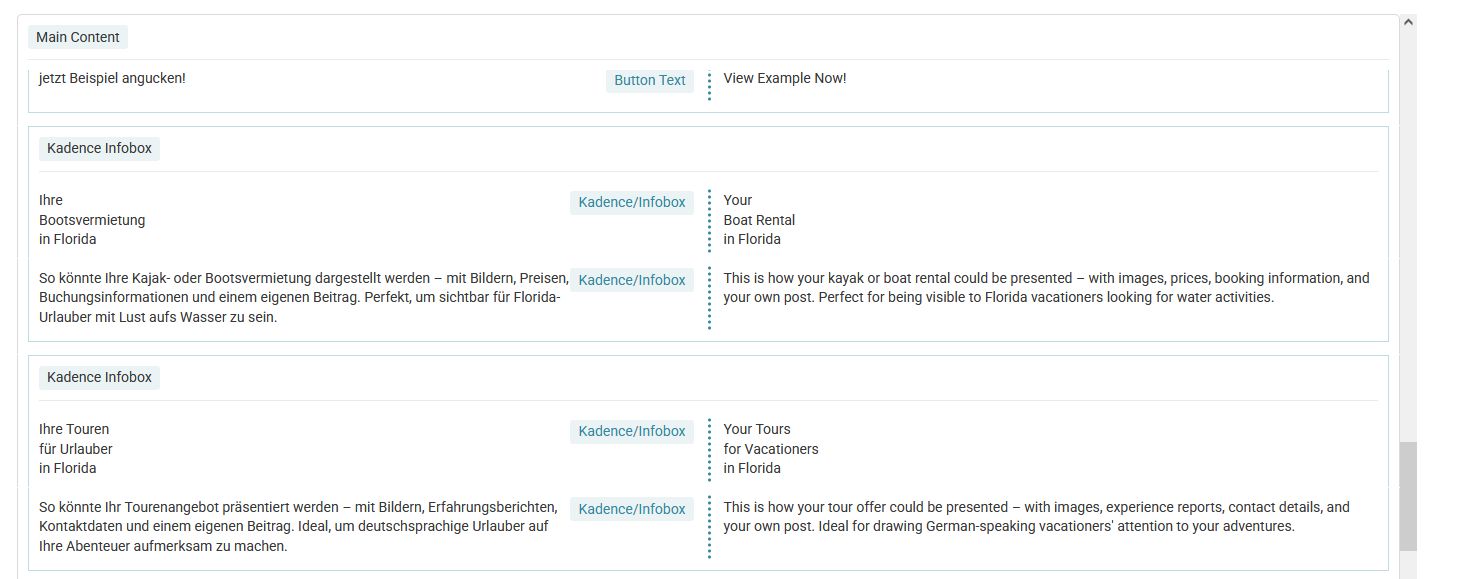

Juni 5, 2025 unter 7:21 p.m. #17112046
jensS-38
I noticed that Kadence blocks like the kb-infobox are partially picked up by the Advanced Translation Editor.
In my case, the actual CTA button inside the infobox (e.g. "Jetzt BUCHEN!") is missing in the editor, even though other Kadence content is being translated.
Can you confirm if full support for internal content of Kadence InfoBox/CTA blocks (especially buttons) is implemented?
Or is there a recommended workaround to make such button labels translatable via ATE?
Link to this URL: versteckter Link

2. BTW: I guess the search box is missing here.
The search box is precisely the field that contains "fluent". It's the field where you input the text, or part of the text, you want to look for.

to 1. O.K. just "normal" things to speed up the site
to 2. yep. Got it. Maybe the UI is not really perfect for me...
