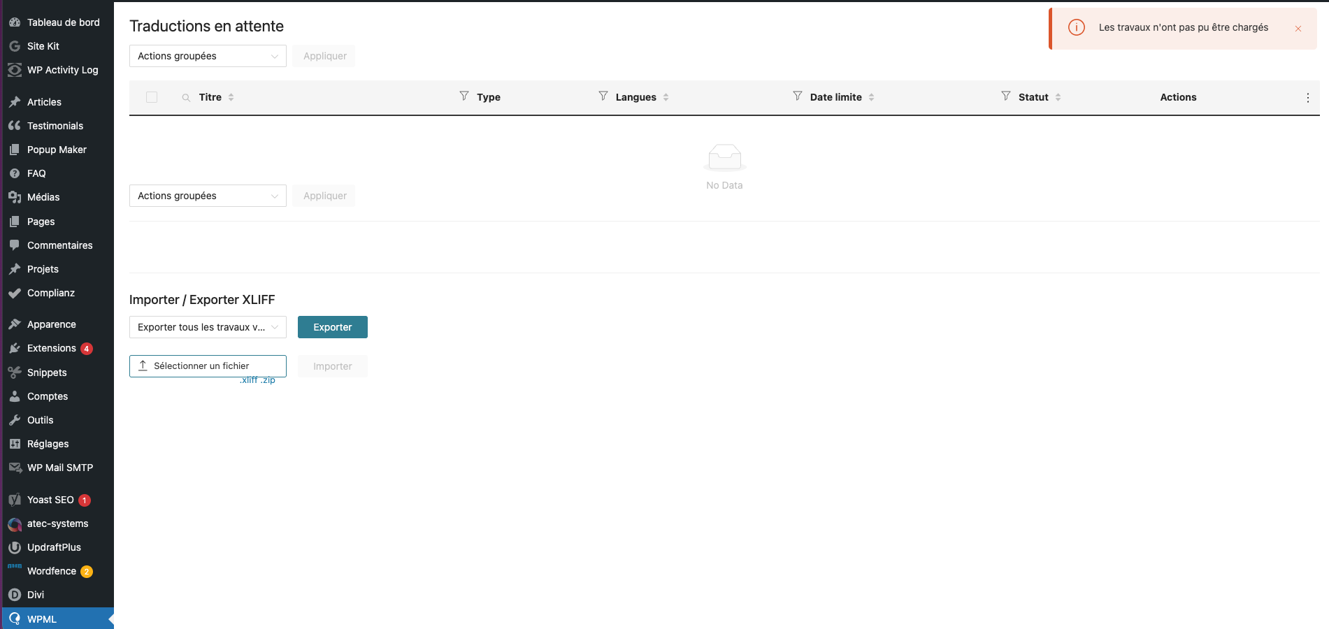

albaneC
Contexte de la question:
I am trying to go to the translation editor to translate elements I've sent for translation. The issue can be seen on this page: lien caché.
Symptômes:
I expected to see a list of items to be translated, but instead, I got an error message saying 'jobs could not be loaded'. The page is empty.
Why are the jobs not loading in the translation editor?
How can I resolve the error message and see the list of items to be translated?

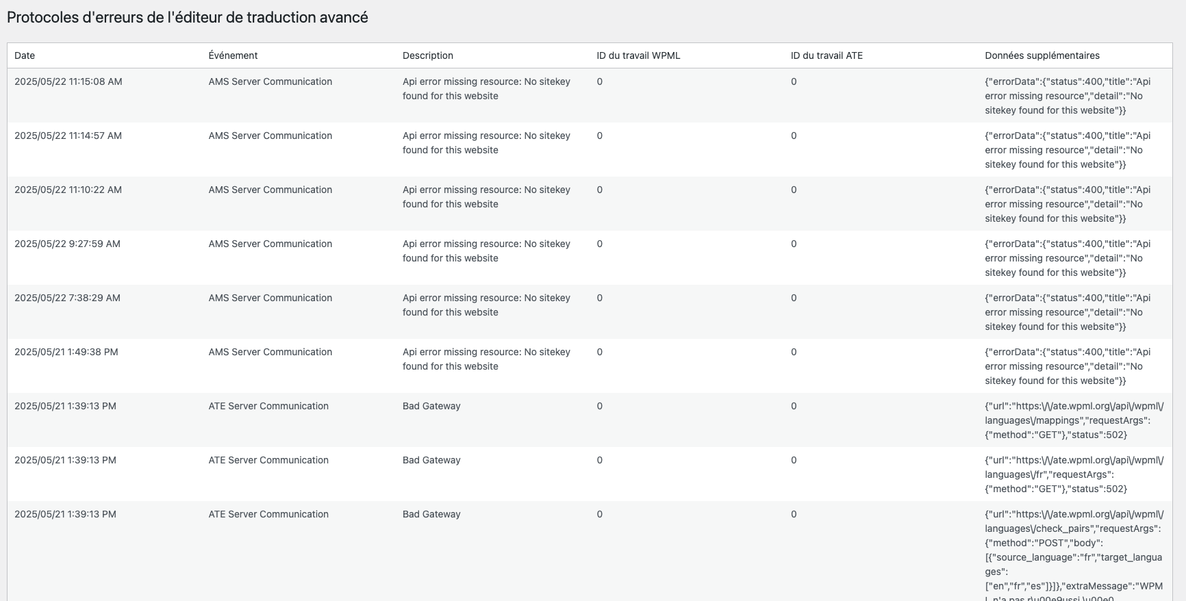

mai 22, 2025 à 11:58 am #17061395
albaneC
We increased the memory as advised, but this didn't solve the problem.
Attached is the error log

mai 23, 2025 à 2:17 am #17063947
Ilyes
The ATE error logs shows that the Key is mismatching, apparently the key wasn't added correctly,
Please go to your account page (https://wpml.org/account/sites/)

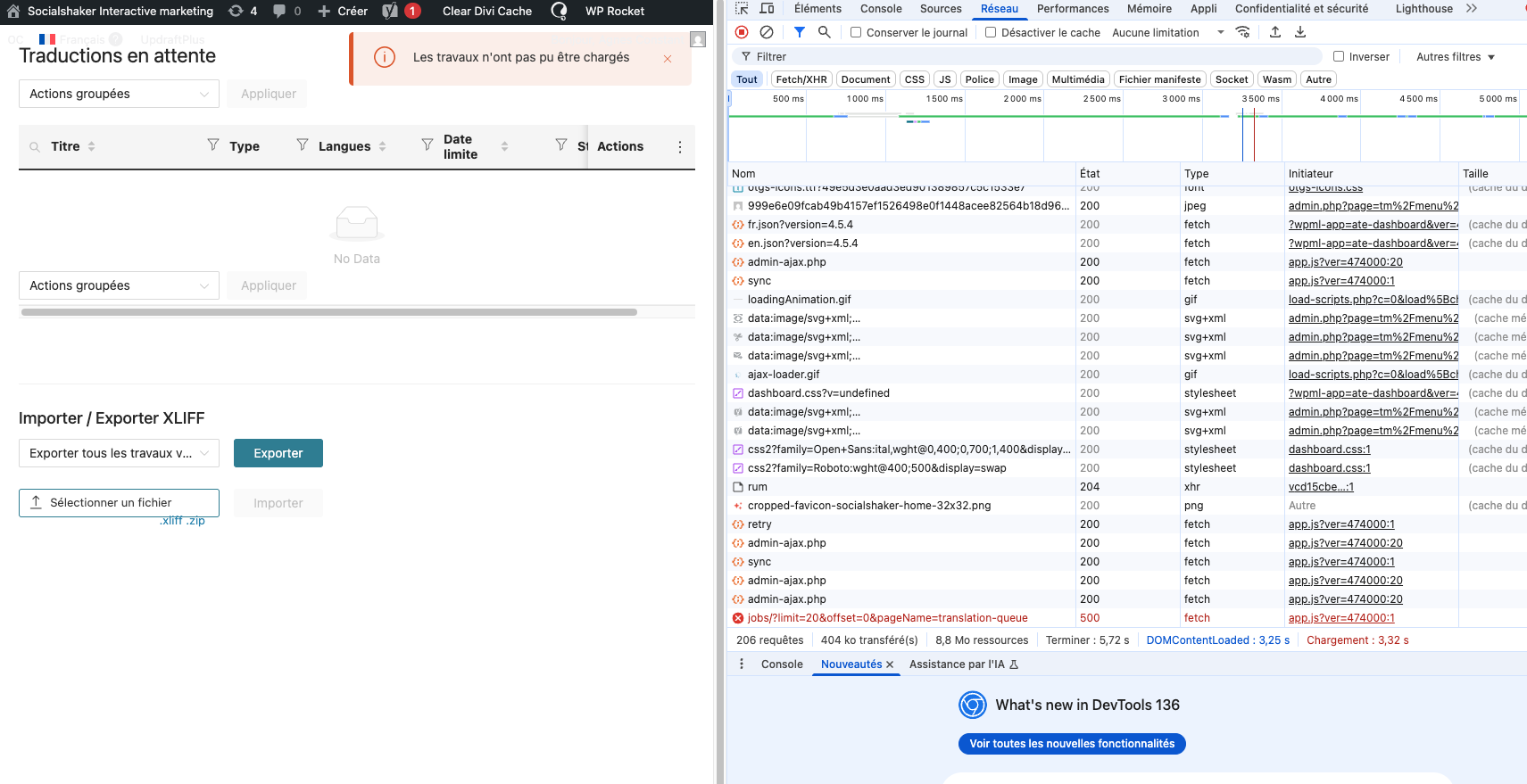

mai 23, 2025 à 12:50 pm #17066373
albaneC
I've solved the key problem, it's synchronized, but the problem persists, still “no data”, it's becoming urgent... I haven't been able to translate for several days now. The console shows the following error:
"code": "internal_server_error",
"message": "<p>Il y a eu une erreur critique sur ce site.<\/p><p>

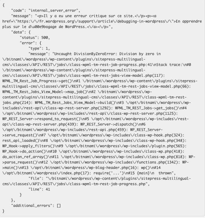

mai 26, 2025 à 12:45 pm #17073342
albaneC
Thank you for your reply.
I can't share the back office access with you. We still have “no data” loading on the WPML backoffice, in terms of managing translation tasks, when we send an article or a page for translation, the manager is empty. Here's what we've done so far:
- Increase memory: ok
- Re-synchronized the site key: ok
- The log doesn't show any new errors since the last error which said “Api error missing resource: No sitekey found for this website”.
- We've looked at the error in the console when we load the page, and here's the error that comes up, can you tell me what you think?

mai 26, 2025 à 7:14 pm #17074896
Ilyes
So this is a known issue, That may be related to the following tickets.
https://wpml.org/forums/topic/if-i-click-on-the-job-page-within-wordpress-it-says-that-jobs-cannot-be-loaded/
https://wpml.org/fr/forums/topic/split-impossible-de-charger-les-travaux/
Please try the workaround suggested in the resolved summary of the above tickets after a full site backup {mandatory}. Then make sure you can access the Translation Jobs, and also the following fatal error is showing in the Debug.log or not.
Here is the exact error for reference
PHP Fatal error: Uncaught DivisionByZeroError: Division by zero in /***/wp-content/plugins/sitepress-multilingual-cms/classes/API/REST/jobs/class-wpml-tm-rest-job-progress.php:41
