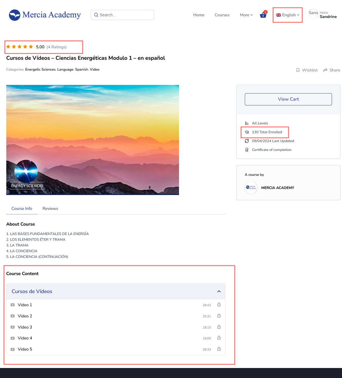

Avril 9, 2024 à 10:01 am #15498138
stephanieD-24
We have trouble dealing with the languages of the courses on Tutor LMS.
The courses is displaying different information in different languagues, as you can see on the different screenshot but I would like it to be the same in all languages.
Can you tell us what is wrong with the settings? Thank you

Avril 10, 2024 à 8:21 am #15502682
stephanieD-24
Thank you Lauren for all the advise...
So that's what we want, to have the same content on all different languages. the option "Translate or Fallback to Default (in WPML -> Settings -> Post Types)" was selected ...
So how can we delete the translations which seem to have been created as you can see on the screenshot...and make sure that the course will be the same on both languages...
thank you for your help!

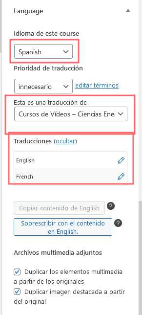

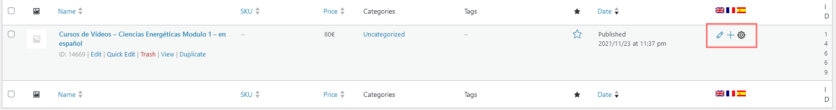

While I'm investigating the different versions of the duplicate pages:
1/ do you know what the differences between these three pages(see screenshots)?
- original page in english
- french
- spanish
So I can try to understand what happened?

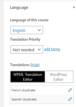

Avril 10, 2024 à 2:32 pm #15505486
Nicolas V.

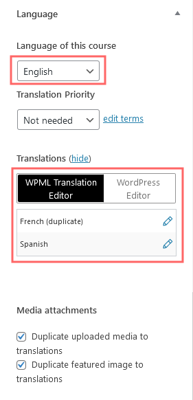

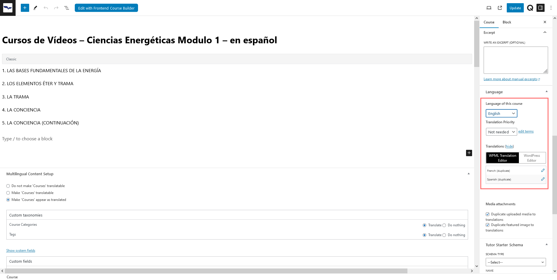

From the screenshot you sent I can see that you duplicated the courses in French and Spanish.
1. If you want to keep the duplication, please deactivate our editor (Right above your duplication you have "WPML editor" in black, select "WordPress editor" instead.
2. If you want to delete them, then go to the "Courses" and use the flag in your top admin bar to switch to French.
- Find this specific course and trash it
- Go to the trash and empty it (or click "delete permanently")
- Repeat the operation for Spanish

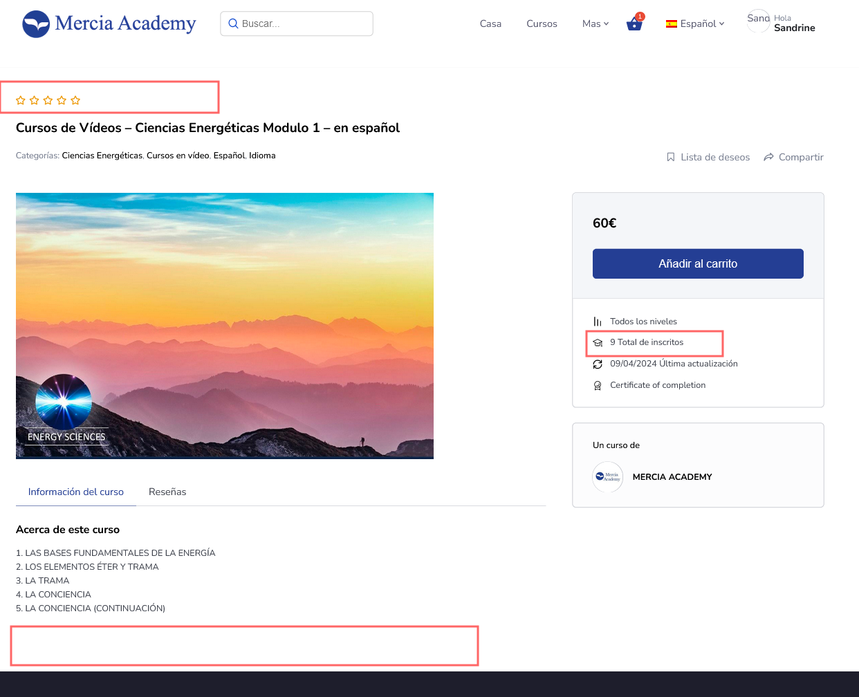

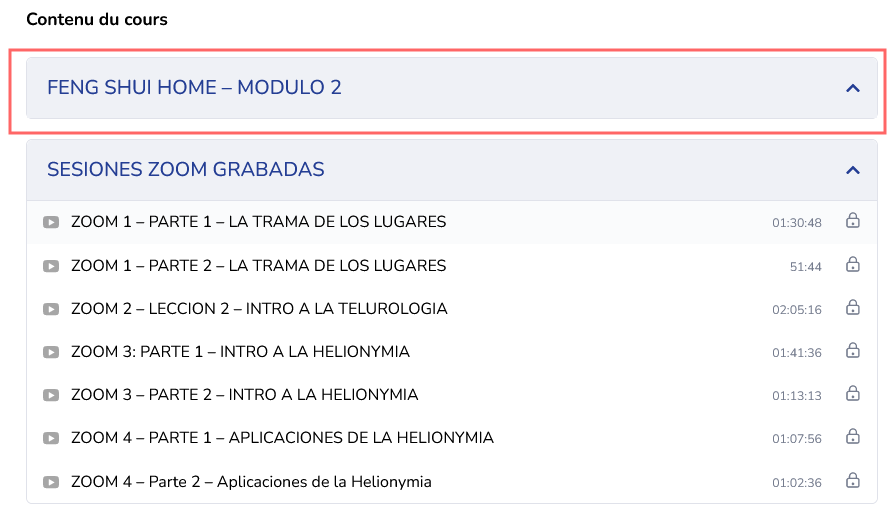

Avril 11, 2024 à 8:50 am #15507731
stephanieD-24
Good morning Nicolas,

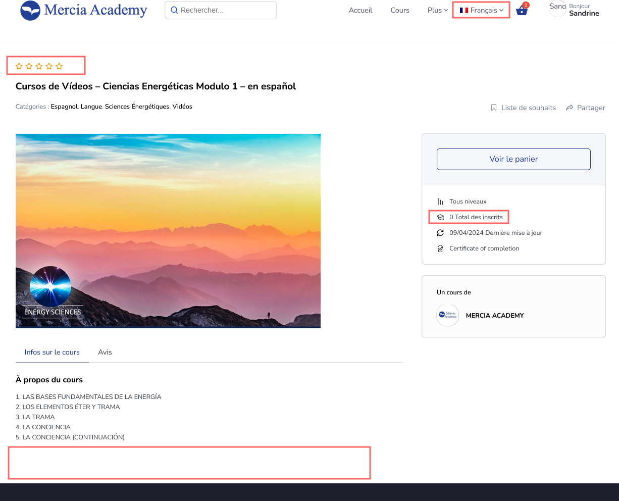

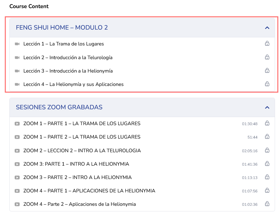

Thank you so much for your help. We deleted the courses as advised, but I still have trouble with two courses, which should be the same in both languages, but some content are missing as you can see on the screenshot.
I put the url for you to check :
lien caché
I don't understand where it comes from. Could it be linked to my settings? (I put a screenshot).
Thank you for your help!

Avril 12, 2024 à 8:19 pm #15514033
Nicolas V.

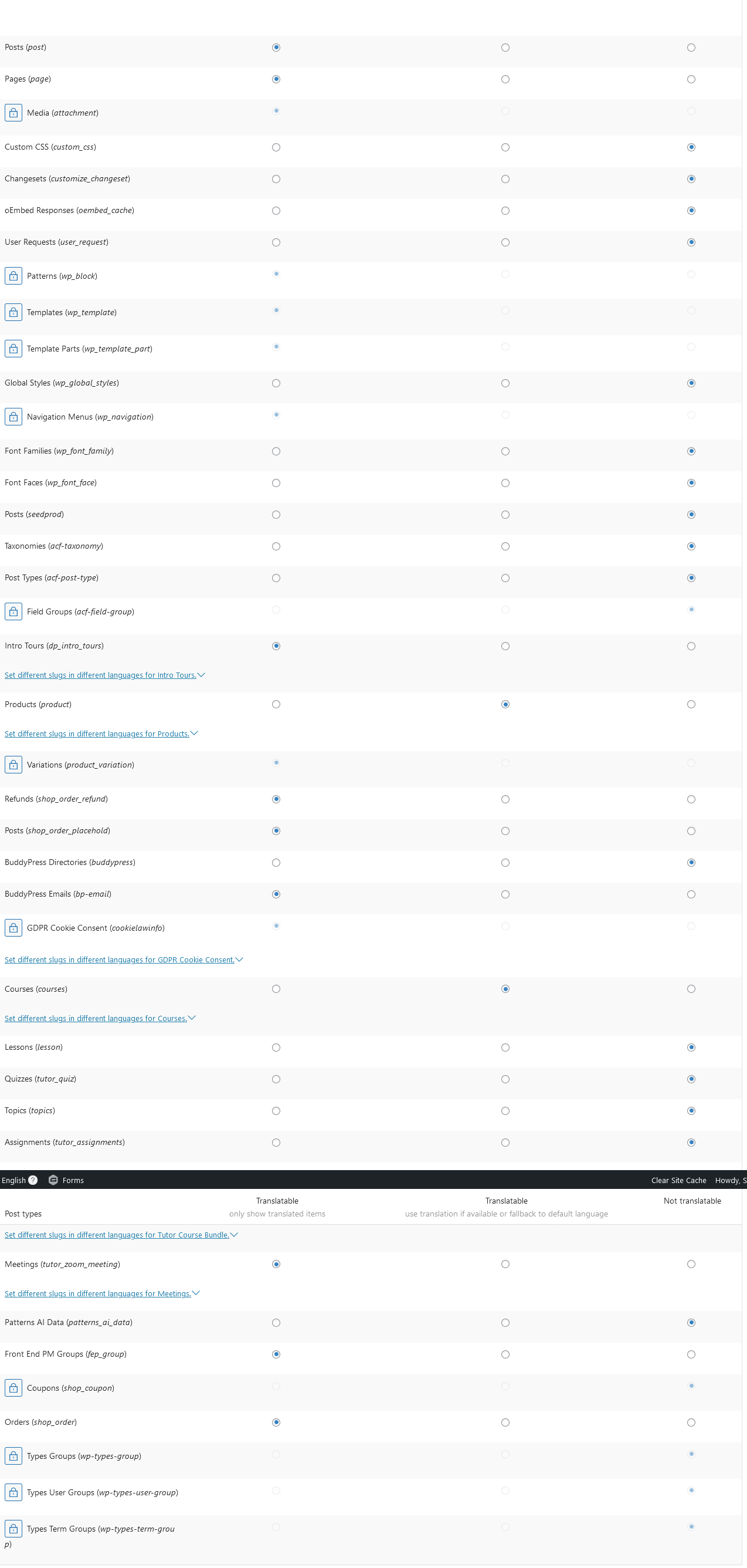

Thanks for the access. It helped me understand that the module is not a Custom Post Type (CPT) in itself. That's a element that can contain different types of CPT: lessons, meetings, assignements etc...
You need to set the translation preferences for all those CPTs also to "Translatable - use translation if available or fallback to default language"
Here is the video of my intervention: lien caché

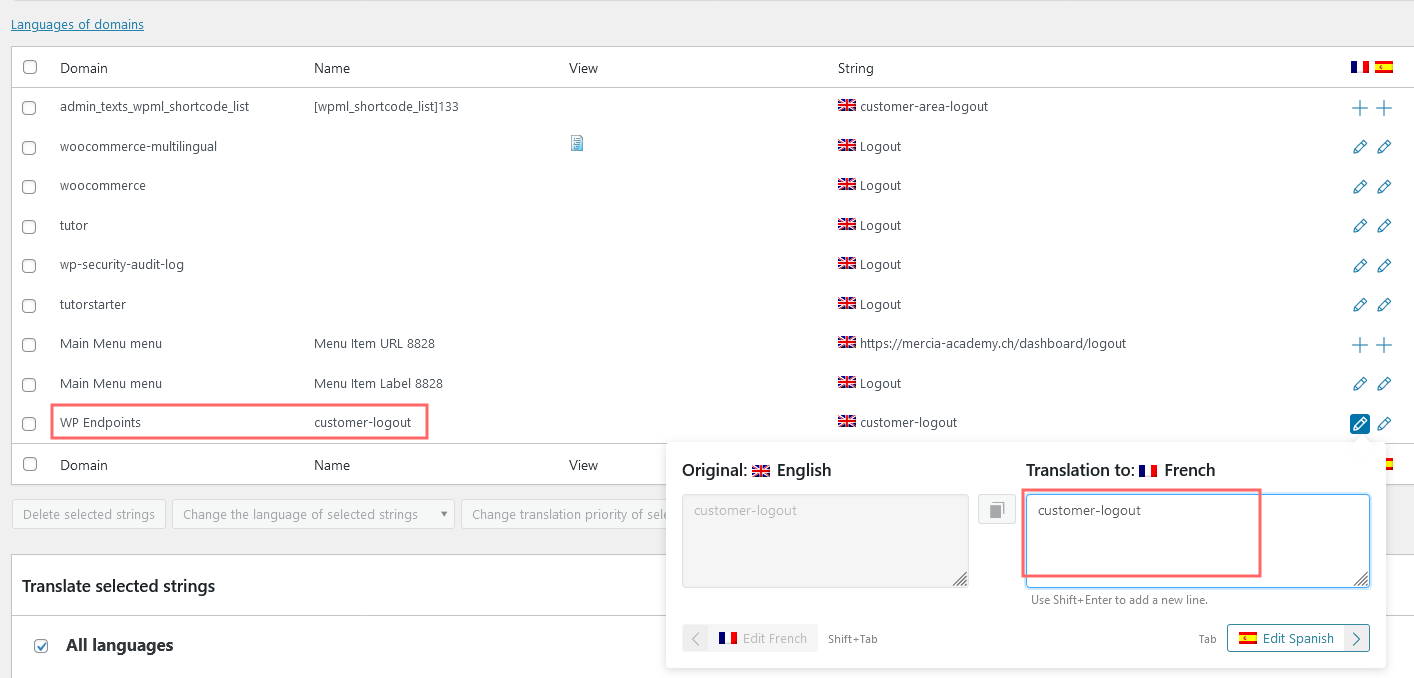

So my problem is that there is a bug with "Logout" link
In english, it works fine lien caché
but in spanish and french we've got a message (see the screenshots)
so because tutor lms creator can't propose a solution, I would like to change the string so it's by default the english one...I tried to follow this tuto but did'nt manage, as I can only change the words,but not the entire url...
https://wpml.org/documentation/getting-started-guide/string-translation/finding-strings-that-dont-appear-on-the-string-translation-page/#translate-admin-and-settings-strings
but didn't manage...
