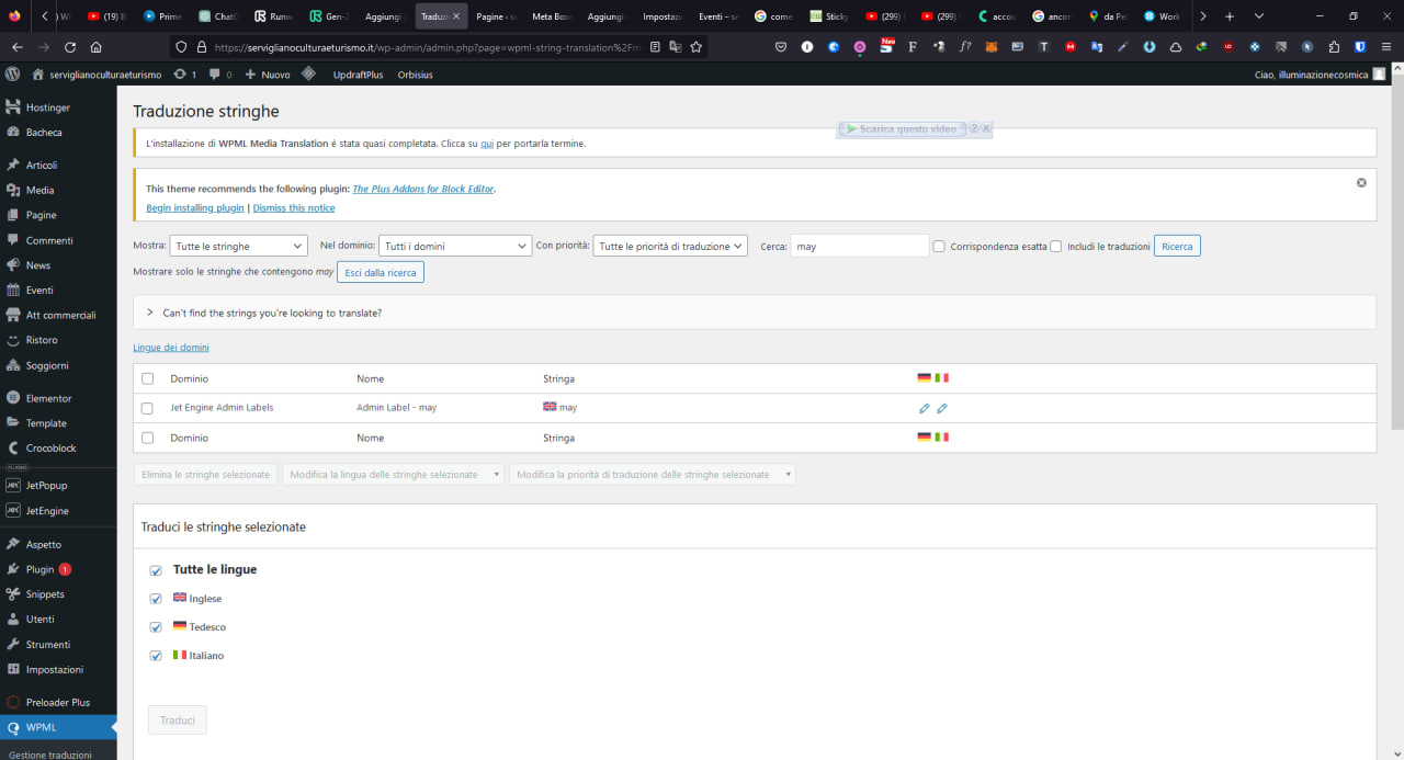

1) I go to WPML => String Translations >.
2) I look for the MONTHS data entered in the EVENT Metaboxes, then enter in the "🔍Search", one at a time, all 12 months in Italian.
PROBLEM: Here I see that each month I formulated in ITALIAN results in ENGLISH and I can only translate into ITALIAN and GERMAN.
[ATTACH SCREEN 1].
Example.
- "GEN" is the abbreviation for GENNAIO in Italian, but WPML sees it in English.
- "GEN" I can only translate it into ITALIAN and GERMAN, but GEN is already in Italian.
[ATTACH SCREEN 2].
- It would have been correct if you had asked me to translate GEN (ita) into => JEN (eng) and JAN (deu)
I realized for myself that the problem arises from the fact that the JETENGINE plugin (as well as all CROCOBLOCK plugins) are natively detected in English (just as WPML is detected by itself as English).
[ATTACH SCREEN 3].
So I tried entering the months in English and then translating them into Italian and German.
Then on the site in ITALIAN, before translating everything, it only shows me the English version even s ele strings I have already translated them.
QUESTION 1: How do I get the string displayed, inside ELEMENTOR, via DYNAMIC FIELDS, inside TEMPLATES, in the right language?
[ATTACH SITE SCREEN ITA and ENGLISH DATE[
QUESTION 2: Can I change the language in which a PLUGIN is detected by WPML? Then have JetEngine detect it as ITALIAN and/or WPML detect it as Italian and then start translating the strings into other languages?

Ciao!
Sono Paola, spero vada tutto bene.
Per cambiare il dominio di una stringa devi fare questo:
https://wpml.org/documentation/getting-started-guide/string-translation/how-to-change-the-source-language-of-strings/
In questo modo puoi mettere il italiano come quella predefinita.
Dimmi se hai qualche problema.
