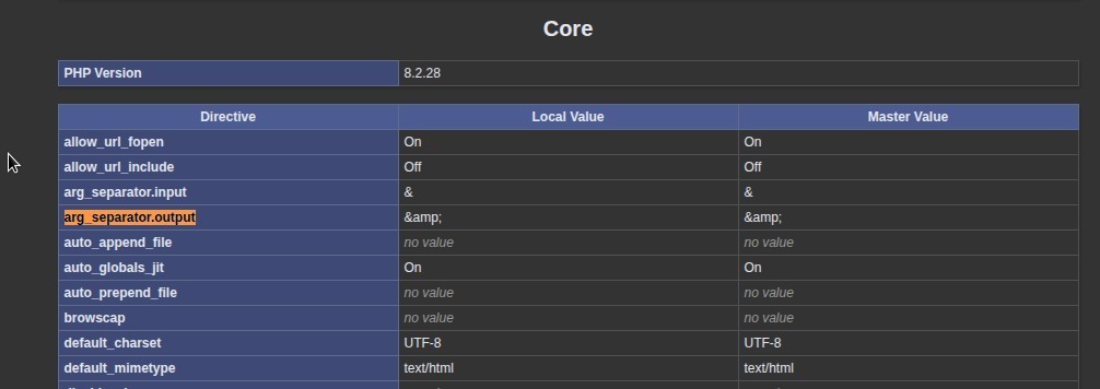

Juni 5, 2025 um 2:39 p.m. #17110736
George Botsev
WPML-Unterstützer seit 02/2014
Sprachen: Englisch (English )
Zeitzone: Europe/Sofia (GMT+02:00)
Here is the setting in question

You were absolutely right – the problem was caused by the arg_separator.output directive in my server's php.ini, which was previously set to & instead of just &. I’ve now corrected it (I'm the Hoster, because it's a dedicated server) and restarted PHP.
