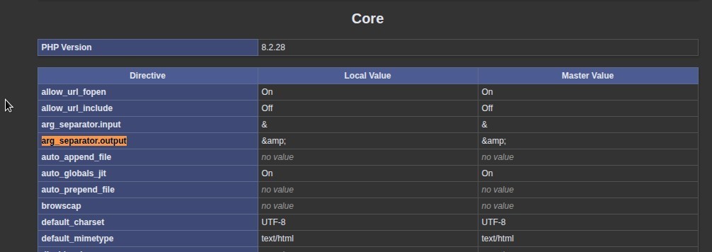

I further analysed your site as you have very usefully put there a phpinfo script.
The problem is this line in your php.ini:
arg_separator.output = &
Juni 5, 2025 um 2:39 pm #17110736
George Botsev
WPML-Unterstützer seit 02/2014
Sprachen: Englisch (English )
Zeitzone: Europe/Sofia (GMT+03:00)
Here is the setting in question
Juni 5, 2025 um 2:46 pm #17110794
jensS-38
Thanks again for your persistence and support.
You were absolutely right – the problem was caused by the arg_separator.output directive in my server's php.ini, which was previously set to & instead of just &. I’ve now corrected it (I'm the Hoster, because it's a dedicated server) and restarted PHP.
