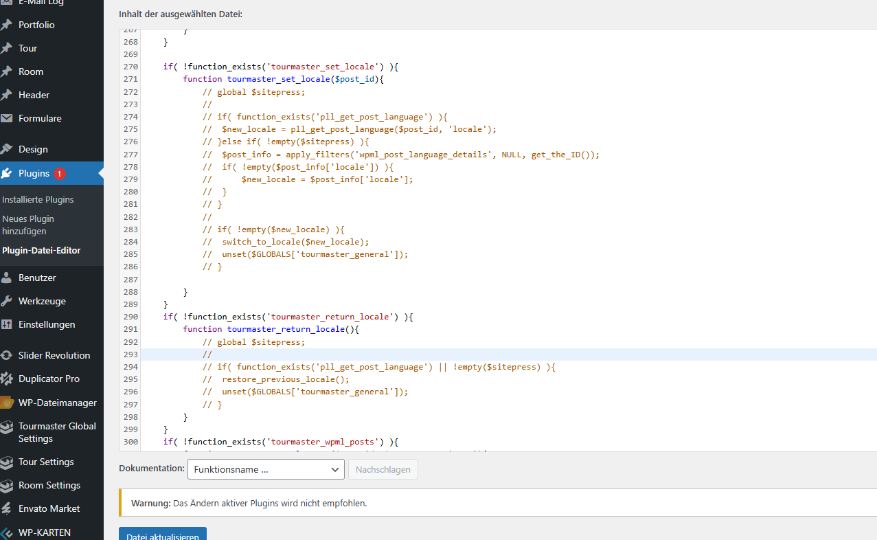

Hi Bruno, you want me to change in the live page. In that case I have different line numbers (see attachment). Or do you want me to change it at the sandbox page?

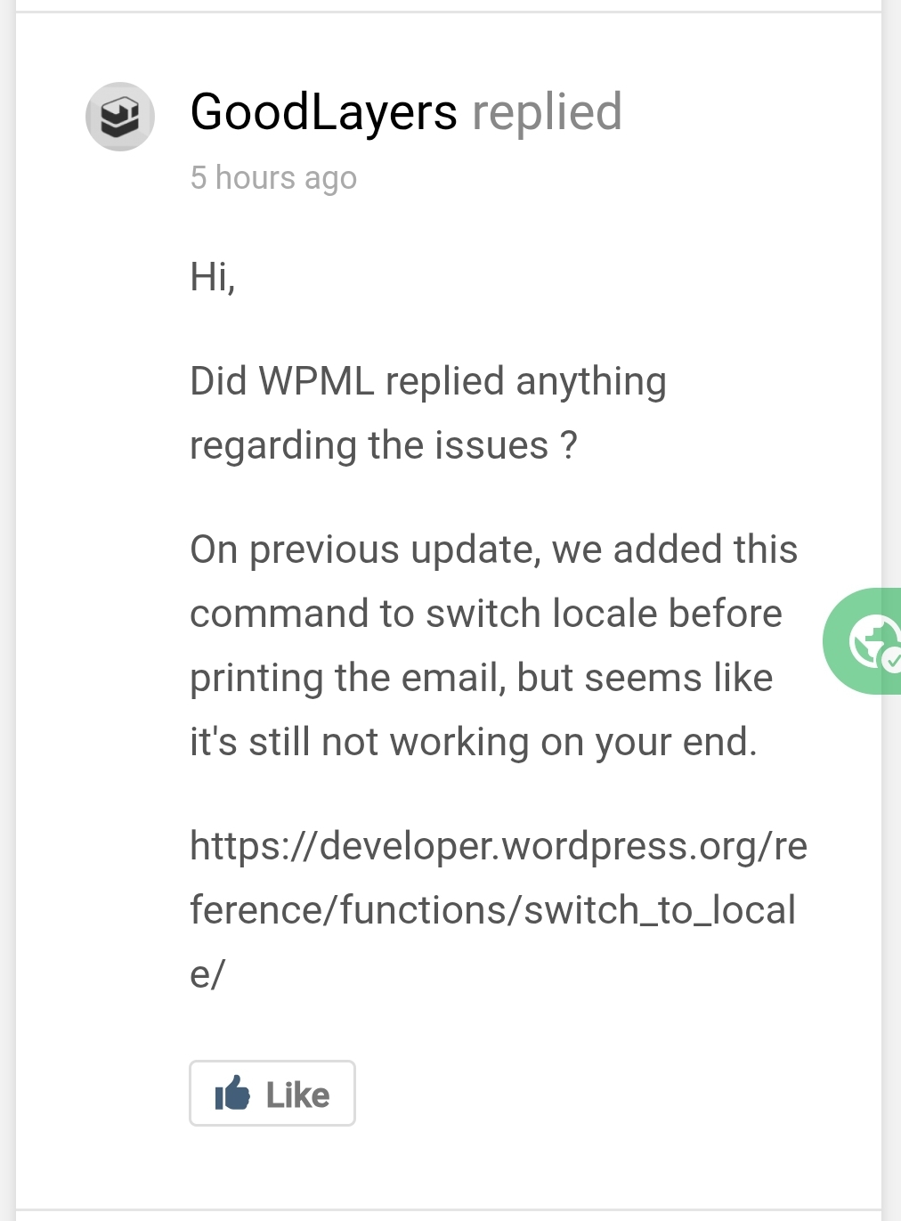

remigiusK
The attachment is for your information (answer support from Goodlayers)

Try this on your live site. Do you have the same Tour Master version? In Sandbox we don't have FTP access so any coding mistake would take the site down.
Lines should not matter for as long as you commented and changed the same function.

Thanks Bruno. I will try it out. However I can't see what I should do with line 270 or in the equivalent line in my file. There is no \\ for removing. Could you guide me here please?

The whole function should be like this, so everything should be uncommented. I apologize for the confusion.

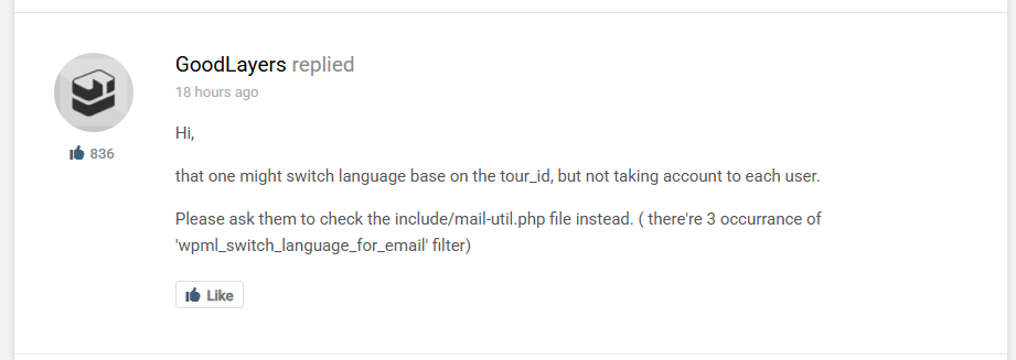

Hello Bruno, in addition to my previous comment this is what Goodlayers replied (see attachment). Thanks and regards, Remy
