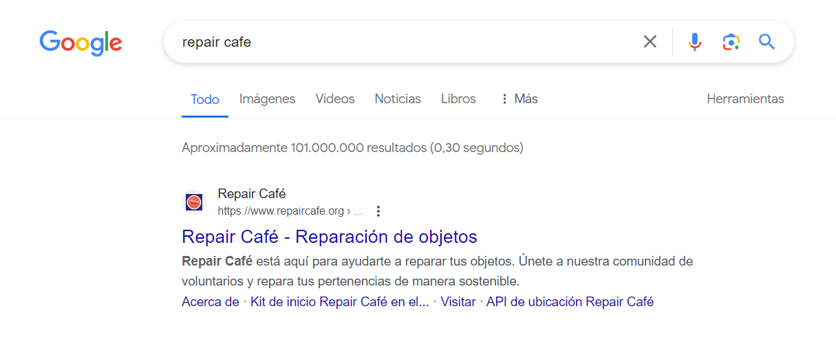

For example, the following hreflang indicates a homepage has a version for Spanish users, on the specified URL:
<link rel="alternate" href="https://www.repaircafe.com/es" hreflang="es" />
So, when a user in Spain searches for this homepage, Google shows its Spanish version.
Google showing Spanish version of a page in Spain

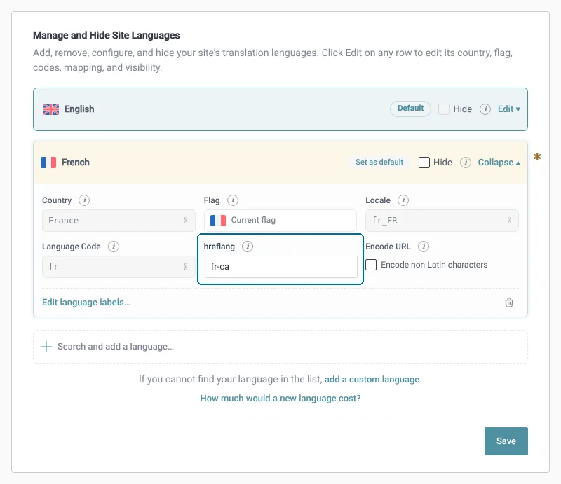

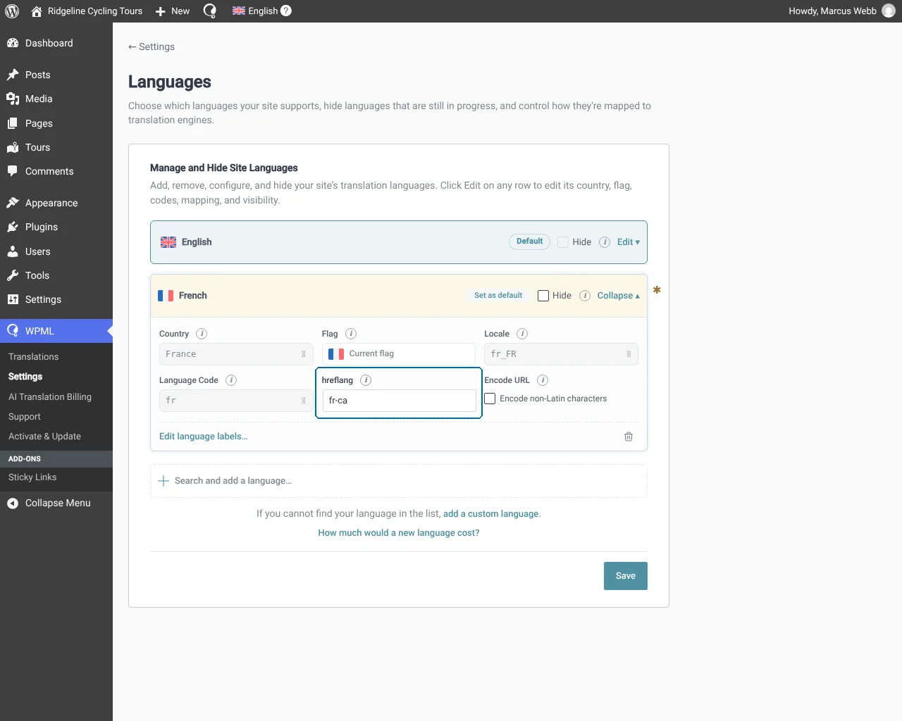

By default, languages you add in WPML are not tied to countries. Regional targeting is an hreflang value you write yourself, on the language itself.
The value carries a language and a country of your choice. For example, to tell Google that your French pages are meant for readers in Canada, give French the value fr-ca.
Adding regional targeting to hreflang in WPML → Settings → Languages
Go to WPML → Settings → Languages, click Edit on the language’s row, and write the value in the row’s hreflang field. Adding the region as a second language does not work when that language is already active on your site, so the row’s own field is where regional targeting belongs.
