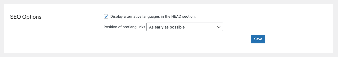

When you use WPML to build multilingual WordPress sites, you get the hreflang attributes automatically. By default, WPML will add hreflang as close as possible to the beginning of the <head> section. You can control it from WPML -> Languages -> SEO Options.
WPML will include the correct hreflang links in the site’s header. These tags will link to all available translations and to the same language. If an item is translated to only part of the site’s languages, WPML will include hreflang links only to these languages.
The option to display the hreflang link attributes at lower priority is a fallback, which is useful if some themes trigger WPML initialization too early. In addition to the position of these tags in the header, you can control the language/locale codes that WPML will output in the tags.
