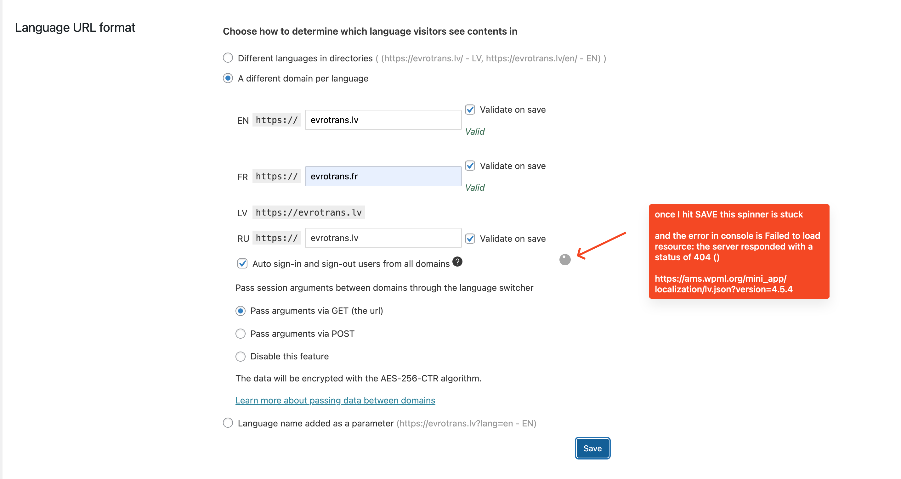

I need to configure WPML to use a different domain for the French language while keeping other languages under the existing domain. The setup should be: Latvian (default) - hidden link, English - hidden link, Russian - hidden link, French - hidden link.
When I try to save the settings, all options are validated, but the 'Auto sign-in and sign-out users from all domains' feature keeps spinning.
Why is the 'Auto sign-in and sign-out users from all domains' feature not completing?
How can I successfully configure a different domain for the French language?

Here is what I see in console when spinner is stuck
Failed to load resource: the server responded with a status of 404 ()

April 22, 2025 at 4:21 pm #16956595
Your example uses different site URL formats and you can sadly not mix them.
You try to use:
English - hidden link (Languages in directories)
Russian - hidden link (Languages in directories)
French - hidden link (A Different Domain per Language)
You can sadly not use those URLs if you want to use a different domain per language:
April 22, 2025 at 5:19 pm #16956745

April 22, 2025 at 5:43 pm #16956856
Both options are valid. You can use full domains or subdomains at the same time. You can not use directories and domains/subdomains at the same time.
