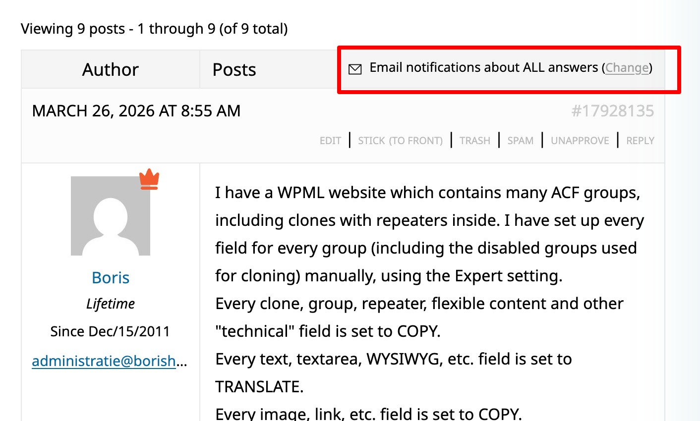

Can you provide me access to the google drive link, I have requested for it.
Regarding the notifications, can you go to first messages on this ticket and check on right if notifications is enabled?
Look forward to your reply.
April 1, 2026 at 10:23 am #17942564
Boris
Hi Shekhar,
I just gave you access. And I switched on email notification. Thanks for that tip!
