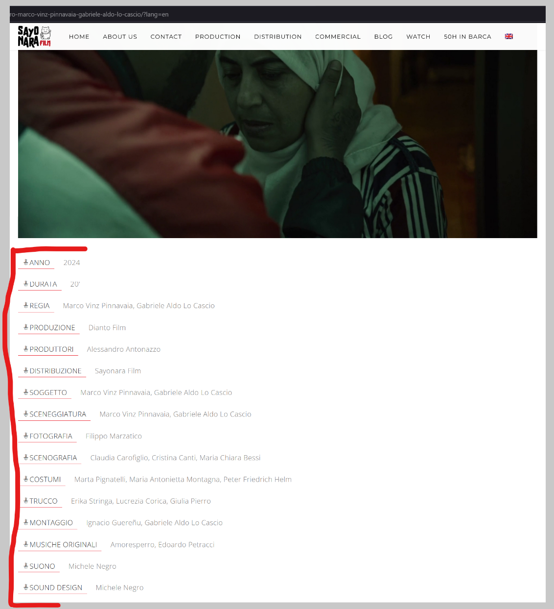

Hi I follow your link but is not working https://wpml.org/documentation/related-projects/translate-sites-built-with-acf/translating-acf-field-labels-with-wpml/#same-fields-across-languages.
check my image, the label of the acf form fields are in italian, I'd like to haave it in English.
I need help
thanks
June 7, 2024 at 9:38 pm #15717840
Mihai Apetrei
WPML Supporter since 03/2018
Hi there.
It looks to me that those labels were not translated, but actually copied.
Please take a look over this existing ticket at what my colleague Prosenjit is explaining as I think it might be valuable for you (check both page 1 and page 2 of that ticket).
So that you can see that you can set the custom fields to "copy", "copy once" or even "translate", so that you can translate them.
Also, here is more info about the "Expert" mode that's being mentioned in that ticket:
https://wpml.org/documentation/related-projects/translate-sites-built-with-acf/expert-translation-option/
You might also want to look for those in WPML > String Translation afterward.
Please let me know how things go.
