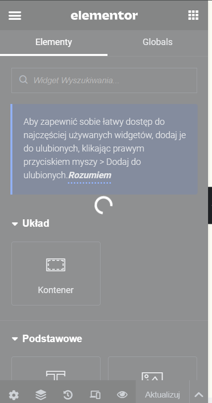

after activating my elementor editor is not loading. but when deactivated WPML it loaded properly without any issue. can you please help me to resolve this issue?

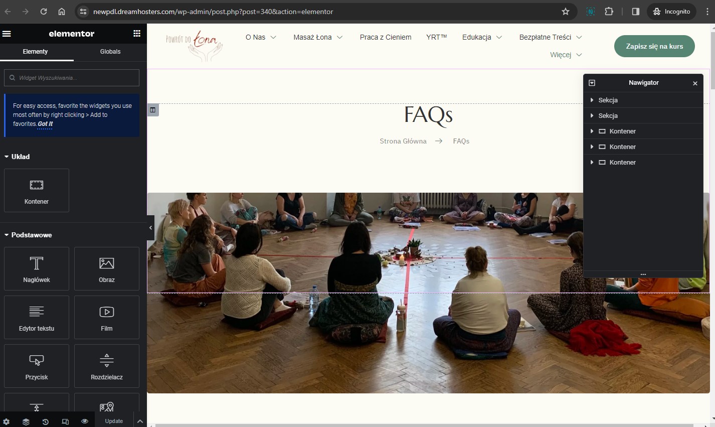

I just tried hidden link in your site and I was able to see the Elementor loading fine (see attached).
Can you check again after clearing all caches (browser and WP Rocket)?
Besides this, I see that Elementor and Elementor Pro needs an update, please remember to update these to the latest version, after taking a fresh backup of your site and database.
Please let me know and I'll try my best to help you further on the matter.

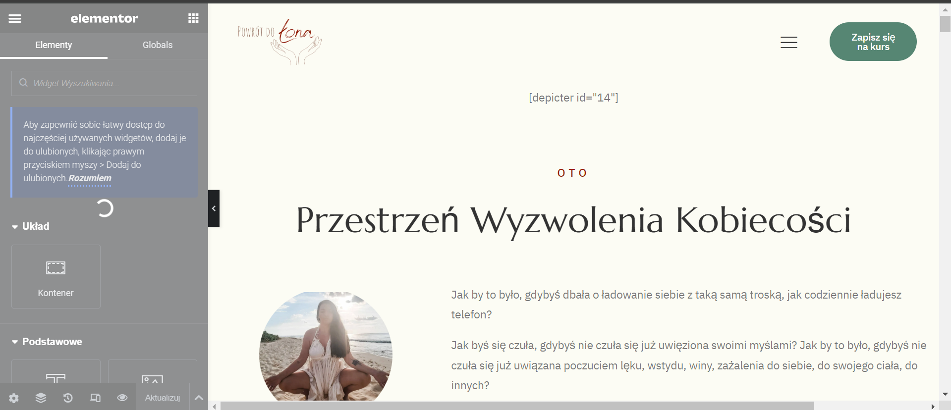

i downgraded elementor version to check if it solves the issue!
but it did not!
i again update them to the latest version and the issue is still there!
I have attached the screenshot

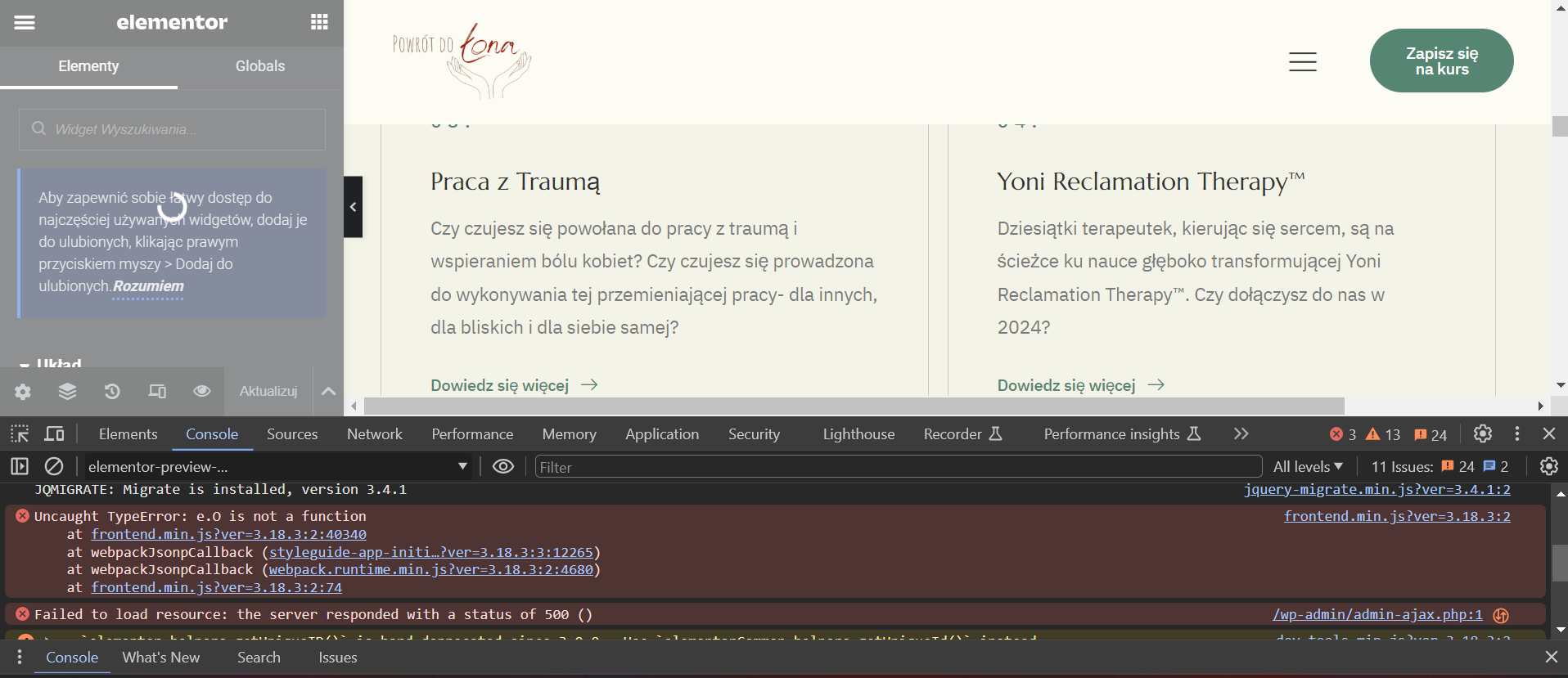

This is the error i see in the console!

I checked again and can find it working perfectly fine - see my screen recording hidden link
ElementsKit Lite (https://wpml.org/plugin/elementskit/) was enabled already, while I also activated Eventin plugin after updating it.
Although there's a JS error coming from Elementor, but still editor works just fine.
Eventin, however, isn't on our compatibility list (https://wpml.org/plugin/?wpv_view_count=120064&wpv-plugin-functionality=0&wpv_post_search=Eventin&wpv-wpcf-recommendation-flag=&wpv_filter_submit=Search). So if you think the issue is coming from this plugin, then please check with their support and let me know any related technical info you receive.

Actually, i logged into the website with the user i created for you guys and it seems that there is no error!
Do you guys have any idea?
January 11, 2024 at 8:13 am #15172571
Waqas Bin Hasan
WPML Supporter since 05/2014
Perhaps that user's capabilities have been compromised. However, no sure about it. But you can try following workarounds:
A) Create a new admin user like you did for us and continue using that.
B) Make sure all users have first/last names filled in their profiles.
- Add the user as a translator in WPML -> Translation Management -> Translators.
- If there's an existing one, remove that and add again with proper language pairs (but make sure their profile has first/last names filled correctly).
C) Try the solution from this thread https://wpml.org/forums/topic/additional-users-within-admin-role-do-not-get-correct-permissions/#post-14261843. Make sure to adjust user ID to the user you want to fix for.
