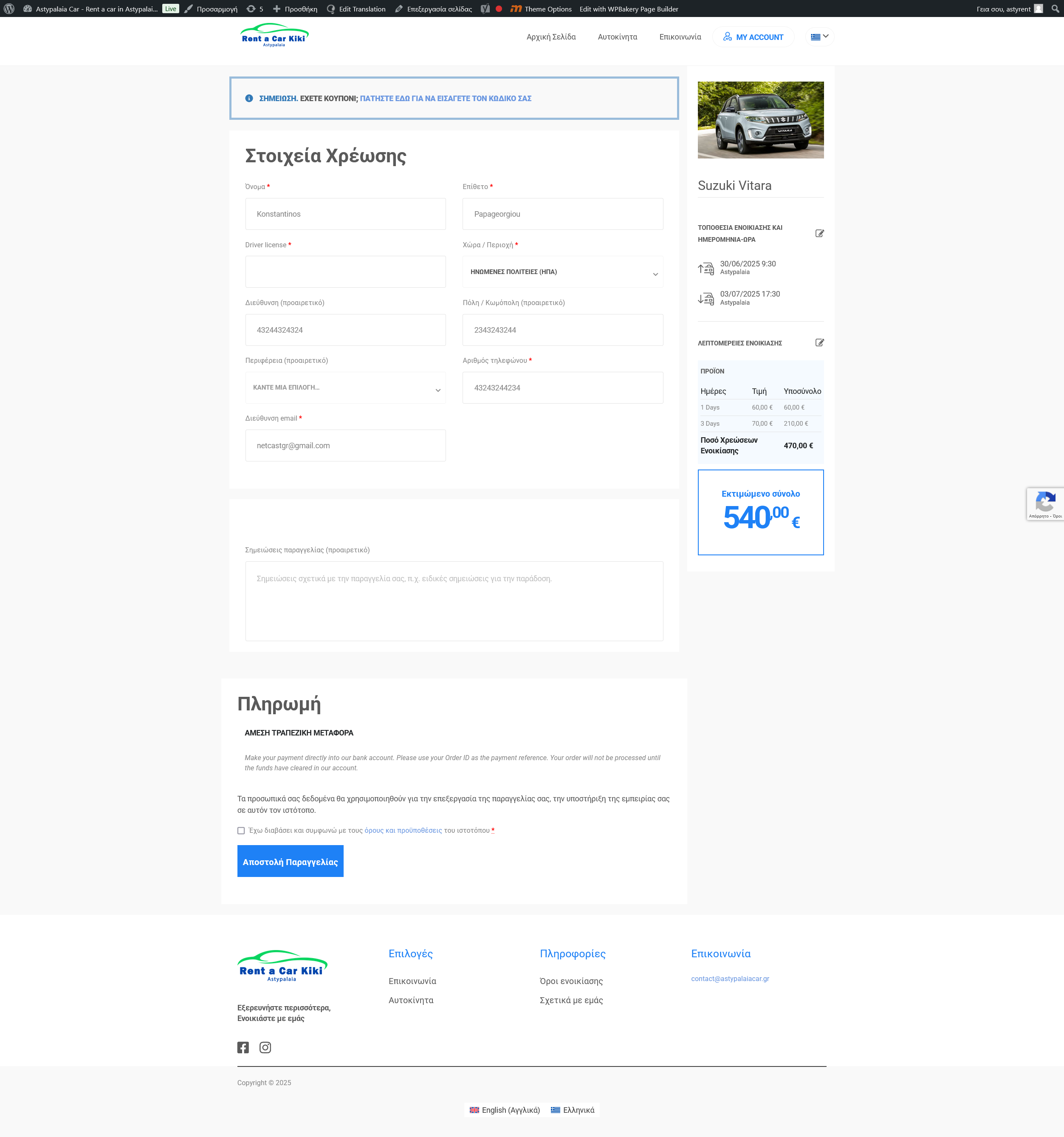

I am using the WPML plugin along with WooCommerce Multilingual on my site hidden link. I am trying to book a new car, but I am experiencing an issue with the pricing.
After activating the WooCommerce Multilingual plugin, the prices on the checkout page keep increasing and do not reset when I try to book a new car. Normally in the screenshot price should be 270, but it is adding price of previous viewed item and it adds to 540
Why are the prices increasing at checkout after activating WooCommerce Multilingual?
How can I reset the prices when booking a new car?

Hello. The issue begins the moment I translate products in the second language.
For some reason in the sandbox, even though I select to translate products, the page afterwards does not include products to translate.
If you try to translate all products right after, the price in card keeps increasing every time you try to checkout in the second translated language.

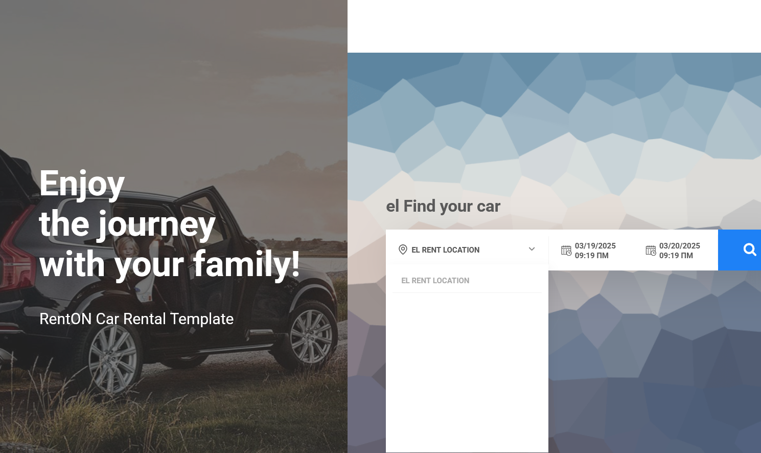

Hello, thanks for your detailed response. There seems to be a problem with the office selection in Greek language. Please see attached. Can not select the ones available in English.
May I suggest to start over with a clean install? I can then re-upload the theme and replicate the problem. What do you think?
