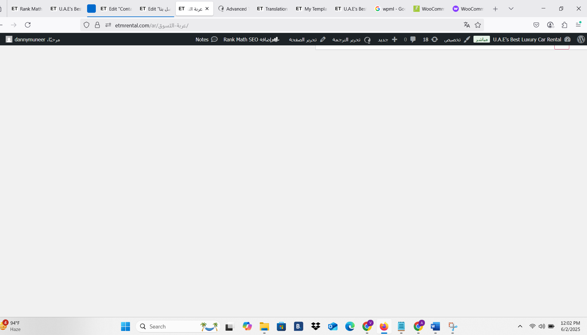

I am trying to translate my website, hidden link, into two languages: Arabic and Russian using WPML.
The Arabic page shows a white screen.

The white screen on your Arabic page could be caused by a PHP error or memory issue. Here are some steps to diagnose and fix it:
Enable WordPress Debugging:
In your wp-config.php, enable debugging to reveal the actual error:
define('WP_DEBUG', true);
define('WP_DEBUG_LOG', true);
define('WP_DEBUG_DISPLAY', false);
Then visit the Arabic page again and check the /wp-content/debug.log file.
Check Memory Limit:
The minimum requirement is 128M but I suggest that you increase it to 512M: https://wpml.org/home/minimum-requirements/
You can add this by adding the code below to "wp-config.php" file of your WordPress installation root folder:
/** Memory Limit */
define('WP_MEMORY_LIMIT', '512M');
define( 'WP_MAX_MEMORY_LIMIT', '512M' );
