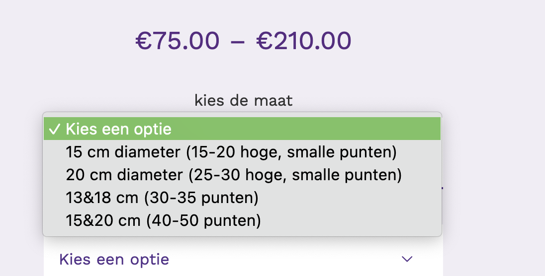

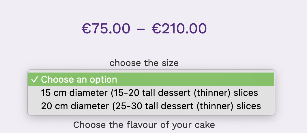

I'm trying to figure out why product attributes for these pages aren't getting displayed on the front-end. The customer added some more attributes and translated them fine. They're visible on the backend but not the front end. hidden link is the Dutch version and the first attribute has four options. And if you switch to the English page and check the first option then there's only two sizes. But they're all visible on the backend.
There is a lock icon on the translated page on the attributes if that makes a difference.

So I made a backup and ran that tool in troubleshooting but it doesn't seem to have made a difference since I still don't have the attributes visible on the English page 🙁
