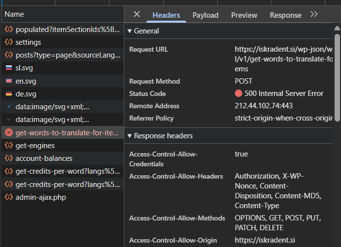

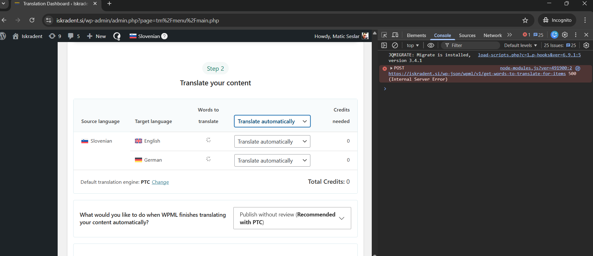

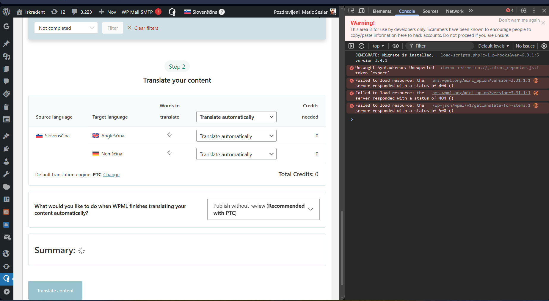

I installed WPML without any issues. However when I try to run automatic translation it's just loading and shows me errors. What could that be?

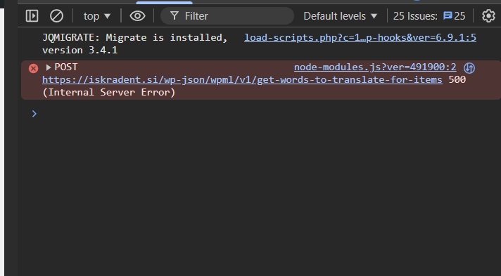

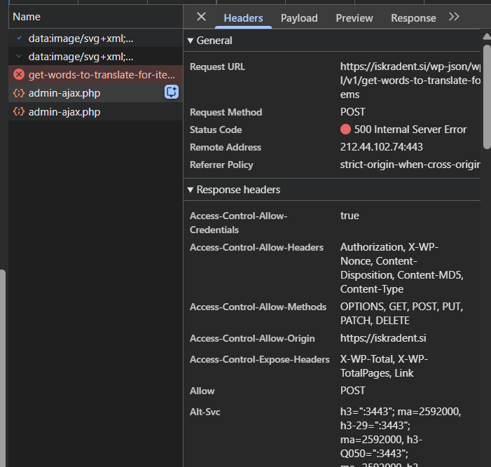

Thanks for the screenshot — the console shows two key problems:
  • A 500 error on your site’s WPML REST endpoint:
    /wp-json/wpml/v1/get_translate_for_items
    (server-side issue).
  • 404s loading WPML mini-app assets from
    ams.wpml.org
    (connectivity/caching/adblock/WAF issue).

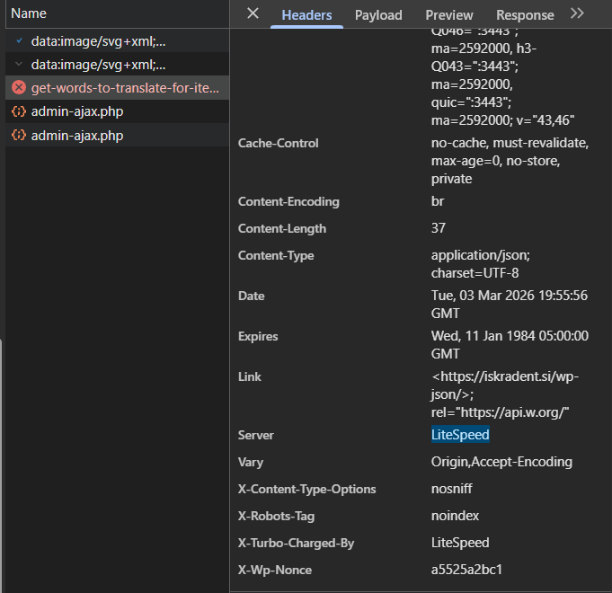

Could it be lightspped in cpanel causing issues?
March 3, 2026 at 8:27 pm #17870090
lovroI
ok I managed to get it down to just this error. The problem is I don't have Lightspeed in my Cpanel enabled nor do I have a plugin for lightspeed in wordpress. What can I do?
