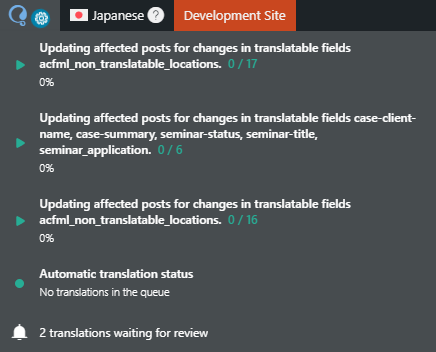

April 15, 2024 at 6:15 pm #15521549
Masaki Nagashima
I pushed it like you said and now it can translate automatically.
Thank you very much.
I am not sure what was the cause of the problem and I am worried that I will not be able to translate again.
Please let me know if there is any possible cause.
Also, I can now auto-translate, but the header display does not disappear.
Is this a different problem from the automatic translation?

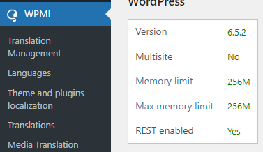

April 17, 2024 at 12:33 pm #15532063
Masaki Nagashima
I have added the code you gave me.
Only 'your_username' and 'your_password' need to be rewritten, right?
The translation still doesn't work, but the REST API seems to be working in the WPML support menu view.
