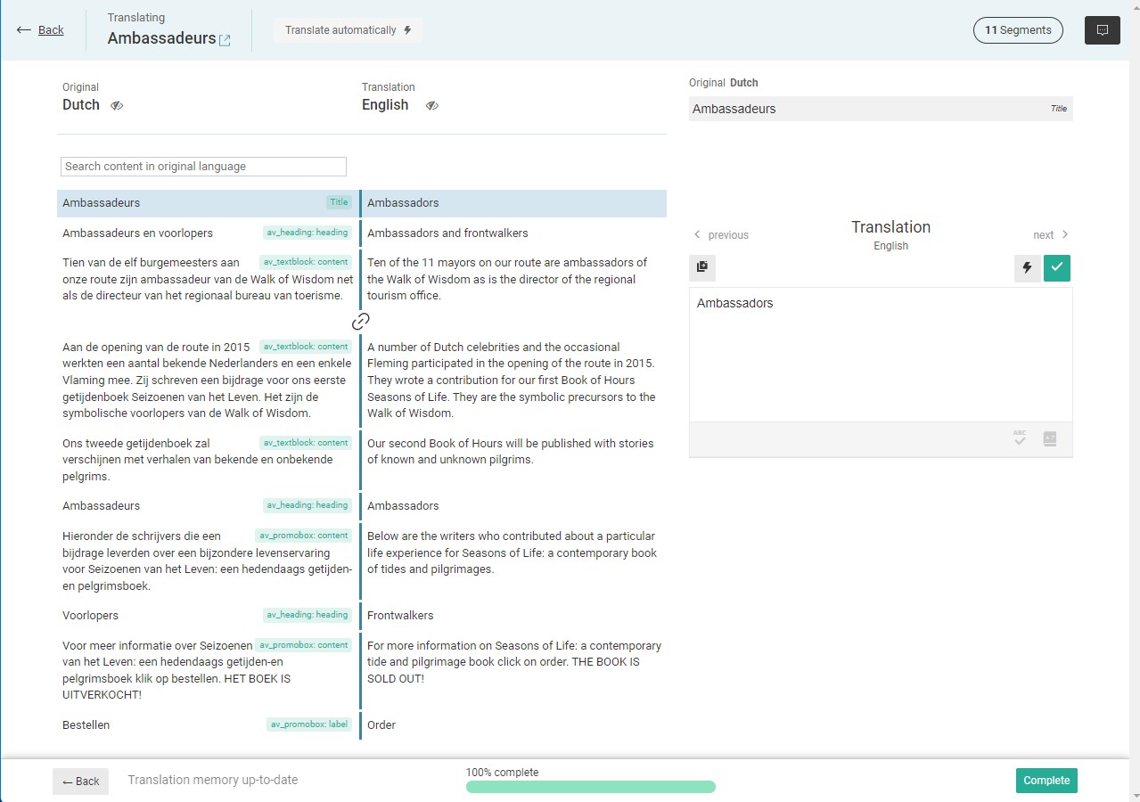

we want to use automatic translation to translate various pages and posts on walkofwisdom.org.
No, just trying to follow the steps in the interface.
On live, you can see the page hidden link, which in the advanced translation editor is translated from Dutch to English 100%, but only part of the translation is showing on the live site. I re-send the job to automatic translation from the translation management screen, but now it seems to be stuck on 'Refreshing translation status'.
Notably, the status icon in the wp admin bar has been showing 'Automatic translation status 0 / 2, 0%, less than 1 min remaining' for about a day, which doesn't seem right.

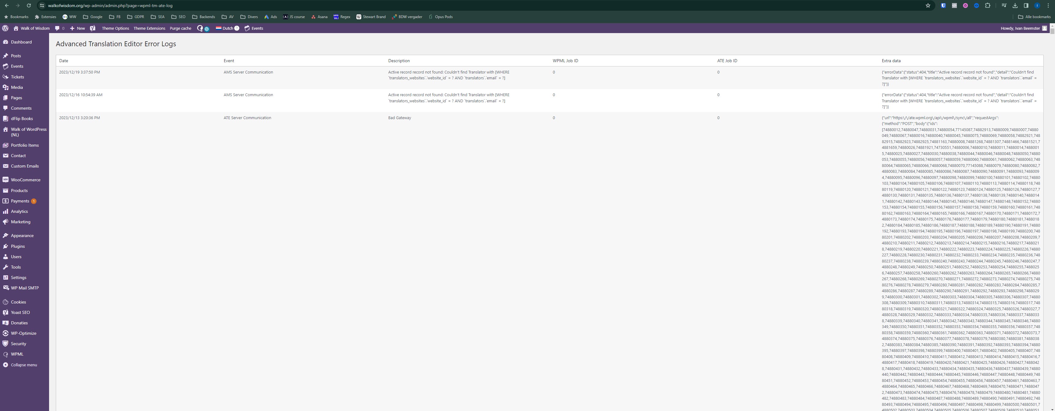

Hello Prosenjit, happy new year first of all! See attached the screenshot with the first portion of the error log. Nb the extra data for the third error (ATE Server Communication) is an extremely long list of IDs extending well beyond the screenshot.
An example of a post I try t translate but doesn't appear in full is the one I mentioned earlier, hidden link.

Hello Ivan,
Thank you for sharing the ATE Error log.
The most recent error in the Log indicates the "Active Record not Found" error, which mostly appears due to not configuring the "First Name" and "Last Name" for the Profile. Could you please ensure that the First name and Last name are added properly to your Profile(Users > Profile)? If you have a Translator, ensure that the profile of the Translator is also updated with the First name and last name.
In the Error log, I also noticed "Bad Gateway" error, which suggests that WPML access to your site is blocked by firewall. If firewall is configured in Server level, please reach out to your hosting administrator and ask them to whitelist the following domains:

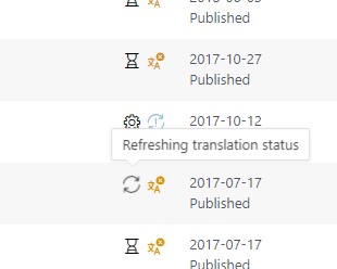

I noticed there still is a job pending, see attachment. Is there somehow we can clean this up?
Ivan

Please note that the change in the site ID is not a bug. Such change can occur as a result of resetting WPML or deleting the WPML database. In your specific situation, pinpointing the exact cause can be challenging. I hope you can understand.
Regarding the pending translation job, that job was created when the Automatic translation was enabled. To complete that job, please enable the Automatic translation(For all previous contents) by going to "WPML > Settings > Translation Mode" and hopefully, that job will be completed soon after that.
