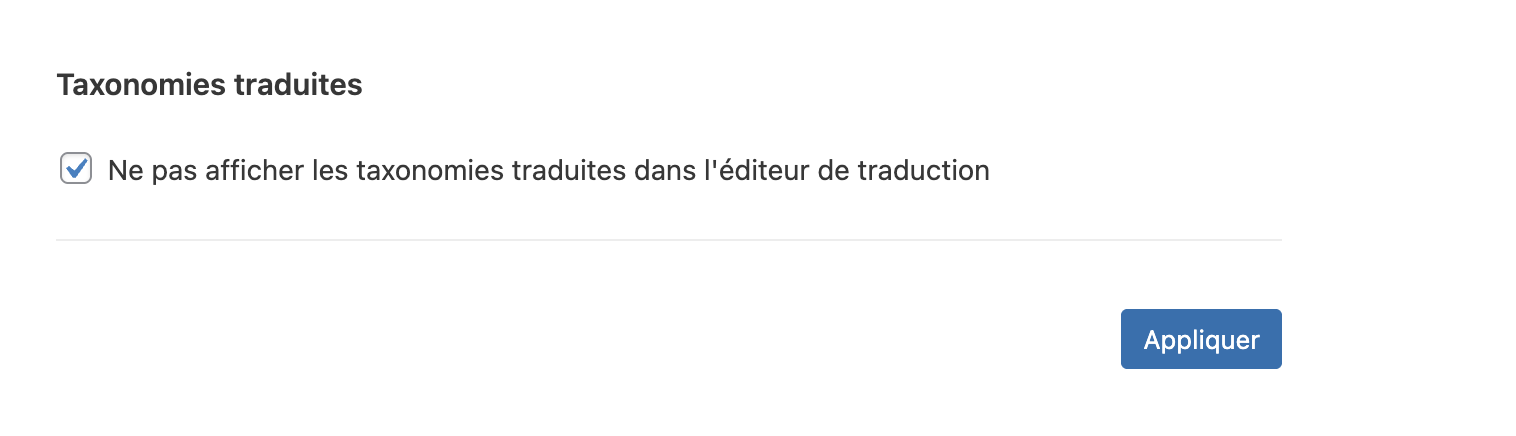

I made some new tests on my side
The problem appears as soon as I uncheck the checkbox in attachment
It's also responsible of the admin language changing randomly
As soon as I check this checkbox, everything goes back to normal
I have enable it for now, but I really need it because we work on the description of existing categories, and of course, we need to translate them
Waiting for your feedback

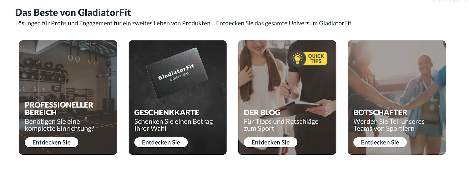

Can you also open a new ticket, i just noticed a problem since your last updates, the link from pictures, in element or, are not translated anymore
For example on the homepage, the section in attachment remains in French
I don't have problems with other links, it's only when we put a link on a picture
If you can check on the dev website what's the problem ?
Many thanks
