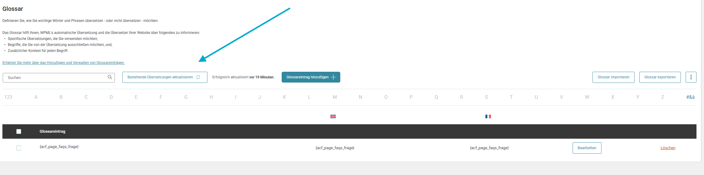

To prevent this dynamic ACF tag from being translated automatically in the future, please follow these steps:
- Go to "WPML → Translation Dashboard → Payments & Maintenance" and create a glossary entry by following this guide: https://wpml.org/documentation/translating-your-contents/advanced-translation-editor/how-to-create-and-manage-glossary-entries/#create-glossary-entries
- In the Default term field, add the full dynamic tag:
{acf_page_faqs_frage}
- In the Translation section for each language (e.g., French and English), enter the exact same term:
- Save the glossary entry, then click "Update Existing Translations" (as shown in the screenshot).
Once this is done, the translations will render the correct content instead of the dynamic tag. The dynamic tag itself will no longer be translated by automatic translation, and you won’t need to manually update each translation — the “Update Existing Translations” option will handle that for you.

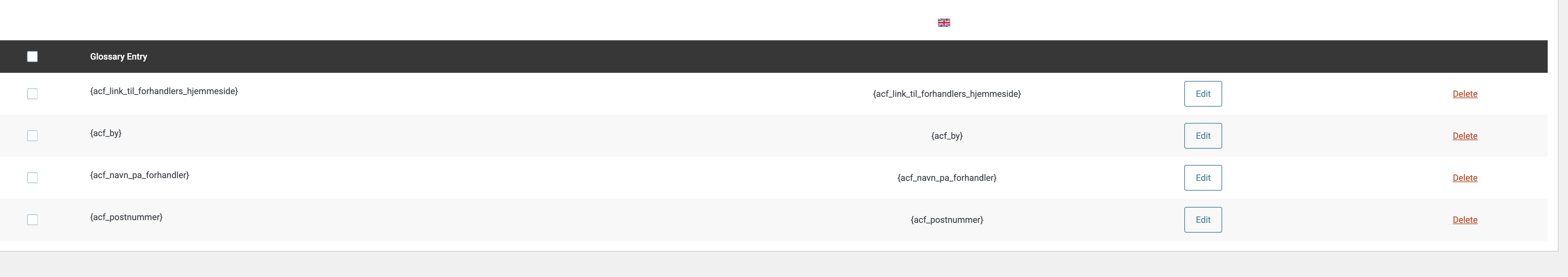

February 25, 2026 at 9:41 am #17850480
kasperG
Hi
I added in the tags, made a small change to the page and updated the translation. I did not solve the issue.
