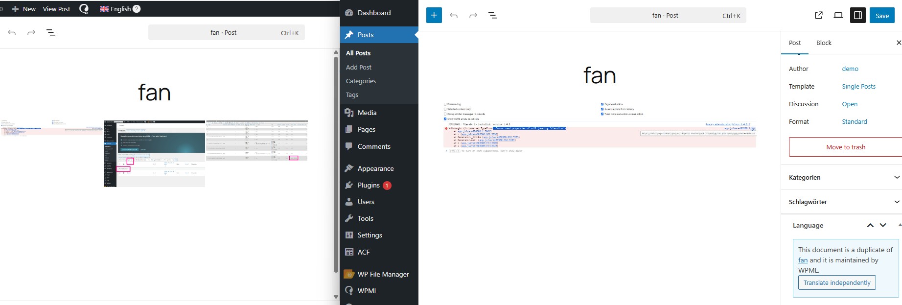

To confirm, we need to investigate why this duplicate is failing with the number of images when creating galleries using Fancybox. The gallery setup is defined here:
If this is correct, please let me know and I will escalate the case to our second-tier support team for further investigation.
January 13, 2026 at 7:31 am #17723662
christianc-8
Yes, I checked your new post and it shows the same issue I reported when using ACF custom gallery block.
Thanks for your support.
