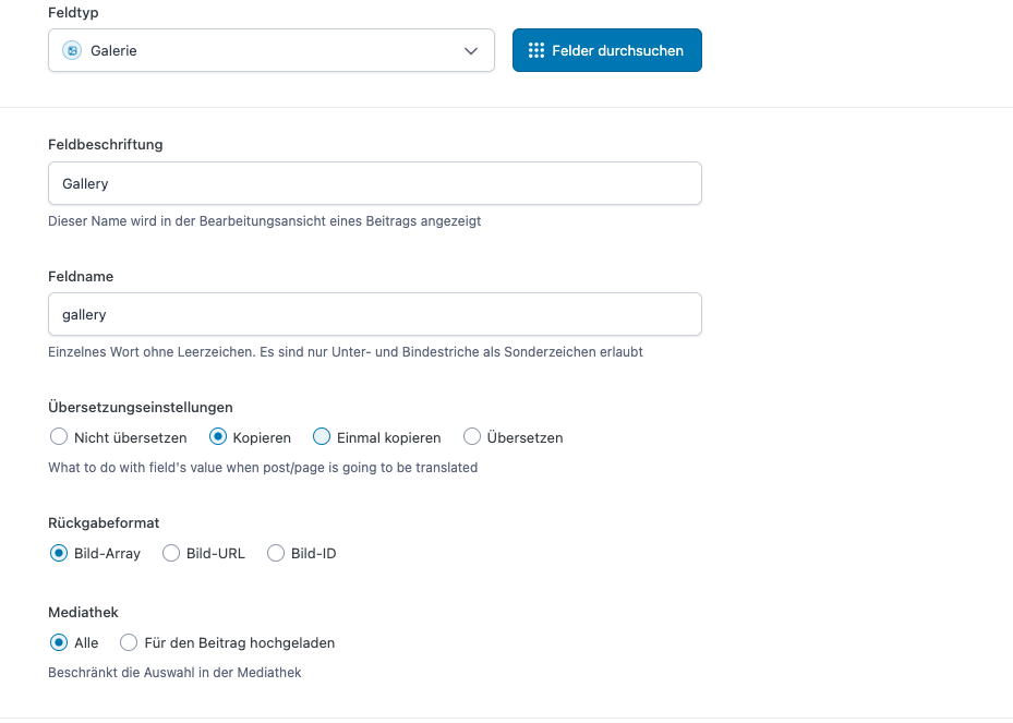

Ok thanks for checking. I don't think my client is using media translation but I'll double check with her. She is using an acf block for an image gallery in german. This acf block with the image gallery is set to copy. Therefore she is expecting the same caption in the other languages than in german.

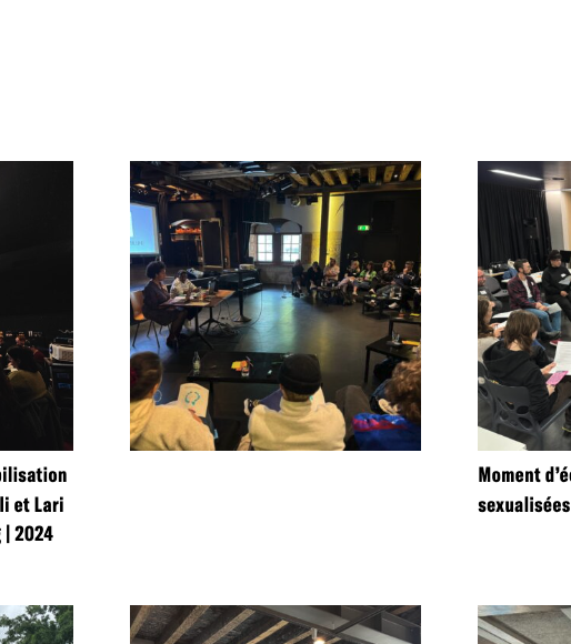

I did what you suggested on our staging site. I went to dashboard media, then to the secondary language and deleted all texts. I went to WPML->Settings->Media Translation, checked all the settings and clicked on start.
As you can see without luck, the caption of the third image stays empty: hidden link
What I also tried is changing something in the image caption of the first language to see whether its updating then in the other languages. Again with no luck.
Again what we'd like to achieve with this acf block image gallery: We want to only add the images and the captions in the first language. The acf setting is set to copy. We then want that all the images including the captions are synced in the other languages.
We've never used the media translations screen (and don't want to start using it).
