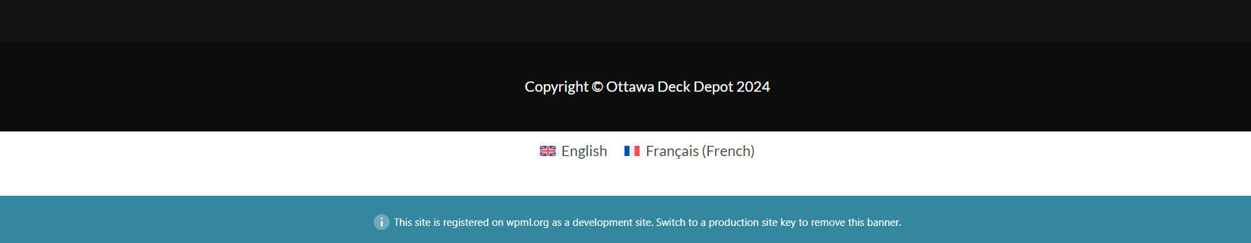

I am trying to: I used one temperory domain and use developer modes , now I change to permanent domain , I delete last key create new , but banner didn't remove from my website
Link to a page where the issue can be seen: all of footer in our website

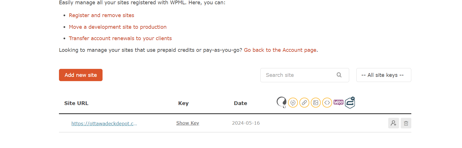

dominicT-10
Hello ,
I read that article thoroughly and also searched the internet. My problem is that I can't find the feature shown in the picture for changing the settings.
Please check the photo, and could you please change my key to product yourself? We have a visitor now, and they can see this ugly banner. Thanks.

Hi There,
Thank you for the update.
I understand your concern, but we cannot change the site keys for client sites from our end. This is something you need to do yourself.
From the screenshot, I see that the Gear icon is missing. To solve the issue you can now do the following:
- Click on the Trash icon(Screenshot: hidden link) and delete the site key.
- Once done, click on the "Add New Site" button and generate a new site key under Production site
- After that, Log in to your site’s admin and go to Plugins → Add New and click the Commercial tab. Click on "Unregister WPML from this site".
- Once the page refreshes, insert the newly generated key into the Site key field and press the "Register" button.
I hope it will help. Please feel free to let me know if you need further assistance in this matter. I will be happy to help.
