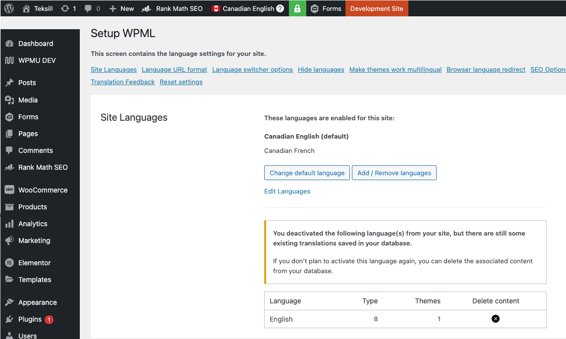

However, I still have an issue with removed English US language's content still being detected in wpml languages (see image) even after I clicked on Delete Content many times.
How do I get rid of those values ? I didn't add any custom post types to this website so I'm not sure why I see 8 types there.
What about the 1 theme value ?
Please provide a way to get rid of the deleted language's content.

Regarding the issue you're having with English content: Would you please try the following and check if that helps to solve the issue?
- Please go to "WPML > Support > Troubleshooting"
- Click on the Buttons marked in this screenshot: hidden link
- Once done, try to remove the deactivated language contents again from "WPML > Languages".
If the issue persists even after that, a closer inspection will be required to understand the root cause of the issue.

I installed a database plugin to examine the database. While checking, I found that approximately 13 posts, including Taxonomies, Types, and Themes, originally created in English, still exist in the Database. As soon as I delete the data from there, the issue immediately gets resolved.
Here's what I've done to fix the issue.
- Installed the PHPMYAdmin plugin on the site.
- Accessed the database using that tool and went to "wp_icl_translations" table
- Execute the following SQL Query which listed the data that were available in English.
 SELECT * FROM `wp_icl_translations` WHERE `language_code`='en';
- Selected all the data and removed them from the database as the English language is deactivated.
Please let me know if that helps or if you need further assistance in this matter. I will be happy to help.

November 21, 2023 at 9:56 pm #14891433
genevieveT-3
Thank you.
It solved the issue indeed. Now can you make this thread private as I share a password to access website on my comment from NOVEMBER 15, 2023 AT 3:07 PM ?
