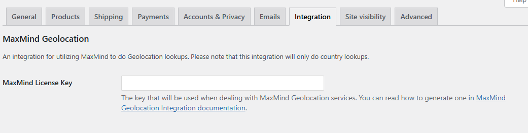

In woocommerce -> settings (1) -> payments (2)
I scrolled to bottom and removed the checkmark

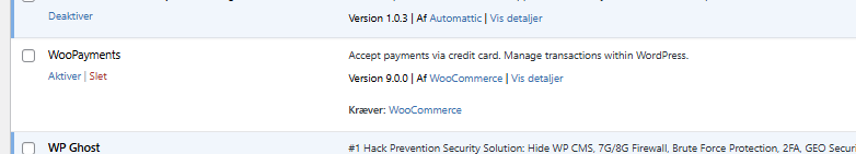

I have tested, and i found out that the plugin that causes the issue is: woopayments
If i disable that plugin the switch works.
i scrolled to bottom and removed the checkmark in screenshot 2.
That made some good things for my site 🙂
But it has not made tab (3) on screenshot go away. Shall the tab be visible or not ?
I thought that checkmark was a part of woocommerce, and had to be there to make multicurrency work.
