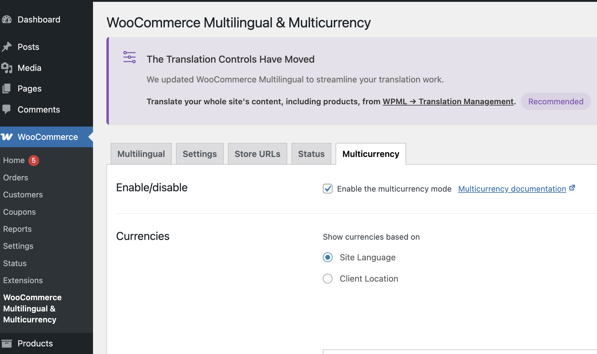

In your screenshots attached to a previous reply, you have a multi currency tab on the WooCommerce -> Settings screen. This is not where WooCommerce Multilingual settings are (the settings from our plugin, I mean). Ours can be found by going to WooCommerce -> WooCommerce Multilingual -> Multi Currency (screenshot attached).
It sounds like you may have another mutlicurrency plugin active on your site. If this is the case, please deacticate the other plugin and let's see if everything is working as expected. Please let me know the results.

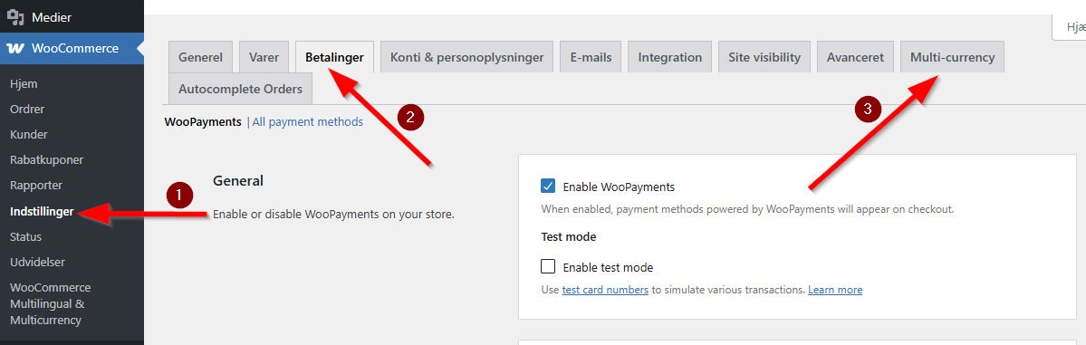

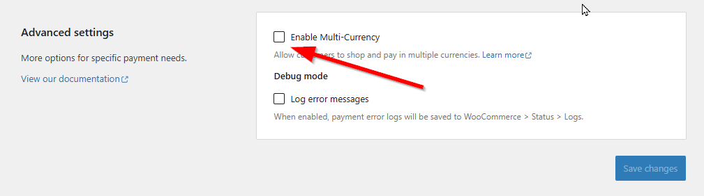

In woocommerce -> settings (1) -> payments (2)
i scrolled to bottom and removed the checkmark in screenshot 2.
That made some good things for my site 🙂
But it has not made tab (3) on screenshot go away. Shall the tab be visible or not ?
I thought that checkmark was a part of woocommerce, and had to be there to make multicurrency work.

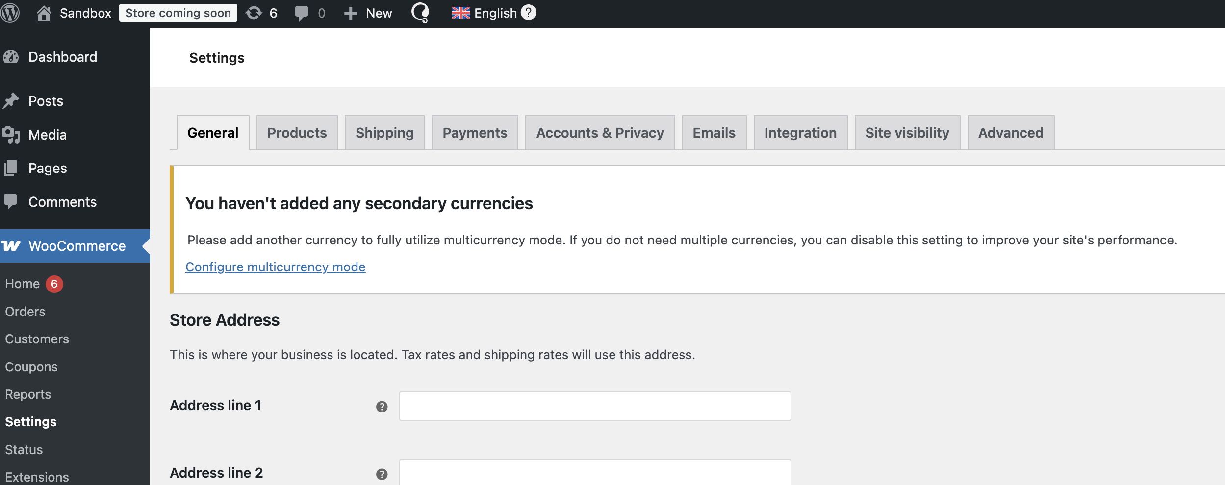

This is a test site with only WooCommerce and WPML plugins active. Feel free to use this link to login and look around to compare it to your site. Here's what I see in the WooCommerce Settings (screenshot attached).

Thank you Lauren.
Now my site also looks like yours (without the tab).

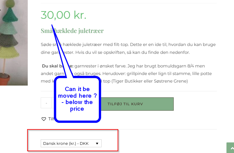

It it possible to move the currency switcher up just below the price ? (See screenshot)

Great, glad to hear that. By default the currency switcher is added below the add to cart button. If you wanted to move it into the woocommerce template, you would need to use custom code and edit the template using php to place it there. HEre's some documentation in case you would like to do that:
https://wpml.org/documentation/getting-started-guide/language-setup/language-switcher-options/adding-language-switchers-using-php-and-shortcodes/
