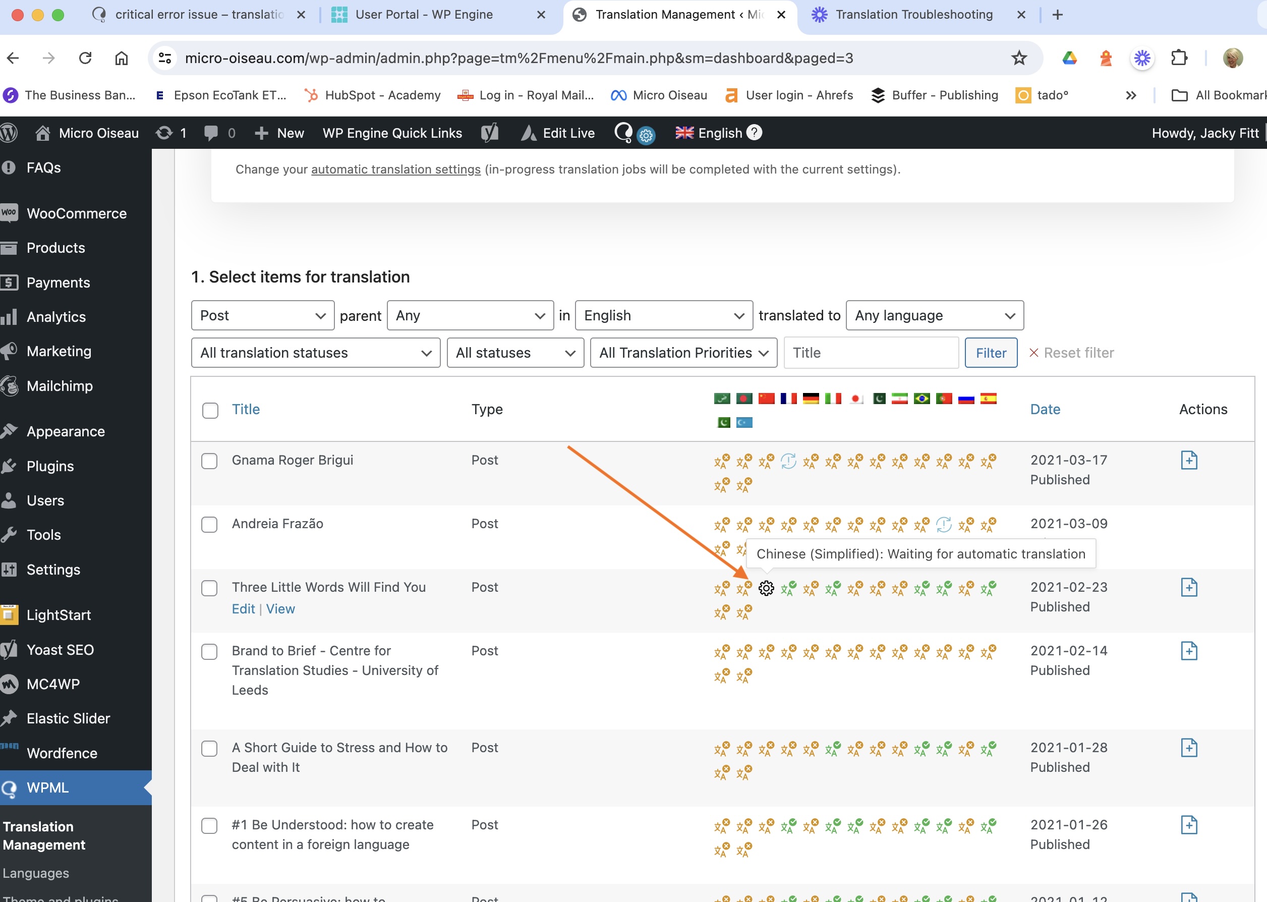

HI Kor, OK. So I will try to translate a small article post: 'Three Little Words Will Find You' in to Chinese using Automatic Translation. We usually use real translators for higher quality. They often report issues in that they cannot complete translations as the button says 'in progress' when they complete with 100% - so an indication that things are not smooth there either.
Here is the loom link of my method for asking for an automatic translation of the post into Chinese: hidden link
You will see that the translation didn't resolve in the 5 mins of the video. It is, in fact, 12 minutes later it became a cog - please see screen shot showing 'waiting for automatic translation' so it failed to translate.
Your thoughts please?

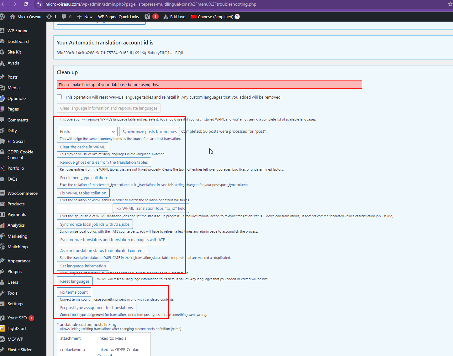

I've reviewed the issue you mentioned and taken the necessary steps to resolve it. I used the options available at hidden link , as shown in the attached screenshot, to synchronize the WPML options with the database.
I've successfully completed the Chinese language translation at hidden link, and everything should be functioning correctly now. Could you try translating another post now and see if it helps?
June 28, 2024 at 3:06 pm #15852902
nedH
Thanks for the screen shot and the instruction - do I need to go through and reset every button on the screen shot and do this for every class in the synchronise posts taxonomies drop down?
I will back up as instructed but I just want to ensure I am only doing the absolutely necessary resets as I am concerned that we lose content as has happened in the past. It feels like the is a very delicate eco-system that breaks very easily.
Thanks for your help
June 28, 2024 at 3:08 pm #15852905
Thanks for your reply.
You can use this option when the automatic translation gets stuck again. But usually, that rarely happens. But please let me know how it goes.
