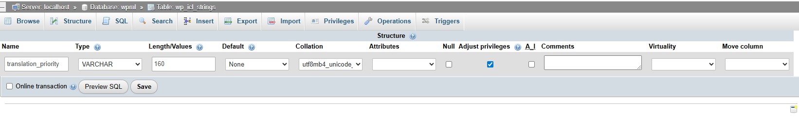

Can you check if there is a translation_priority column within wp_icl_strings table? If not, can you add it?

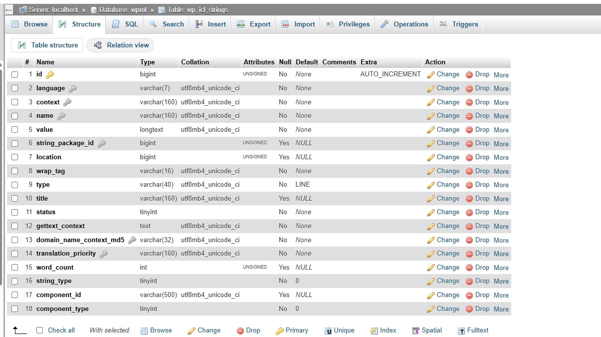

I already have the column in the table. The value in that column is "optional" in all registers.
What else could I check?

In this case, it’s possible that this is a stuck false-positive notification.
Please go to
wp-admin/admin.php?page=sitepress-multilingual-cms/menu/troubleshooting.php
and click “Remove all messages and notifications.”
If it doesn't help, try removing the wpml_notices and icl_admin_messages keys from the wp_options table (make sure to create a backup first).
After doing this, does the error warning still appear?

Thanks!
It worked, the message has been removed.
