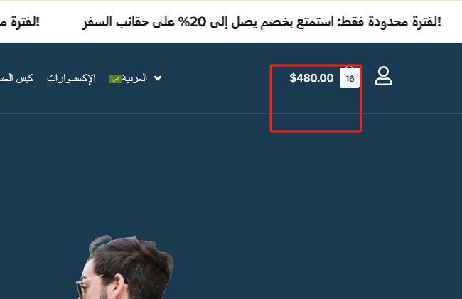

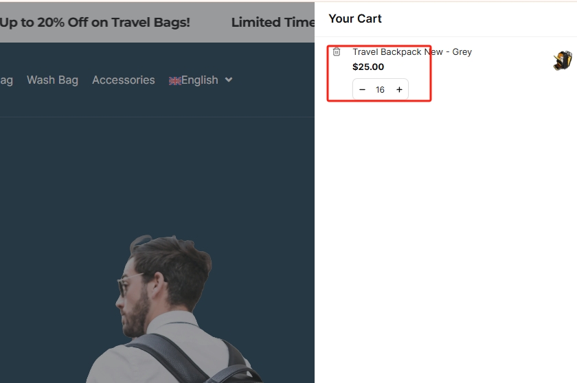

I am working on a website developed with WooCommerce and the plugin Wholesale for WooCommerce. I have set up wholesale pricing for products on this site, which requires users to register and log in to purchase at the wholesale price. The website is multilingual, and I have configured the settings in the backend to be Translatable or copy.
In English, the discounted price appears correctly after logging in as a wholesaler and adding a product to the cart. However, when switching to other languages, the discounted price does not work. I have tried adjusting settings, but the issue persists.
Why is the discounted price not showing in other languages?
What settings should I check to ensure the wholesale price works in all languages?

I have duplicate the issue
the is the products on the demo site,
I added a user as a wholesaler, the login name and pw is
testwholesale
MdhVg%DzSeP$lowC$2h6mYzH
I added the products to the cart, the the price in the cart stay the same.
There is no issue on this demo site.
But on my live site, when I login as the wholesaaler role, the multilingual price will not apply the discount price.
you can login by below informatio
You can login and check. because this live site already backup on server, so you can directly work on it.

I don't see the issue while logedin, the screenshot you provided earlier is from two sections and one is per piece and another is total of 16, so both are correct.
I see $30 for products in both languages, am I missing something here, what should be the expected value.
Look forward to your reply.

michaelS-282
Hello Shekhar Bhandari,
if you added the 20 products from English, the discount will apply.
But if we switch the lanugage from English to Arabic or spannish, the product price disocunt not applyed in the cart.
You can check
