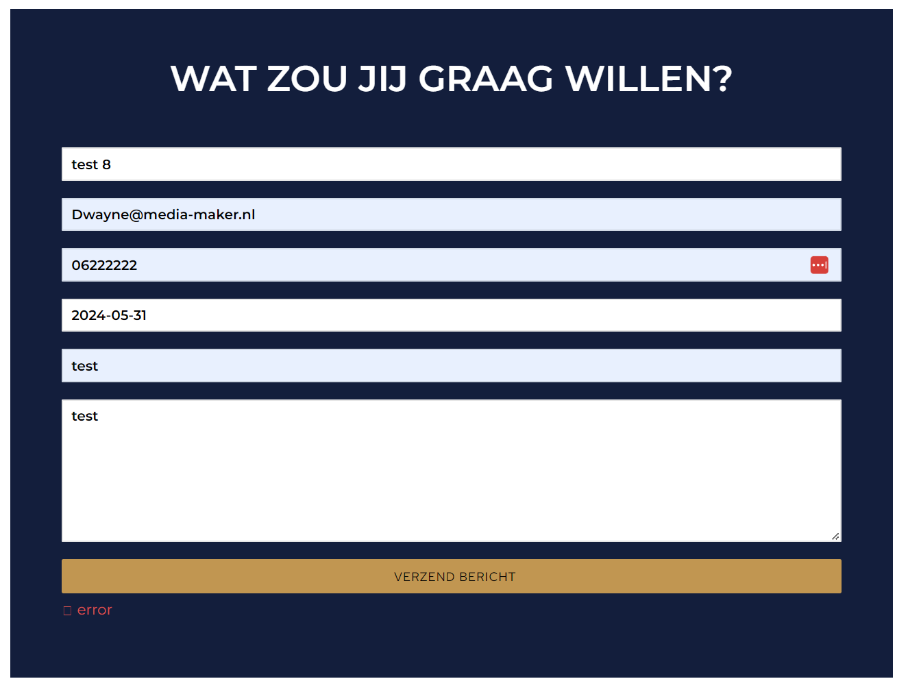

dwaynev
I am trying to: Remove the "error" text that the elementor form produces when users succesfully submit a translated contact form with elementor form.
This leads to users submitting multiple forms.
When I tried to fix this with a redirect after the submission, this also did not work.
So after the form submission a redirect will take place on the non translated site.
But when I do the same thing on the translated site (with correct string translations) it will not redirect.
I expected to see: After the submission of the contact form, this message "Het formulier is succesvol verzonden." (which means "The form was sent successfully.")
Instead, I got: "Error"
May 27, 2024 at 9:47 am #15673057
Osama Mersal
WPML Supporter since 02/2020
Please edit the translated page using Elementor and check the form settings.
If the translated page's form has the correct strings but shows an error on the front end, please share screenshots of the form settings.
Osama

May 31, 2024 at 10:14 am #15691605
Osama Mersal
Hi Dwayne,
Thanks for the access details. Please check the translated contact page. (hidden link)
I edited the translated page using Elementor, changed the redirection URL, and tested the form.
The form works as expected. If the issue persists, please let me know the steps to reproduce it.
Osama
