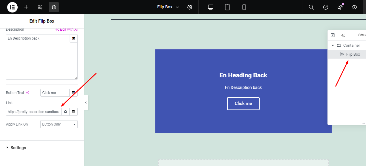

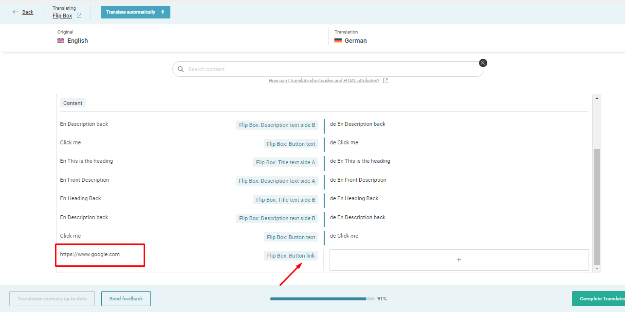

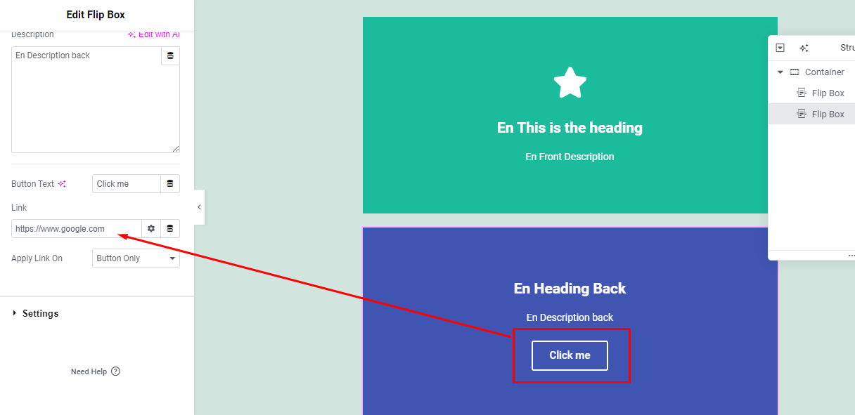

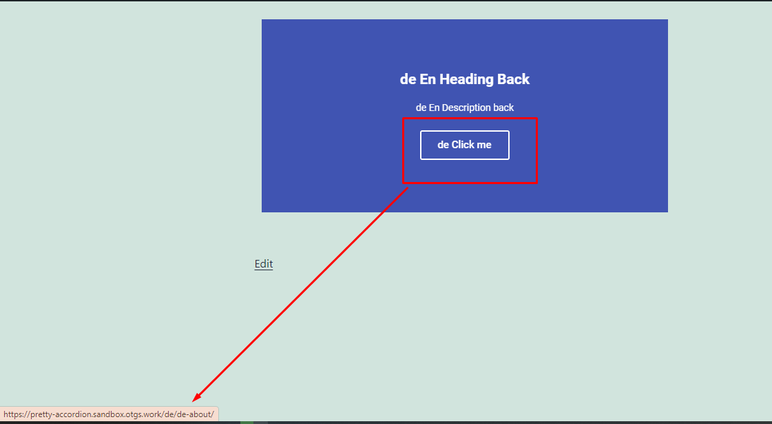

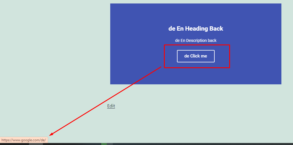

Thank you for contacting WPML Support. I’ve tried to replicate this issue at fresh WP site by following the below steps:
1. Installed the Elementor and Elementor Pro plugins.
2. Created a new page in the default language and inserted the Elementor Pro Filip Box element.
3. Added the internal and external link to the button.
4. Tried to translate it using Advanced Translation Editor and I’m able to translate the external URL and the internal URL translated automatically as you can see in the attached screenshots.

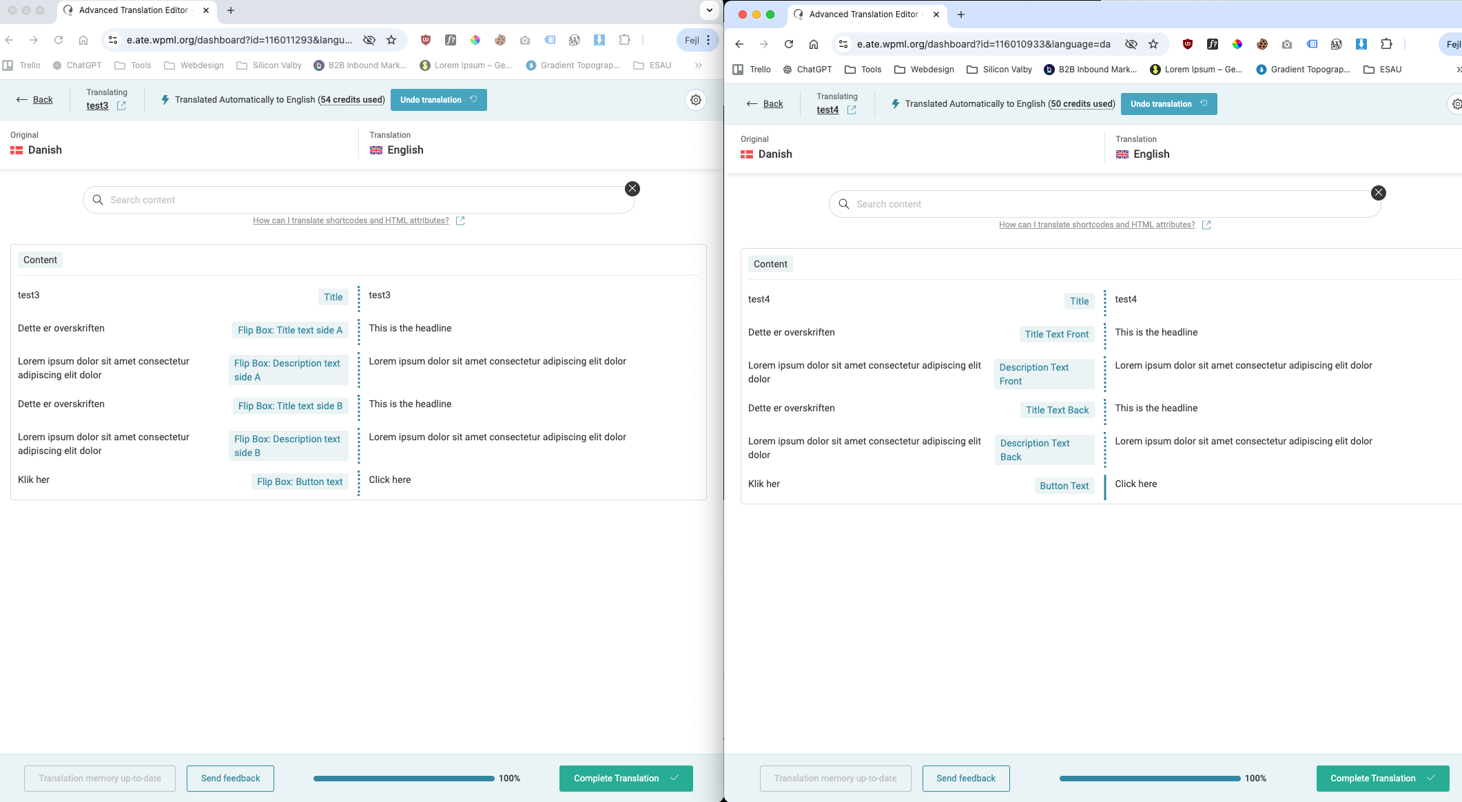

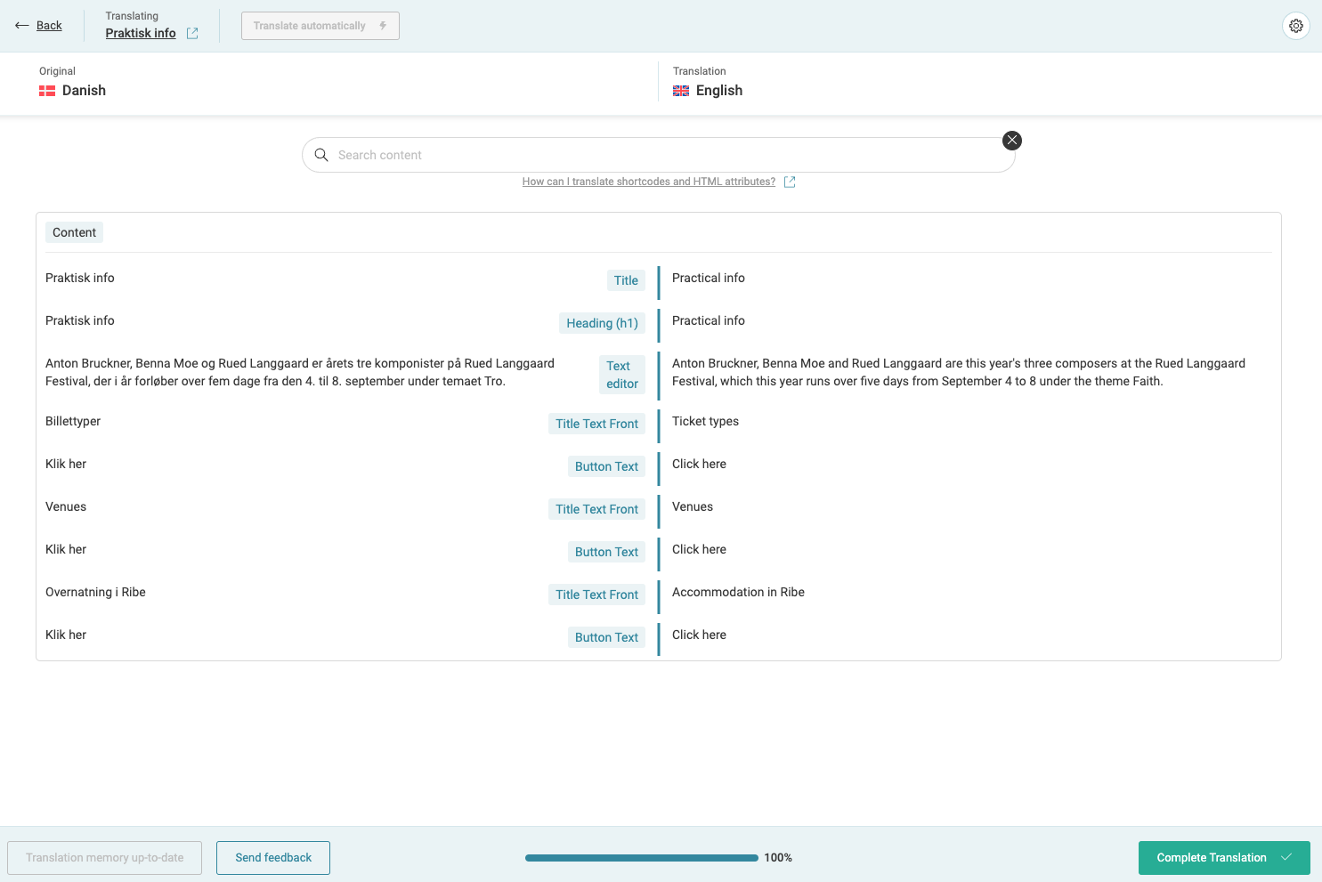

I can see that, it seems to work with your setup. I just tried to add a flip box on another site that I also manage, and I can’t see the Button link there either… could it be a checkbox I need to enable somewhere?
I have attached a ss of the other page next to the page I’m working on.

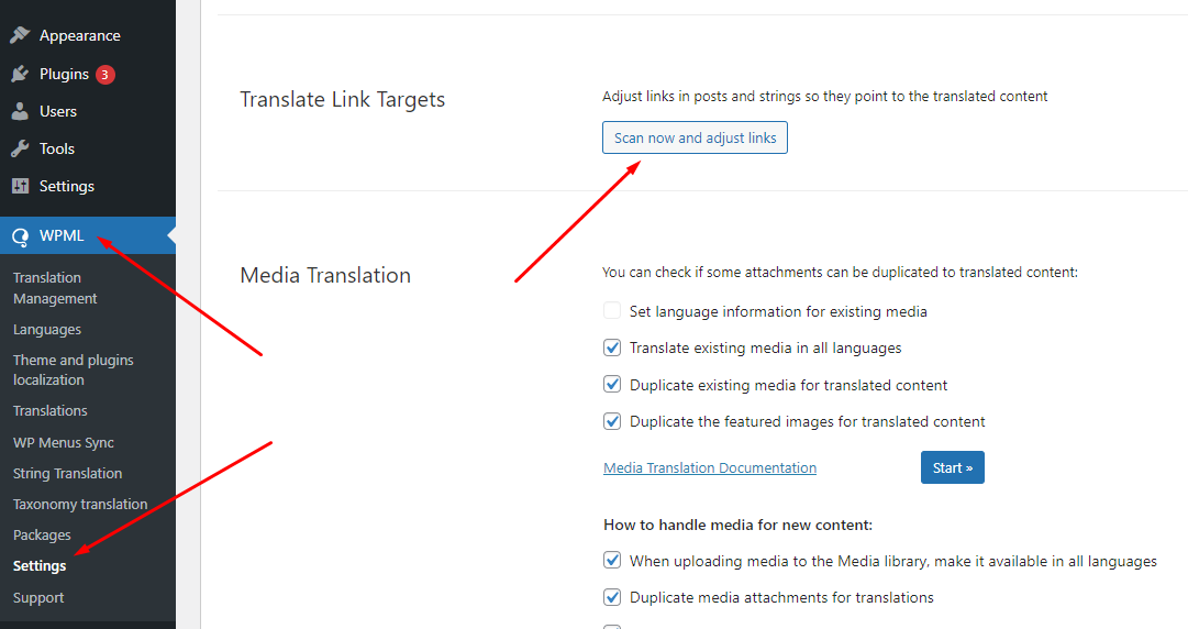

Thanks for the additional details. If you are facing issues in translating the internal links then please try to follow the below steps:
1. Take a backup of your site first for safety reasons.
2. Go to the WPML >> Settings page and press the “Scan now and adjust links” button(Screenshot attached).
3. Re-save the Permalinks from the Settings >> Permalinks page by pressing the “Save Changes” button.
4. Clear all sorts of site/server/CDN cache and see if this resolves the issue.
If the issue is arising in external links or the above steps don’t help, please provide temporary access (WP-Admin and FTP Login info) to your site (preferably staging site), so that I can look into your setup and debug the issue.

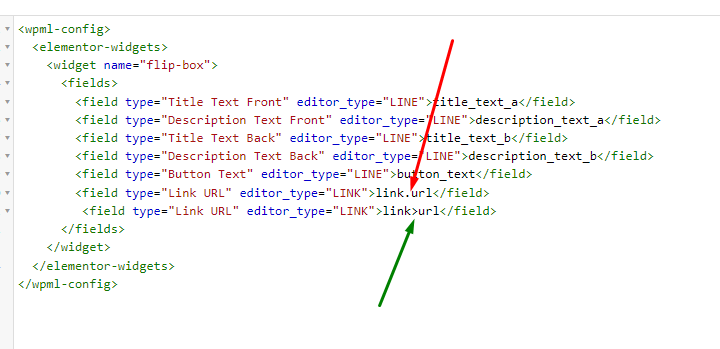

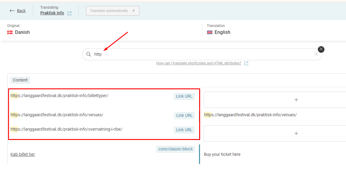

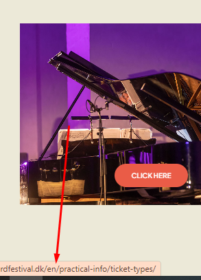

Thanks for providing the login details. I followed the below steps:
1. Set the _elementor_data field to it’s default value “Copy Once” from WPML >> Settings > Custom Fields Translation section.
2. Corrected the XML from WPML >> Settings > Custom XML Configuration section by replacing this code:
<field type="Link URL" editor_type="LINK">link.url</field>
With:
<field type="Link URL" editor_type="LINK">link>url</field>
3. Made a small change in the default language page title, and opened the English language page in ATE and the links were available for translation as you can see in the attached screenshot.
I added the links translation for English language page and it works correctly at frontend.
Could you please check and confirm?
Thank you for your cooperation and patience

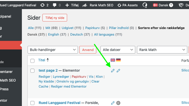

October 18, 2024 at 7:41 am #16302985
kimR-3

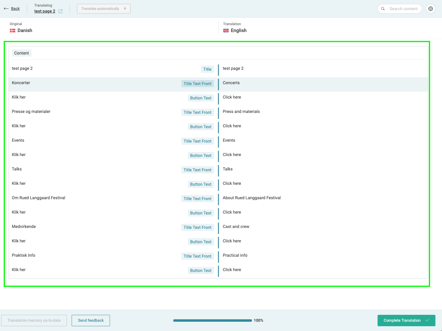

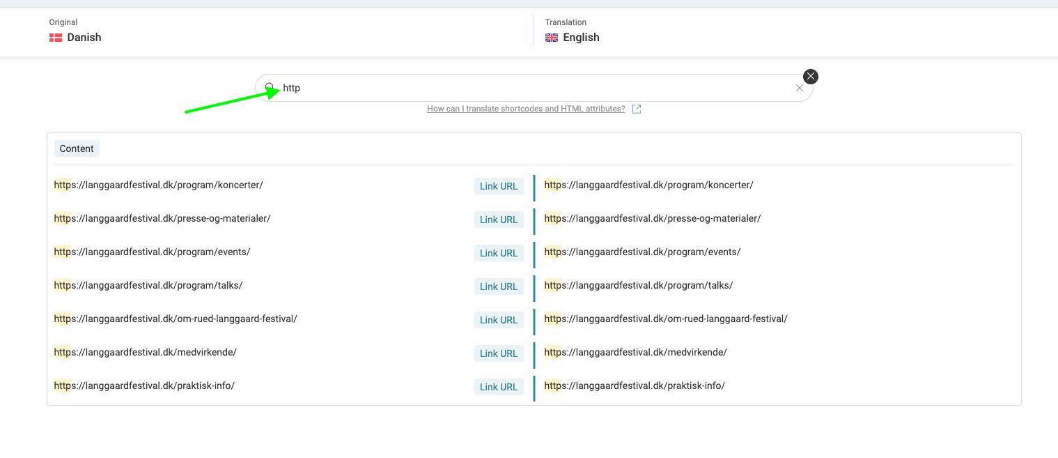

Unfortunately, I still have the problem. I created a new page (test page 2) and inserted the section with 8 flip boxes. When I open ATE, I can’t see any links unless I search for them. I can change them manually, but the automatic translation doesn’t translate the URL correctly. See the attached screenshot.
Am I doing something wrong?
October 20, 2024 at 5:45 am #16307898
Noman
WPML Supporter since 06/2016

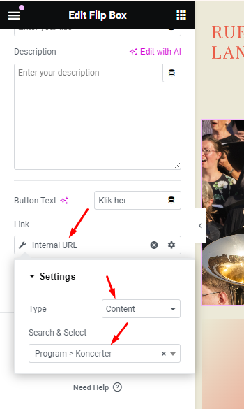

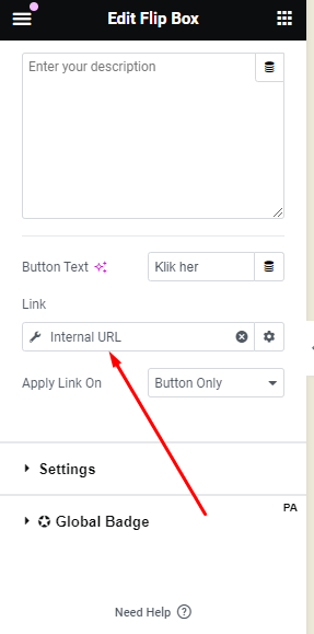

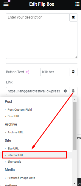

Sorry for the delay, I was off during the weekend (Friday-Saturday). It’s an expected behavior to search the URL in Advanced Translation Editor and translate them manually if they are available in ATE.

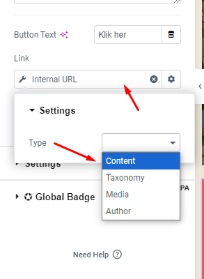

To translate Internal URL’s automatically on your site, I followed the below steps:
1. Removed the XML from WPML >> Settings > Custom XML Configuration section as the Flip Box widget is already WPML Translation Editor compatible.
2. Opened the default language test page 2 in Elementor page builder.
3. Click on the “Dynamic Tags” option as you can see in the attached screenshot.
4. Choose the "Internal URL” option.
5. Click on the “Internal URL” and choose the “Content” option from Type dropdown.
6. Type the page URL of the page in the search input box and choose the page to use for link.
7. Updated the page in Elementor page builder.
8. Updated the page in default WP Editor.
And it automatically shows the correct translation at frontend without adding them manually. Here is a video of the above steps: hidden link
Could you please try to follow these steps for Internal URL’s and see if this resolves the issue.
