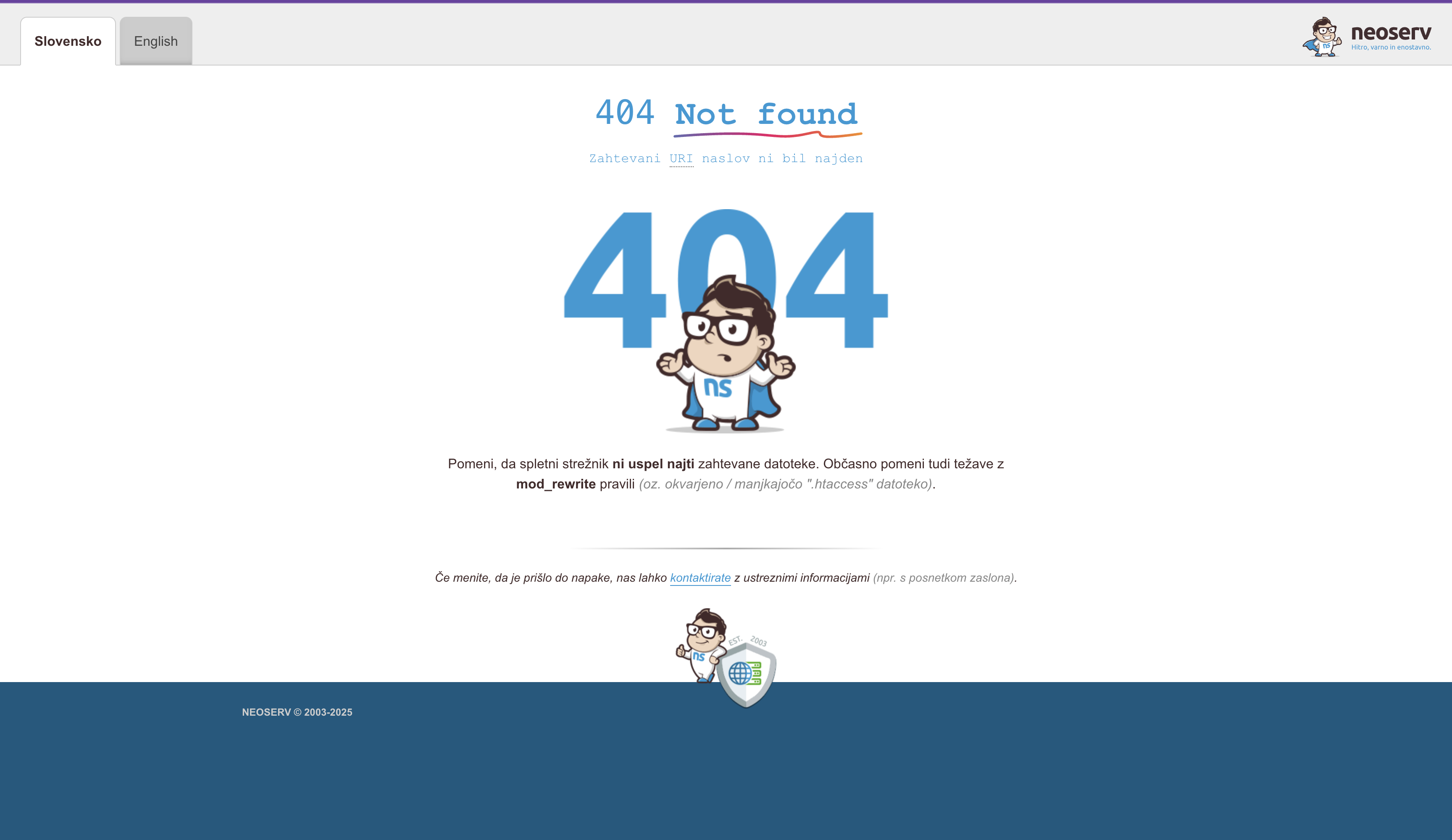

3. There is one more issue we keep seeing on most admin pages:
load-scripts.php?c=1&load%5Bchunk_0%5D=jquery-core,jquery-migrate,wp-hooks&ver=6.9:5
JQMIGRATE: Migrate is installed, version 3.4.1
dashboard.js?ver=485900:2
GET hidden link 404 (Not Found)
It throws a 404 on the localization file and keeps repeating in the console. Can you check if this file is missing on your side or if something needs to be updated in the plugin?
