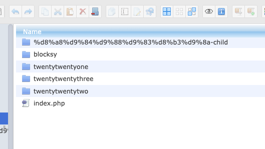

I have an answer from the second tier support:
The problem is the child theme folder.
It is "%d8%a8%d9%84%d9%88%d9%83%d8%b3%d9%8a-child" and this creates the problem because we try to parse a path which contains 14 arguments that we expect them to be filled.
Please rename the name of the child theme folder to a latin normal characters.
Thanks.
November 5, 2023 at 2:58 pm #14733361
raymonts
I'm not able to enter themes?
Can you change it?
also how this work in dev site and not work for live site?
November 6, 2023 at 6:17 am #14734679
Christopher Amirian
WPML Supporter since 07/2020
You can enter themes what do you mean by that?
The issue is the name of the theme which is not in latin words. You should change the name of the theme to normal one.
Access your website files. Go to wp-content/themes/ and you will see what I mean (Check the screenshot)
The name of folder should be in latin not Arabic characters (which then turns into those characters as some servers can not handle non latin folder names).
Please backup your website, change the folder name to for example: blocksy-child
Then go back to Appearance > Themes and activate your child theme again and it should work
Thanks.
