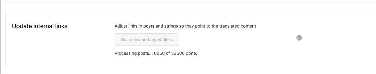

I am trying to use the 'Update internal links' feature in the WPML > Settings page to fix links in translated posts that sometimes still point to the original English page, even though a translated alternative exists. We are using batch translation towards 3 languages, creating a lot of translated content. Since we have many posts (33600), the process usually stops or breaks, or I forget about it and move to another page, requiring me to start over. I would like this functionality to work as a background process that does not rely on the admin user keeping the WP Admin page open. Link to a page where the issue can be seen: hidden link

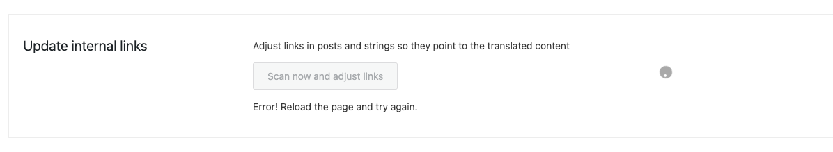

Instead of completing the process, it broke at about 19600 with the message: 'Error! Reload the page and try again.'
Can the 'Update internal links' feature be modified to run as a background process?
How can I ensure the process completes without breaking or requiring the admin page to remain open?
