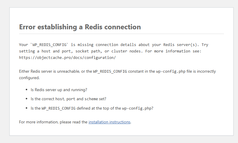

Unfortunately, when I add the code you mentioned, I'm getting the error in the screenshot.
Is this something you are familiar with or something I need to speak with my hosting company?

The error message you're seeing, "Error establishing a Redis connection", is related to Redis server configuration, which is outside the scope of WPML support. Redis is a caching layer typically managed at the server level.
Since you are using Object Cache Pro, which is a premium Redis object caching plugin, it requires a working Redis server in the background.
I recommend contacting your hosting provider or server administrator to:
* Confirm that the Redis server is running and reachable.
* Ensure the Redis connection details are correctly defined in your `wp-config.php` file under `WP_REDIS_CONFIG`.

The hosting support helped me add the code you mentioned, and the error is not showing anymore.
Thank you for the help with this.
