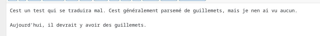

For the last two translations (likely because of an update), my French translations are missing single quotes.
Here is the English source I tried today: This is a test that will translate poorly. This is usually sprinkled with quotes but I have seen none.
Here is the French translation: Cest un test qui se traduira mal. Cest généralement parsemé de guillemets, mais je nen ai vu aucun.
* This text is missing 3 singles (Cest->C'est (twice) and nen -> n'en)
The weird thing is that ATE is showing the quotes but they disappear as soon as I am in WordPress. Even if I look at the code editor, there does not seem to be anything there.

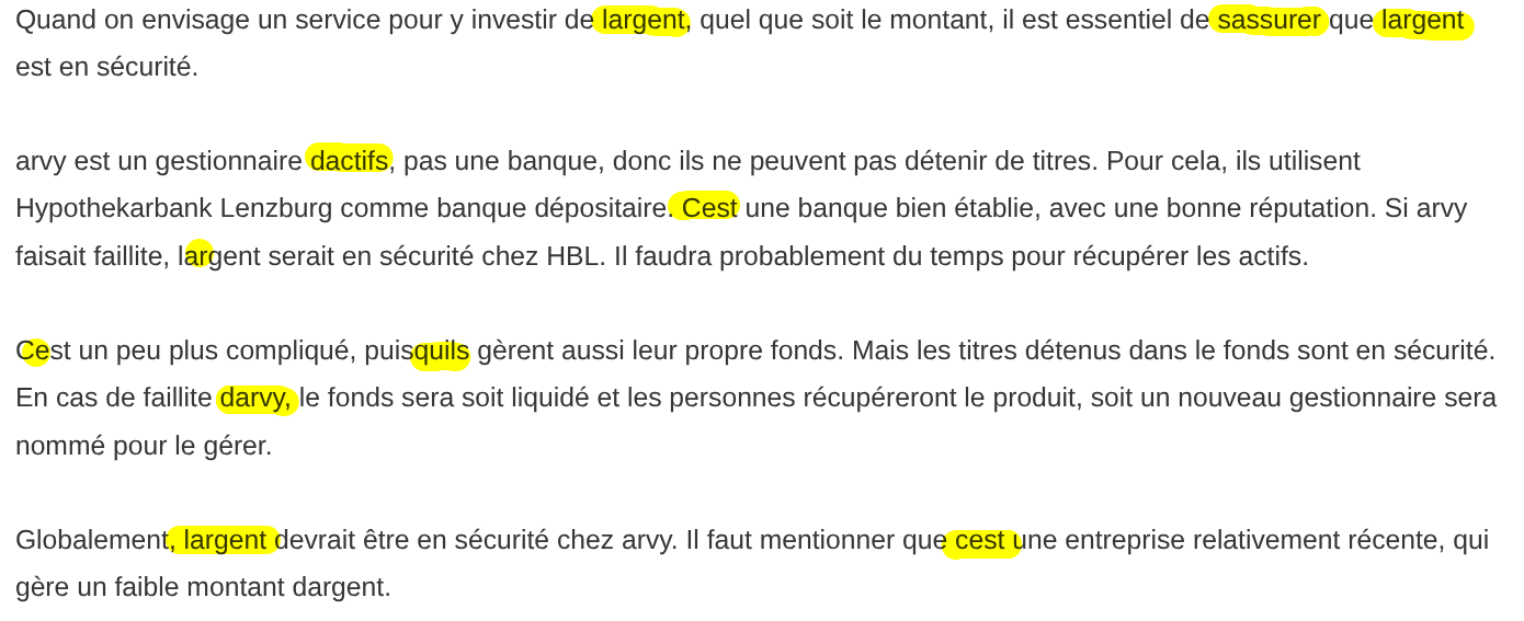

March 25, 2026 at 6:12 am #17924471
baptisteW-2
I don't understand.
When I created it, the 3 apostrophes were missing.
Now, I see the same thing you do
I did a new test page: hidden link
In my screenshot I can see many missing quotes.
