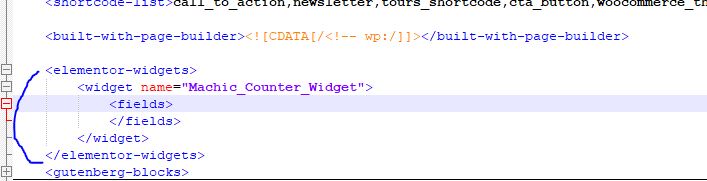

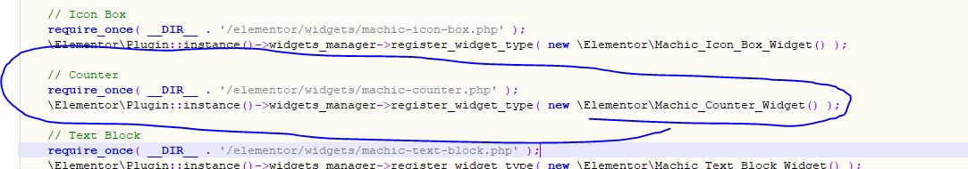

i tried to register widget but i dont know if it right or not !
test 2 jpg ( from wpml-config.xml )
test 3 jpg ( from machic theme )

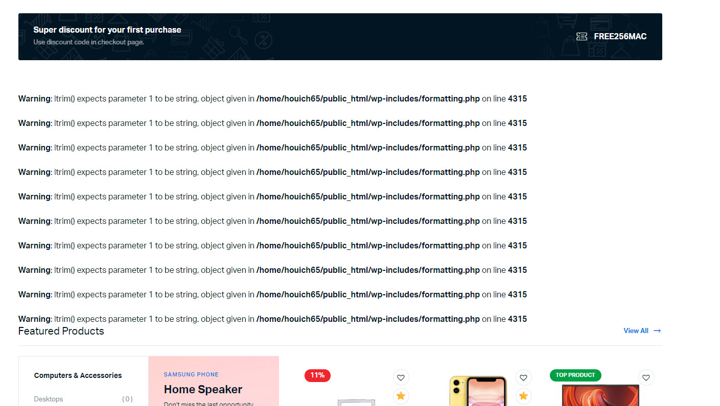

2) There are some warnings on the home page. Would you please check them too? (Kindly check the attached screenshot)

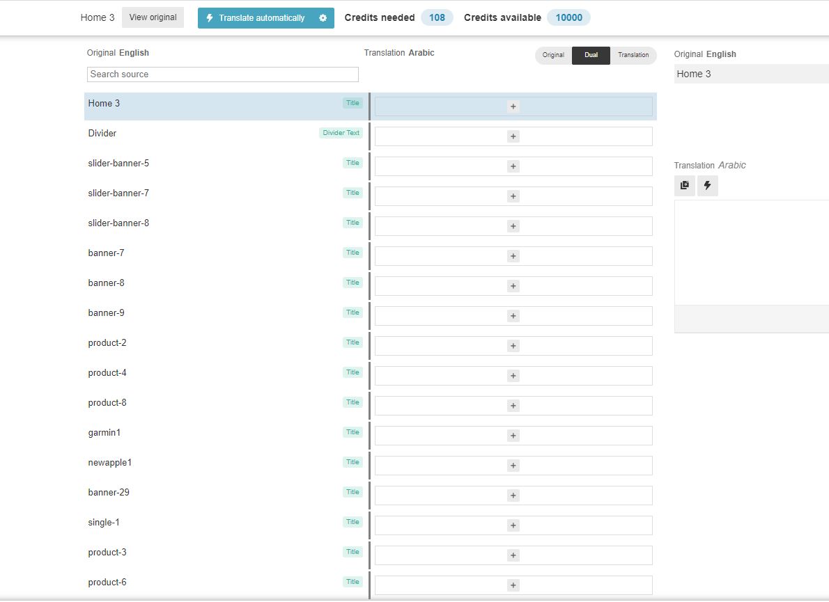

i still dont know why you couldnt login as from my end everything looks fine
when i start translating home 3 it doesn't show me the text it show me only id of element ( or div or i dont know what exactly its referring too ) as it showing the first picture i sent

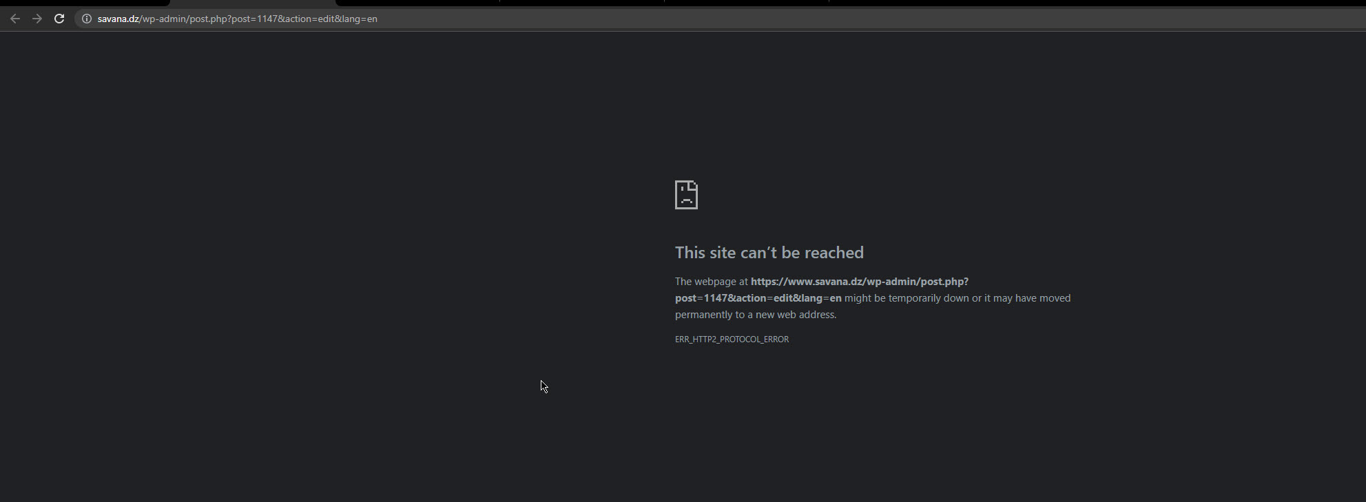

I still can't log in to the dashboard. (Kindly check the attached screenshot)
I think it's related to your server firewall. If you can't fix this, please upload your theme to the sandbox without activation to check if we can replicate the issue.

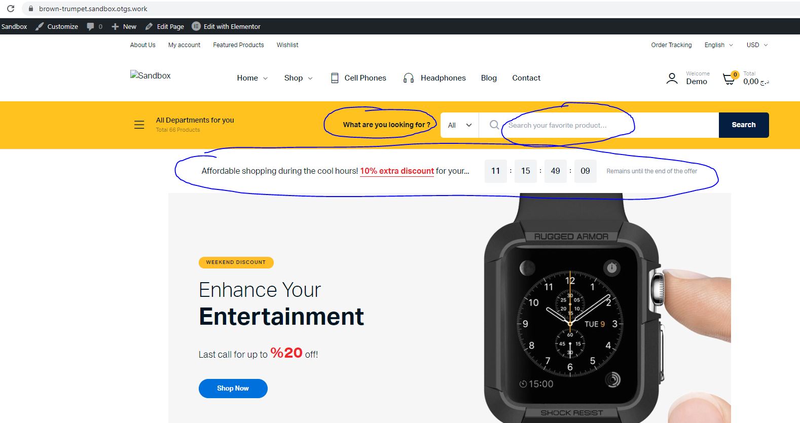

but for now
did you translate words from the home3 page ? and it did work ?
i want to see if it succeed translating the words in the picture ( test 4 ) cuz thats my problem i couldnt find them when i go to home3 and click the button to translate

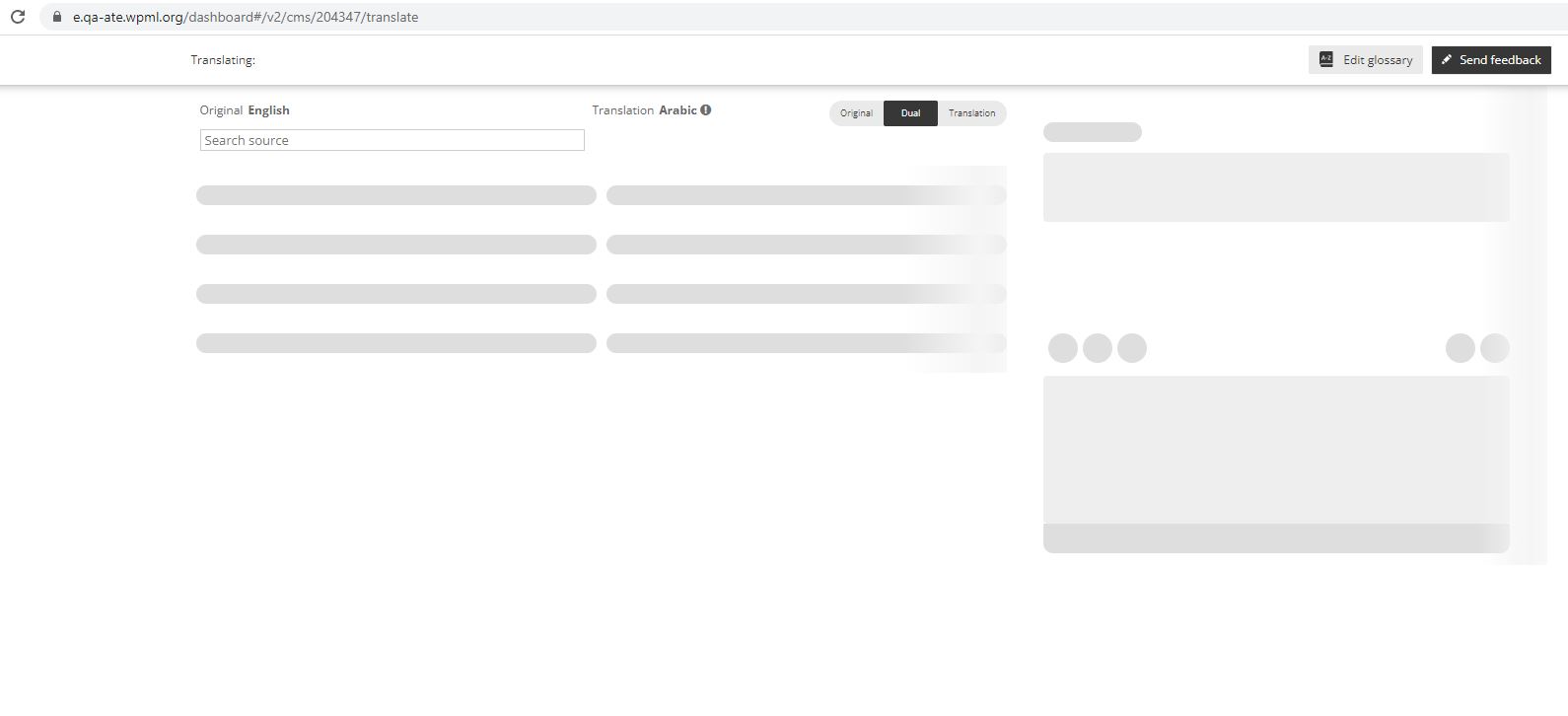

- in the sandbox it get stuck like ( test 5 jpg )

Thanks for the update. I've checked the strings you mentioned. For the header strings, please try the following steps:
1- Go to WPML-> Theme and plugins localization, select your theme/plugin, and scan
2- Go to WPML-> String Translation
3- Scroll down and click on the "Translate texts in admin screens »" link
4- Search for the needed strings
5- Select the strings
6- Click on the "Add to String Translation" button
7- Then click on "« Return to String Translation" link
8- Translate the strings, clear the cache, and check the front end
Kindly check our guide to know more about translating texts in admin screens. (https://wpml.org/documentation/getting-started-guide/string-translation/finding-strings-that-dont-appear-on-the-string-translation-page/)
2) The counter widget is created by the theme and it's not registered for translation, so I've registered it by adding the following code to WPML-> Settings-> Custom XML.
<wpml-config>
    <elementor-widgets>
        <widget name="machic-counter">
            <conditions>
                <condition key="widgetType">machic-counter</condition>
            </conditions>
            <fields>
                <field>Due Date</field>
                <field>desc</field>
              <field>subtitle</field>
            </fields>
        </widget>
    </elementor-widgets>
</wpml-config>
After that, update the page using Elementor and try to translate it.
I've registered this widget on the sandbox and created a test page to check it. Would you please check this page and try to re-translate it? (hidden link)
