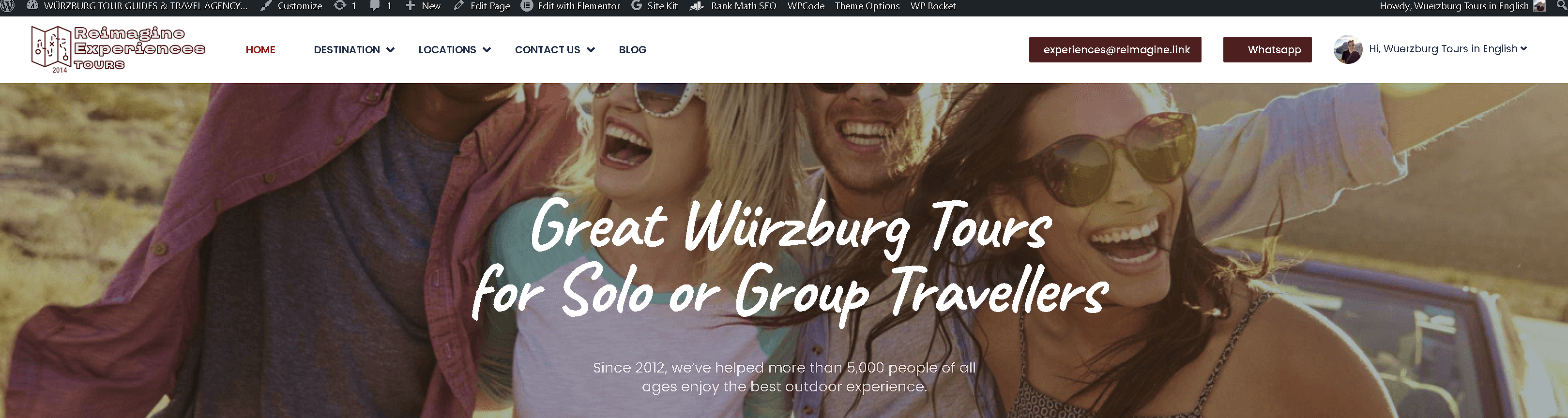

I am trying to activate WPML on my site hidden link.

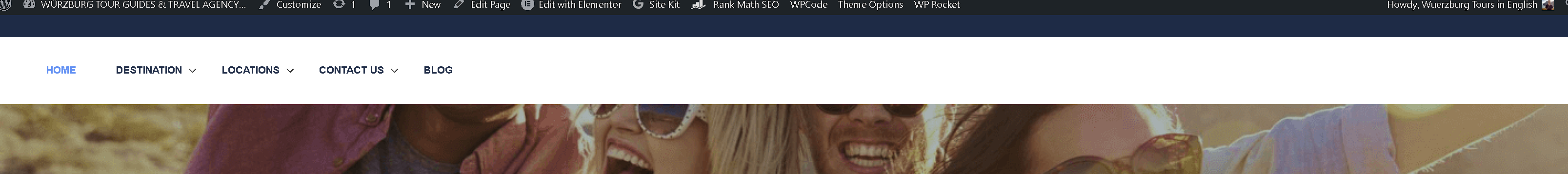

The header section disappears when I activate WPML.
I use TravelerVersion: 3.2
By Shinetheme
This is compatable with WMPL
I use the elementor version

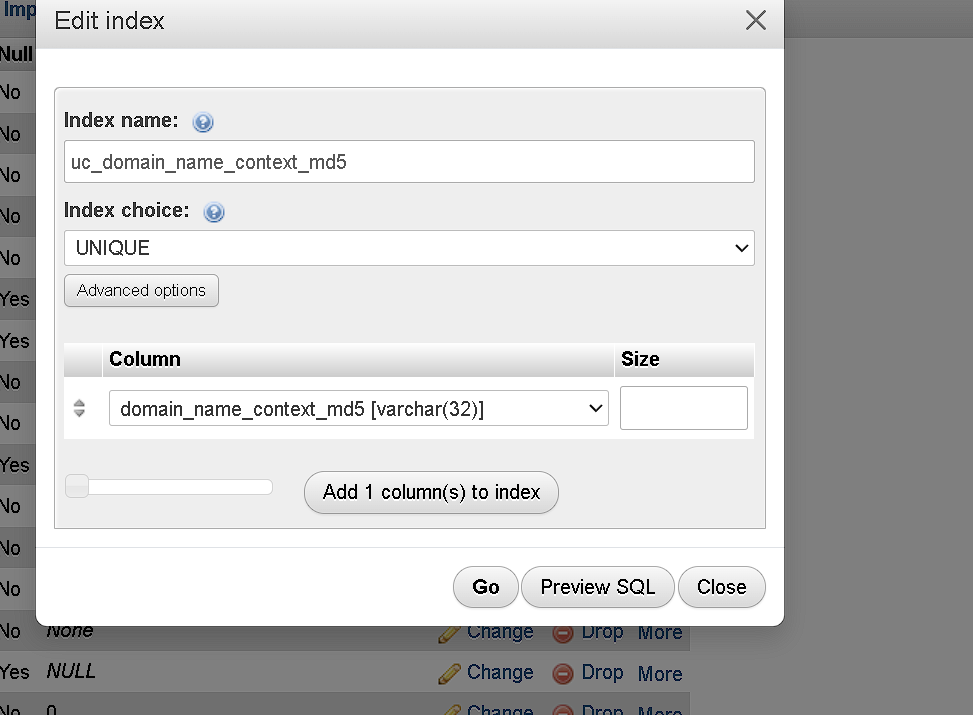

Also, please revise the index structure of the "icl_strings" table and check for the index: "domain_name_context_md5".
If the index exists, then you should be fine to go. If it is missing, then please let us know.

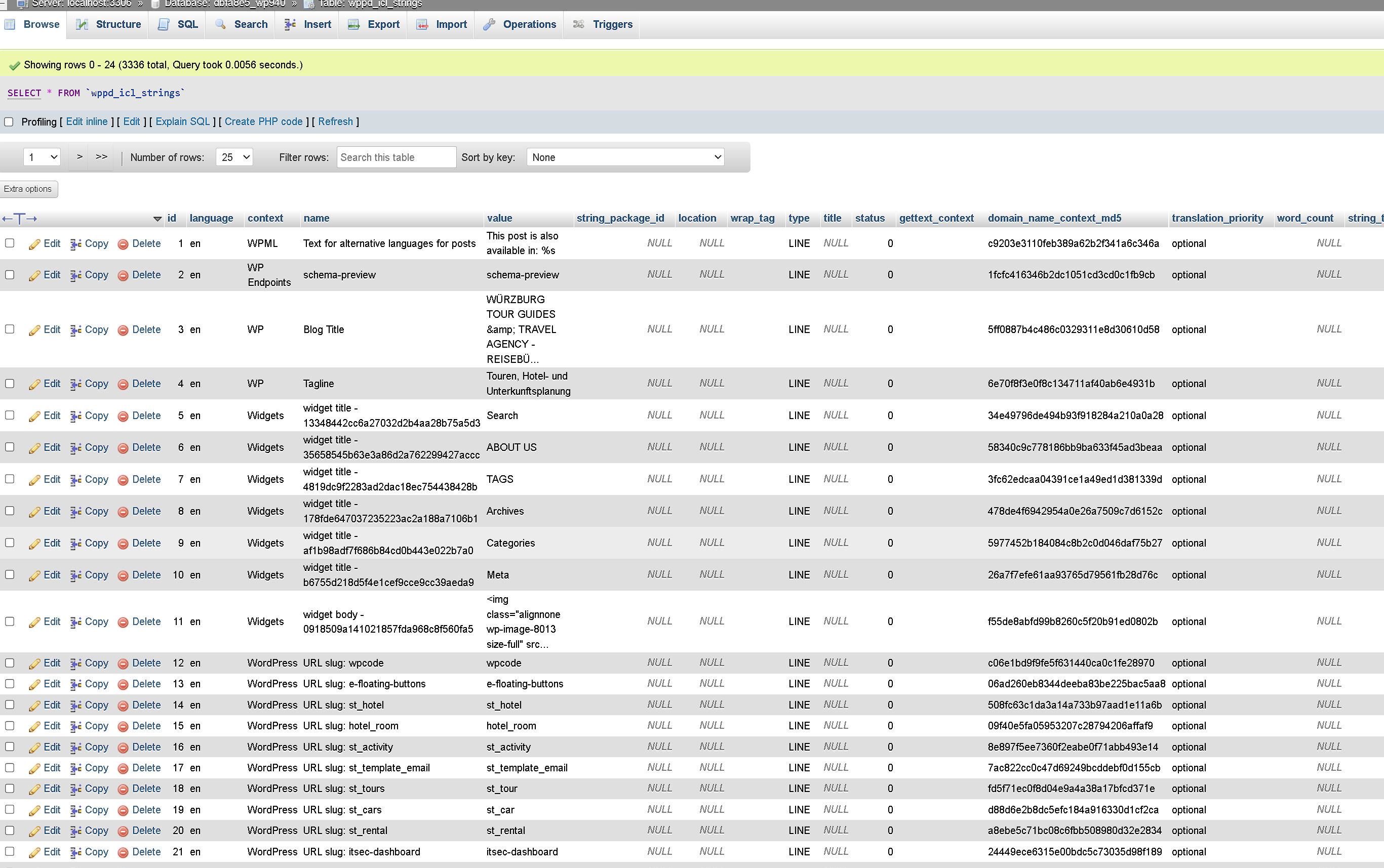

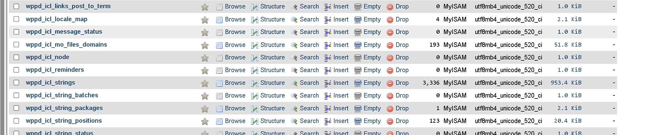

May 22, 2025 at 7:11 am #17059693
Swen Kleibrink
1. cleared messages
2. dbfa8e5_wp940.wppd_icl_strings exists
3. domain_name_context_md5 does not exisit but uc_domain_name_context_md5 does
I sent screenshots
