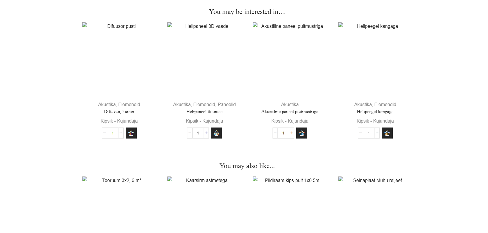

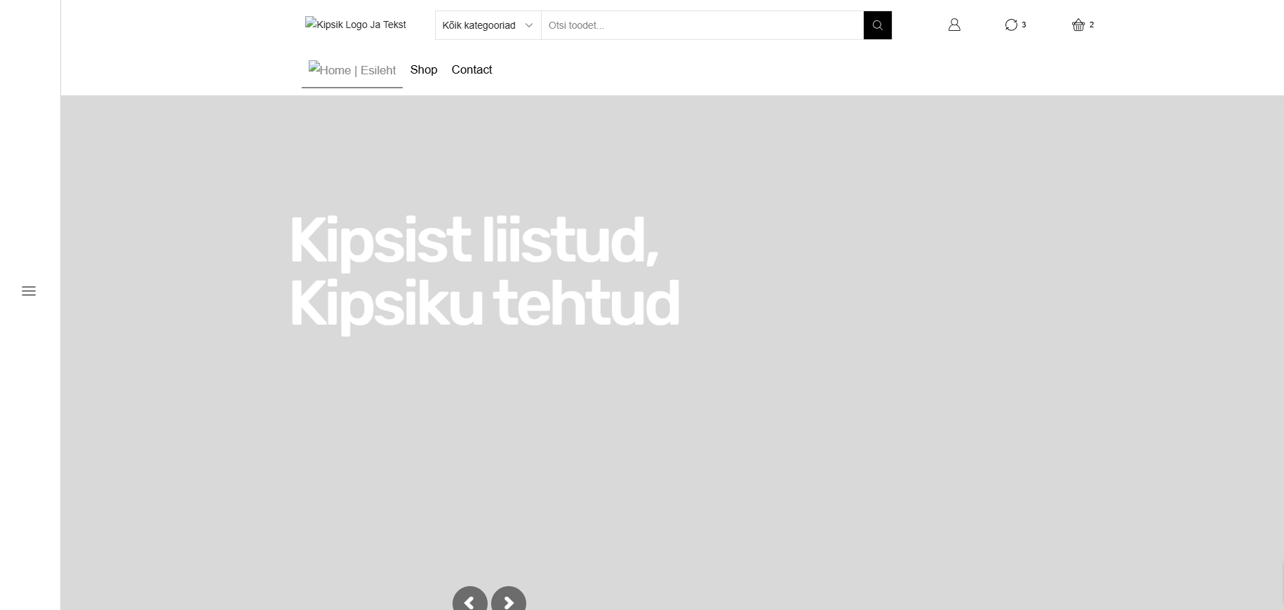

I added WPML and used the option to have different domains for different languages. The domains are all bought and connected as alias domains in web hosting.
<b>Symptoms: </b>
The translated domains do not show the images. I already tried running the duplication for media for different languages but the media is still missing.
<b>Questions: </b>
Why are images not showing on translated domains?
How can I ensure media duplication works for different languages?

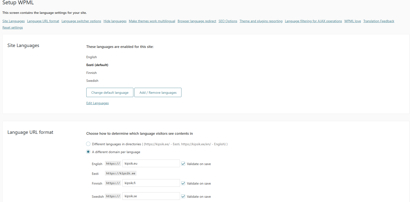

June 2, 2025 at 5:36 pm #17099116
martinK-154
In the settings I have it set on kipsik.ee like showed on the image.
The default language is set to the right one in wpml settings. Where does it show exactly that the urls are different?
