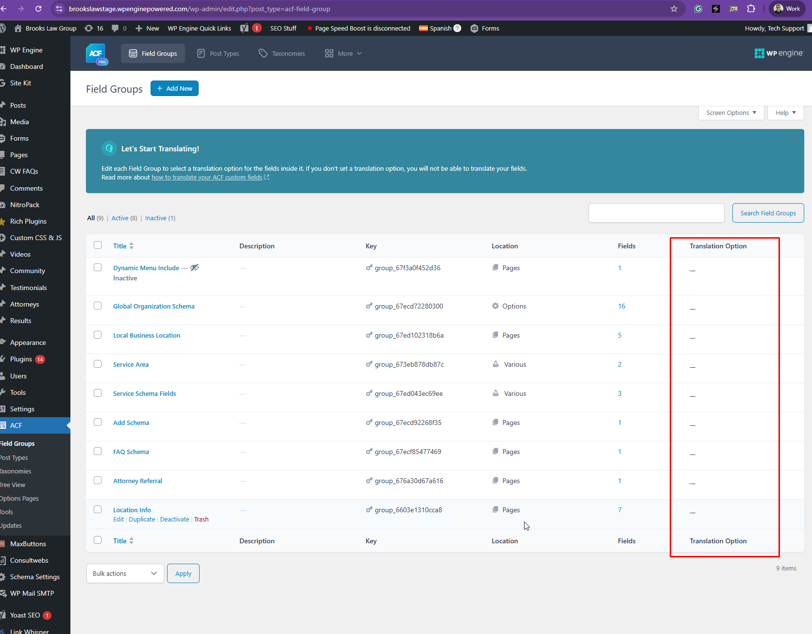

Thanks for your reply. I've checked your ACF settings and it looks like you've not enabled the "Translation Options" for your ACF fields here hidden link , as shown in the attached screenshot. Please refer to the instructions here https://wpml.org/documentation/related-projects/translate-sites-built-with-acf/

For this sites, they generated the acf fields to php so they are not in the interface, what are my options.

Thanks for your reply. You can refer to this section of the documentation https://wpml.org/documentation/related-projects/translate-sites-built-with-acf/setting-the-translation-preferences-for-acf-fields-created-using-php-code/
