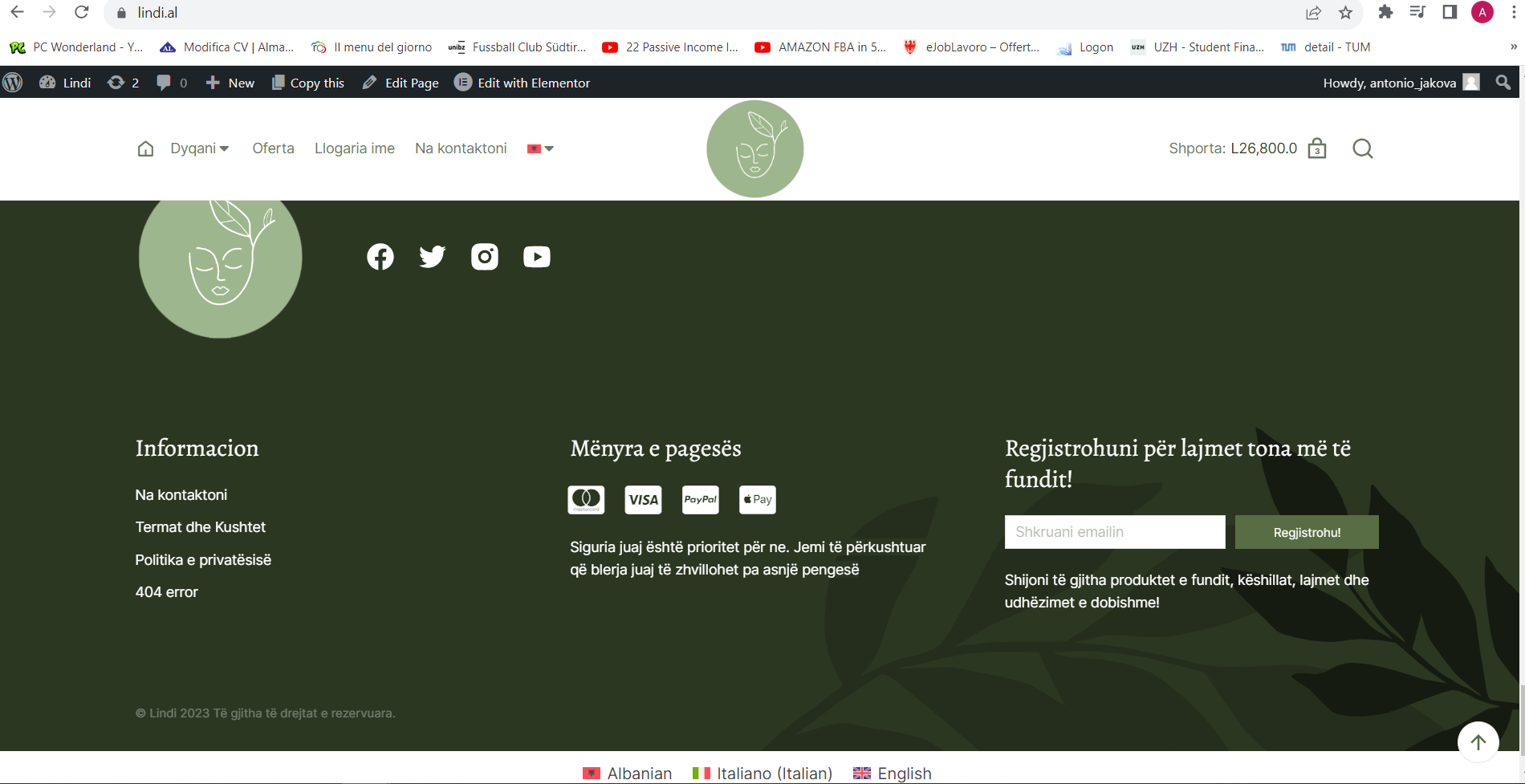

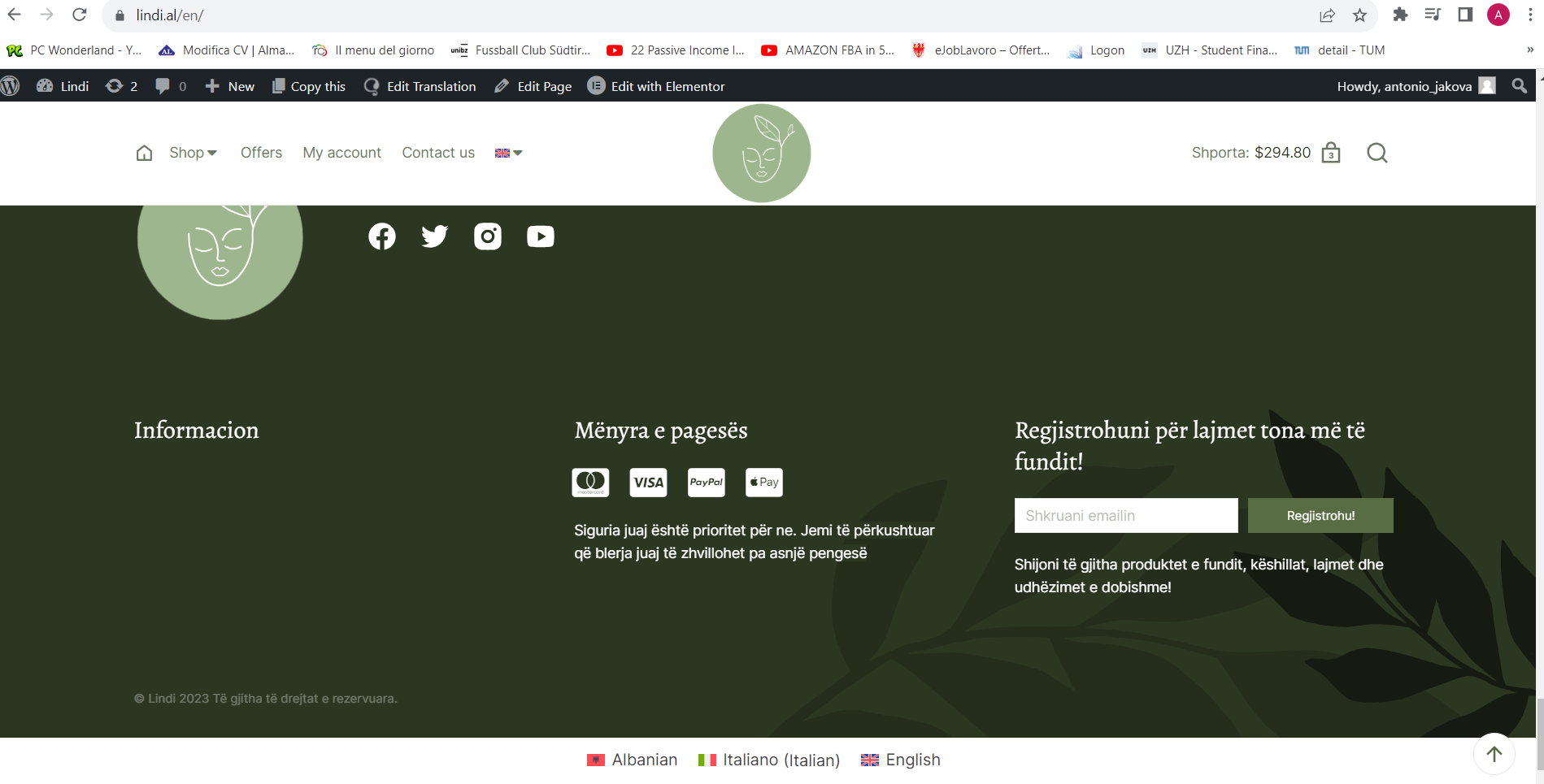

I've been diligently working on the translation of our website using WPML and have encountered an issue that I wanted to bring to your attention. While translating certain pages and templates, I noticed that the translations for the mini cart are not being applied consistently.
It appears that the root of the problem lies in the templates. Specifically, when translations are implemented for some pages, the mini-cart's translation does not reflect the changes.
Given the intricacy of the situation and to ensure a seamless experience for our users, I wanted to seek your advice on the best approach to resolve this issue. Do you have any recommendations on how we should proceed? Perhaps there's a specific procedure or step I may have missed in the translation process, or maybe there's a known compatibility issue that I'm not aware of.
Your insights and expertise on this matter would be greatly appreciated. I aim to ensure that our website provides a consistent and fluent multilingual experience for all visitors, and resolving this mini-cart translation issue is pivotal to that goal.
Thank you for your time and consideration. I look forward to hearing your suggestions and working closely with you to address this matter promptly.

Thank you for the details.

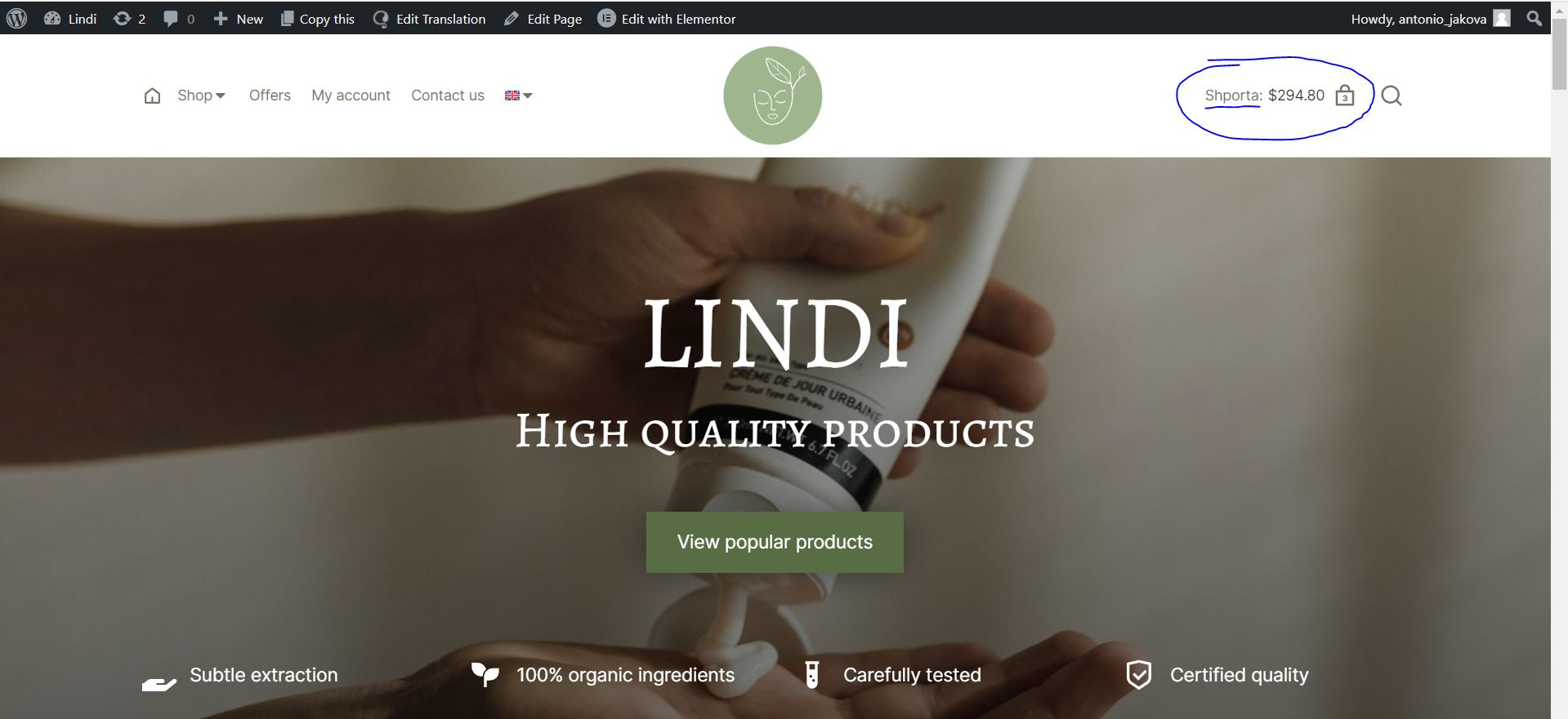

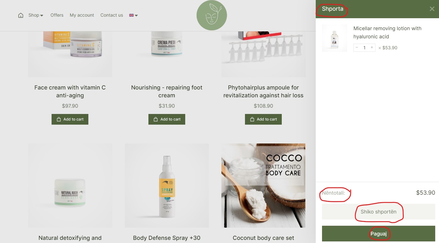

Please see attached and let me know if the red pen marked words are what you are referring to Mini Cart? I see these are not translated while checking English translation.
While in the cart (hidden link) I see strings translated correctly.

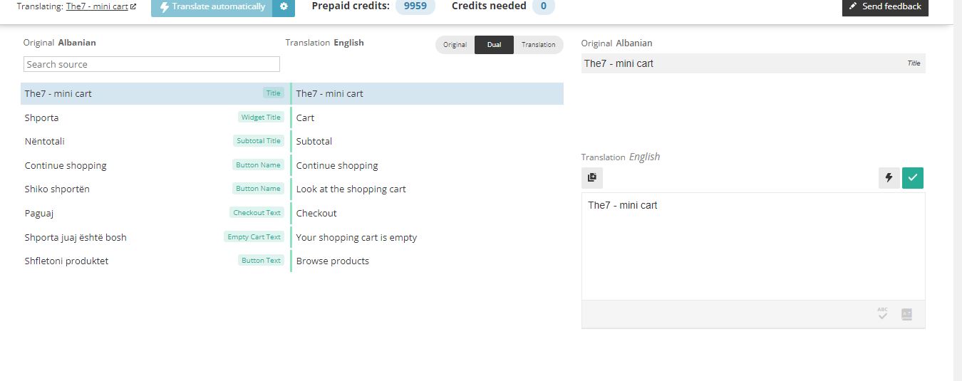

Can you find those strings in WPML -> String Translation and translate accordingly?
If not, please check this guide https://wpml.org/documentation/getting-started-guide/string-translation/finding-strings-that-dont-appear-on-the-string-translation-page/ and see if you can scan your theme and relevant plugins to bring these strings into String Translation?
Please let me know and I'll try my best to further assist you on the matter.

I hope this email finds you well. I am reaching out to report an issue I am encountering with the WPML String Translation, specifically in relation to the mini cart templates.
I have ensured that the strings on my end have been translated correctly, just as shown in the attached photo. I followed the standard procedure in the string translation section of WPML and translated the necessary strings.
Furthermore, I have also translated and saved templates related to the mini cart. However, despite these efforts, I am still experiencing problems (please specify the problem you're facing, e.g., "The translated strings aren’t appearing on the front end" or "The mini cart is displaying mixed languages").
I have tried the usual troubleshooting steps but to no avail. Can you please provide guidance on how to resolve this? I would greatly appreciate any insights or recommendations you might have.
Please find the mentioned photo attached to this email for your reference.

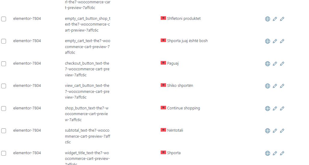

I just checked quickly and can see that headers, footers and all other areas are translated and visible on frontend correctly.
Besides this I also checked strings in Mini Cart, they are all available in ATE and ST as you've already translated the template (hidden link).

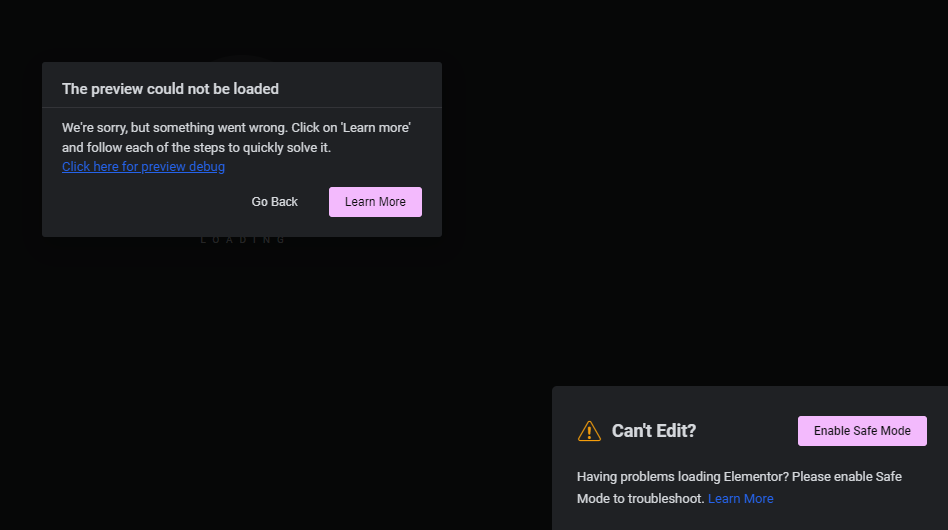

But when I try to edit this template, I am getting an error (see attached). Perhaps it's been corrupted. I'll advise to try the followings:
IMPORTANT: Take full backup of your website and database beforehand.
- Update your The7 theme to the latest version.
- Create a new template for Mini Cart, Translate and check. If this works fine then you should delete the corrupted one.
Please let me know if this helps. Or I'll have to try with minimal setup like deactivating all other plugins and checking with another theme. In this case, I can arrange a fresh sandbox site for you (if you haven't a staging site) to investigate on that. Please note that we are not allowed to make changes and investigate by this practice on a live site.

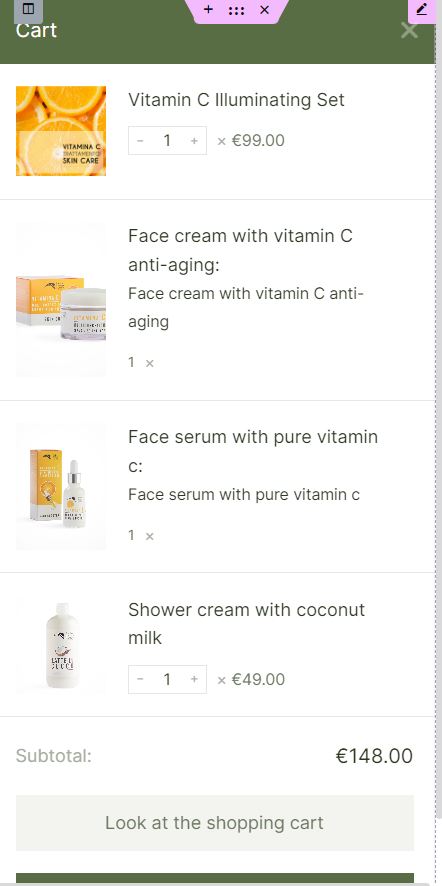

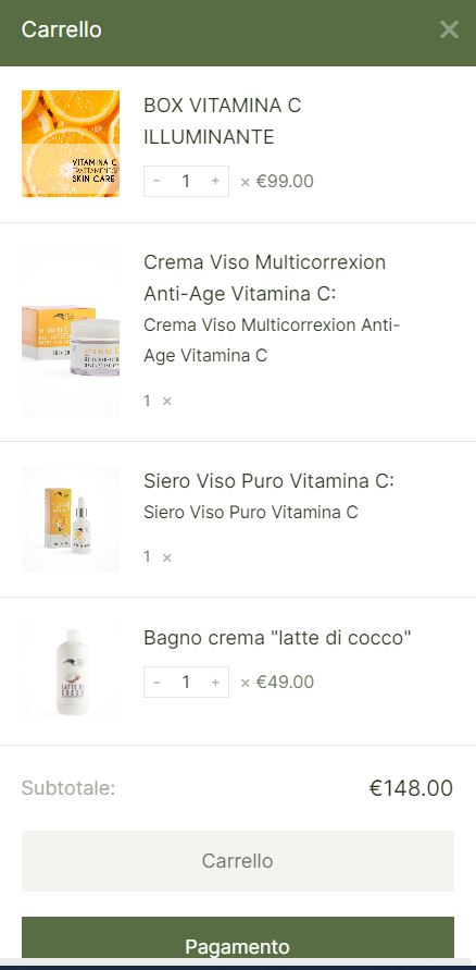

I wanted to bring to your attention an issue I'm facing with the mini-cart functionality on our website. To provide some context, I recently replaced the corrupted mini-cart file with the default one from WooCommerce in an effort to rectify some previous issues.
While the back-end displays that the content in the mini-cart is getting translated as expected, I'm observing a discrepancy in the front-end where the translations aren't reflecting. This is particularly puzzling since the back-end and front-end are not in sync regarding the translations.
I've cleared caches, verified theme and plugin compatibility, and checked for potential JavaScript conflicts that might be preventing the translated content from showing in the front-end, but to no avail.
Given the importance of ensuring a seamless experience for our multilingual users, I wanted to consult with you on the best way to proceed. Do you have any insights or suggestions on potential causes and solutions for this problem? Moreover, is there any specific log or additional data you'd require from me to further diagnose this issue?
I appreciate your assistance and expertise on this matter. Looking forward to your guidance so we can resolve this as soon as possible.

I've checked again and even 've registered that Mini Cart widget in WPML -> Settings -> Custom XML Config:
<wpml-config>
    <elementor-widgets>
        <widget name="the7-woocommerce-cart-preview">
            <fields>
                <field type="MiniCart: Title Text" editor_type="LINE">widget_title_text</field>
             		<field type="MiniCart: SubTotal Text" editor_type="LINE">subtotal_text</field>
              	<field type="MiniCart: ShopButton Text" editor_type="LINE">shop_button_text</field>
              	<field type="MiniCart: ShopButton URL" editor_type="LINK">shop_button_link>url</field>
              	<field type="MiniCart: ViewCart Button Text" editor_type="LINE">view_cart_button_text</field>
              	<field type="MiniCart: CheckoutButton Text" editor_type="LINE">checkout_button_text</field>
              	<field type="MiniCart: EmptyCart Text" editor_type="LINE">empty_cart_text</field>
              	<field type="MiniCart: EmptyCartButton Shop Text" editor_type="LINE">empty_cart_button_shop_text</field>
              	<field type="MiniCart: EmptyCartButton URL" editor_type="LINK">empty_cart_button_link>url</field>
            </fields>
        </widget>
    </elementor-widgets>
</wpml-config>
by following this guide https://wpml.org/documentation/support/language-configuration-files/how-to-register-page-builder-widgets-for-translation/.
All of the text fields and URLs appear in ATE and are translated correctly.
But unfortunately there seems to be the problem with the plugin "PRO Elements" for the frontend display. This plugin isn't on our compatibility list (https://wpml.org/plugin/?wpv_view_count=120064&wpv-plugin-functionality=0&wpv_post_search=PRO+Elements&wpv-wpcf-recommendation-flag=&wpv_filter_submit=Search) and is a derivative work from the Elementor Pro and lacks proper support.
I'll advise to do the following:
- Update your theme to the latest version. I tried but it failed. And then check again if it solves the problem.
- If it doesn't then either use Elementor Pro or contact the plugin author to resolve the issue.
In short, this isn't a problem with the WPML, but is with the unsupported/incompatible plugin.
