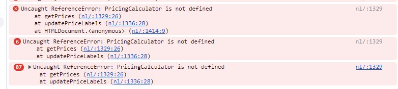

see screenshot for the error I'm getting for the languange dutch (nl). It looks like that WPML does not reload the script with the functions when I change the language (DOM related ?)
